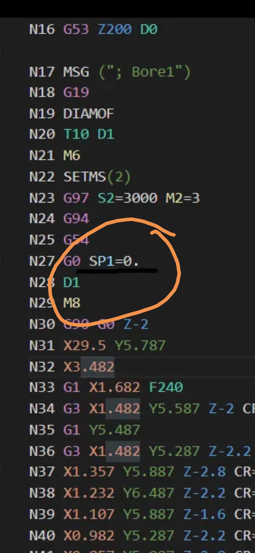

Hello guys
Im using fusion 360 for cam from a while.
Evrything is perfect in 3 axis mill and 2 axis lathe, but i have i little problem when im using live tools in lathe. Im using Siemens Mill Turn post wich generate perfect code for my machine except the one code C axis orientation. Fusion gives me sp1= instead of C. Is there someone who can guide me how to edit my post?
 ![Screenshot_20220116_204452](https://canada1.discourse-cdn.com/flex035/uploads/titansofcnc/original/2X/f/fa1072d78308594dfe2465b08e56e895d9832a54.jpeg)

I am not familiar with the Siemens controls, should there also be a spindle lock in addition to the positioning? You can edit in Notepad ++. Always copy and edit your copied post processor. Here is a good tutorial for simple editing. [Beginners Guide to Editing Post Processors in Fusion 360! FF121 - YouTube](https://www.youtube.com/watch?v=5EodQIY25tU)

I dont need to lock spindle, its for orientation a “C” axis for milling with live tools. Already watch this video but still cant find out how to edit post correctly. I Just need to edit my post to post code with “C” instead of sp1=
