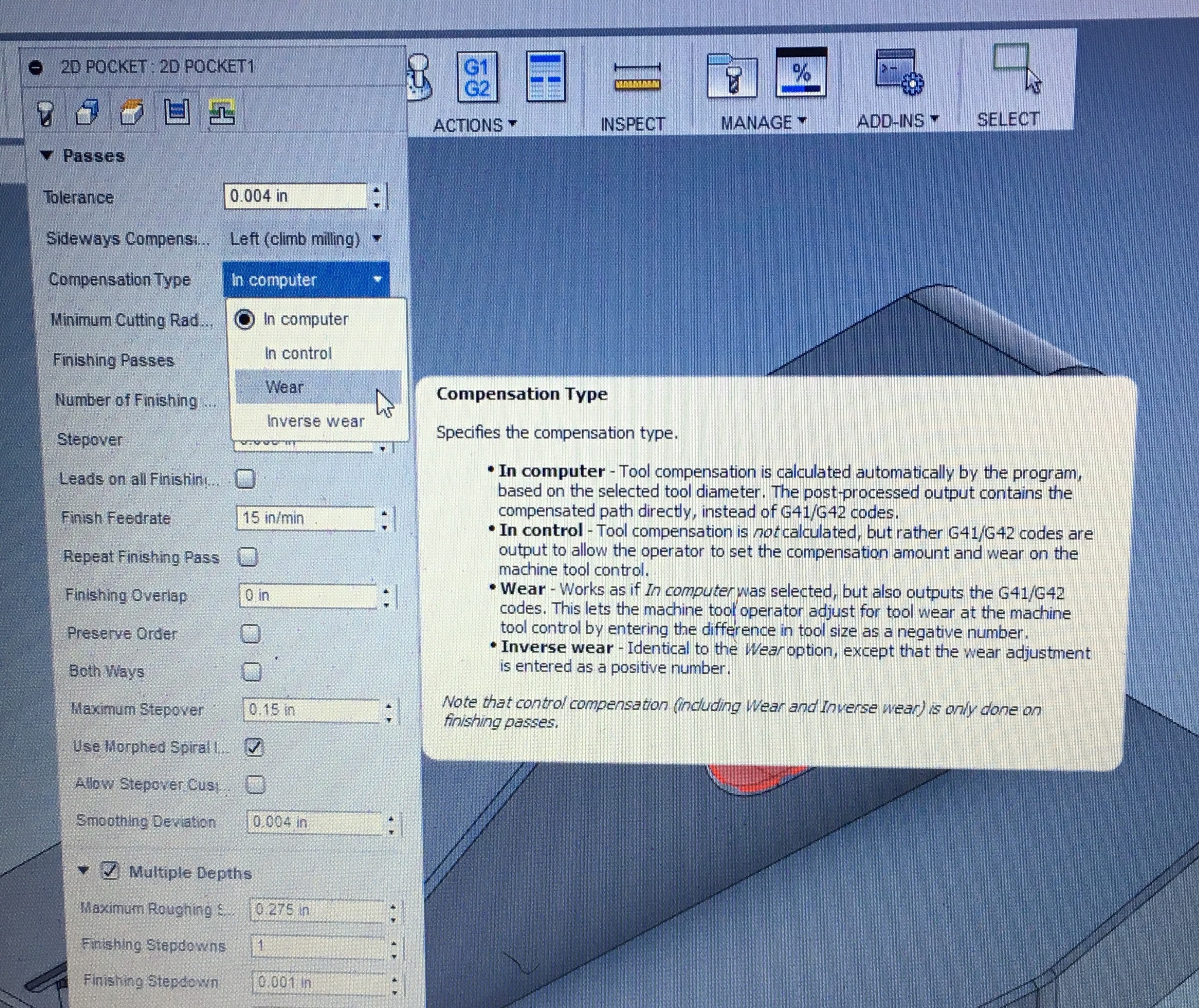

I have watched a lot of Titan’s building block cam videos and have not found and details describing how the Wear Compensation in Fusion 360 works, Titan just says “that’s what we do”. I’m having a hard time wrapping my head around the concept and how to implement it. If any one can shed for light on this or post a link I would be grateful

Lets see if this helps - when you create toolpaths in Fusion, Fusion has to do the math to take into account the size of your cutter and then it offsets the gcode accordingly. Your machine only needs to run the gcode that was put out directly from Fusion. So the toolpath is 1,000% fixed - your end mill will never be able to move from this programmed path.
So what happens if after you run your part you find it’s running .002” out of size? There are so many reasons why this can and does happen - but you need perfection and need to fix this. But with no method to change the toolpath by that .002” to get the part perfect - how do you do it? Well you could redesign the part a little smaller and re-cam it, you could adjust your radial stock to leave and re-cam it. But this is a pain and not the right way to do it…
This is where using wear compensation comes in - wear compensation exists on your cnc machine controls in the tool setup area. As a tool wears, you can tell the control that that tool has worn by .xxx” and the machine control will then adjust all the tool paths by that amount.
Now picture your part is coming out too big as mentioned above - if you are using wear compensation. then you can just go into the tool setup page and enter a wear compensation number for that tool, and the control will adjust the toolpath automatically and move the tool either closer or further away from your part. Using this method you can dial in your finished part dimension. Easier than reprograming everything right?
BUT - in order to use the wear compensation you have to select use tool wear in fusion under”compensation type” on you finish passes. This will tell fusion to put the appropriate Gcode and Tool Wear Dimension call at the begining of code that is now going to be impacted by any tool wear dimmension you place into tool wear for the given tool.
So now you have an easy method to dial in the finished dimmensions of your part…

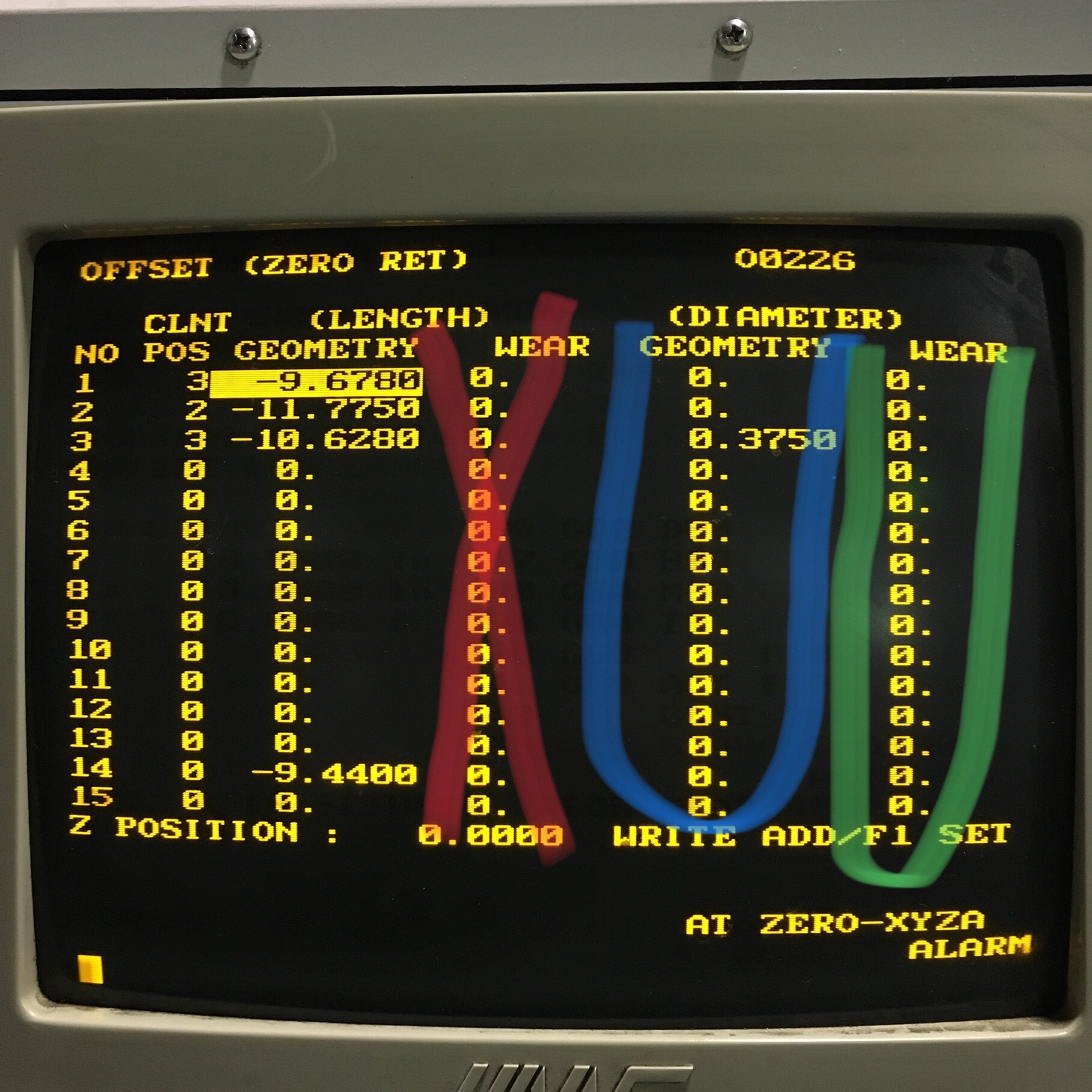

Take a look at this - This is something we are running now, It’s an older Haas VF2.
Blue = your normal cutter comp input area
Green = This is where you would input just the incremental wear adjustment.
Red = Don’t input here because this is for wear in the “Z” axis not your Diameter in X,Y
Note: This job is programmed by hand and I’m using cutter comp on Tool #3 so it needs the Diameter input here. I’m not using Tool wear for that tool, as these parts do not require that level of precision for the features being made.

By selecting “Wear” as your compensation type in Fusion - it only tells Fusion to include a G41/G42 in the right spot of your code. The X,Y of the code Fusion kicks out will already be adjusted for your tool diameter. So in your control you would not have to enter anything in tool diameter. Because Fusion will automatically adjust your X,Y’s for the tool diameter(cutter comp) - but It is also still going to stick in the G41/G42 at the right spots of your code. This will make your Control look for and use a Diameter offset if one is input @ the machine - If you input any number in your tool diameter at the control this is going to end up being in ADDITION to your tool diameter which you already have taken care of in the Fusion code. So anything you enter in Tool Diameter in your machine will now act like a wear adjustment only.
Run your first article with tool diameter left blank - then measure your FA and then input JUST the adjustment amount in the Tool Diameter.
Controls that have “Tool Diameter” and “Wear” settings are only adding the two numbers together and then using the combined number to perform the G41/G42 offset.

With all of that - the descriptions of what you can pick for compensation type - should start to make more sense.
