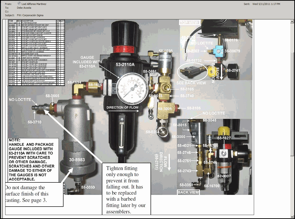

I just balanced the table and connected the electrical and went to attach air and the whole Air Control System is Missing. Also there is a part missing that controls the oil to the spindle. The oil pressure gauge hooks into it.
Please Help Identify parts and suggest where to aquire them!

I recommend contacting your local sales rep. They should he willing by to help. Were did you get it? I would send it back.
A donation from Humboldt State University. Someone did not like the Church getting the machine and sabotaged it…
It was working before Christmas but I could not extract it from the lab till after the New Year and this happened to it.
:smiley:Thank God! The air control system has been located and we should have it shortly!!:grinning:
