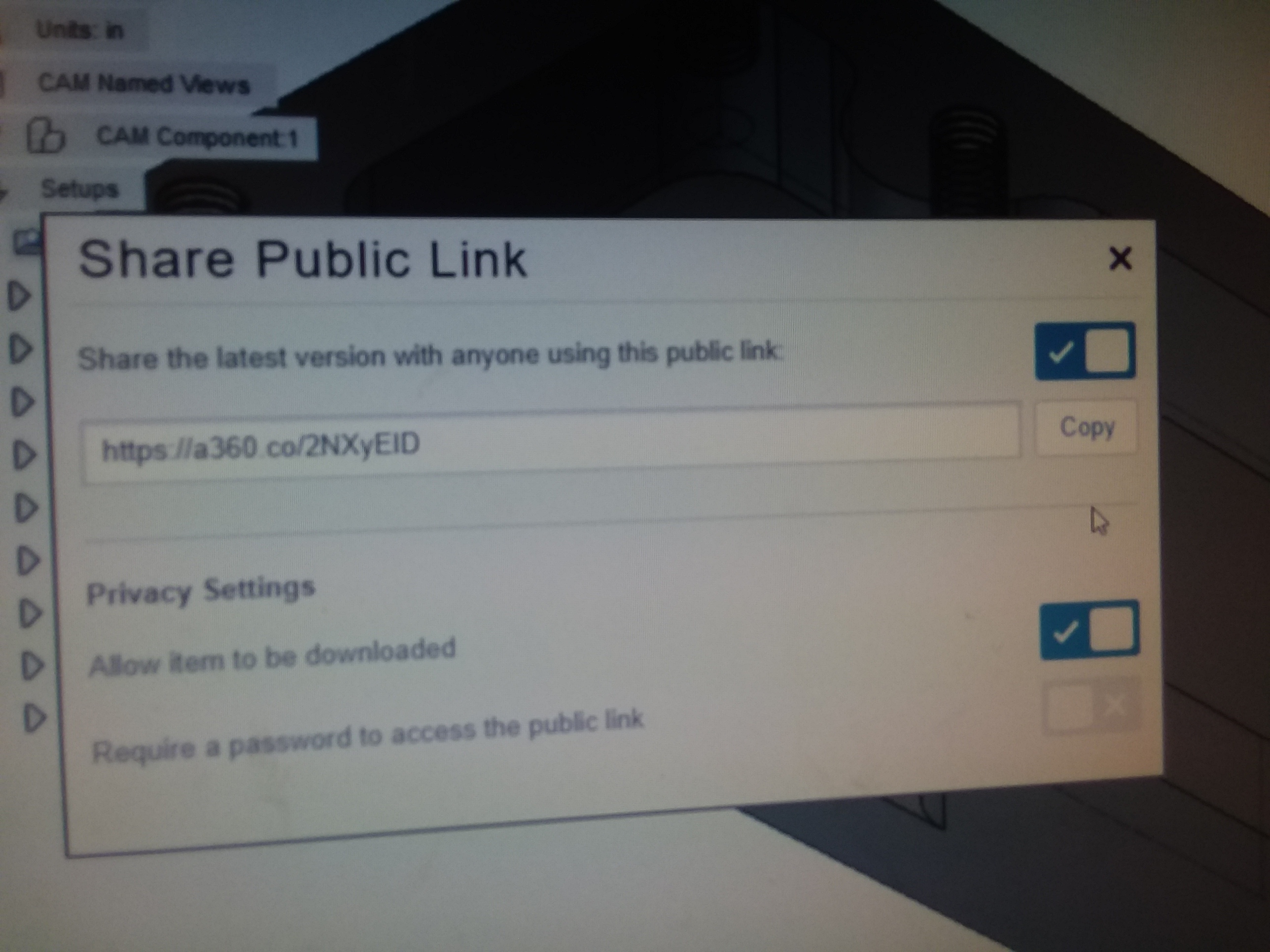

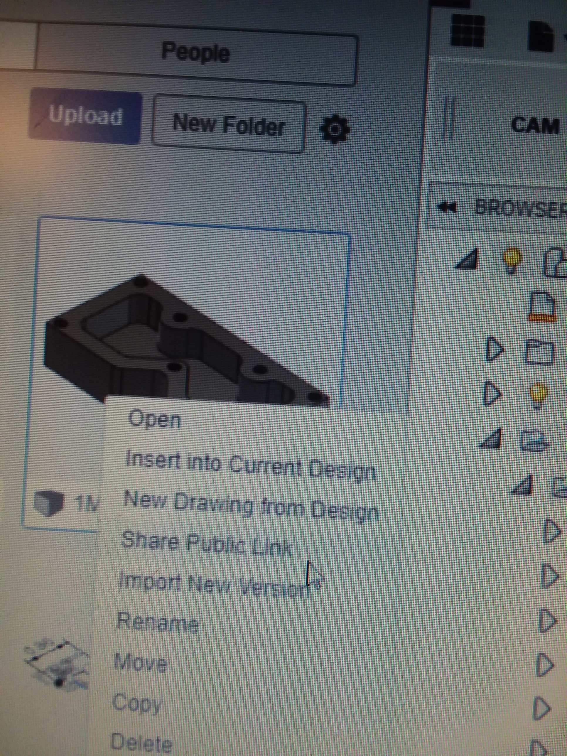

@RobThurlow
For some reason your link is not working is there way you can share your part file. If you right-click on the thumbnail of your part the screen pops up and then you left Click Share public link then you copy the link and you can paste it in the Forum where we can take a look at it and try to help.
[https://a360.co/2NXyEID](https://a360.co/2NXyEID)
This is a link to mine you can open it and look at it but do not change anything.

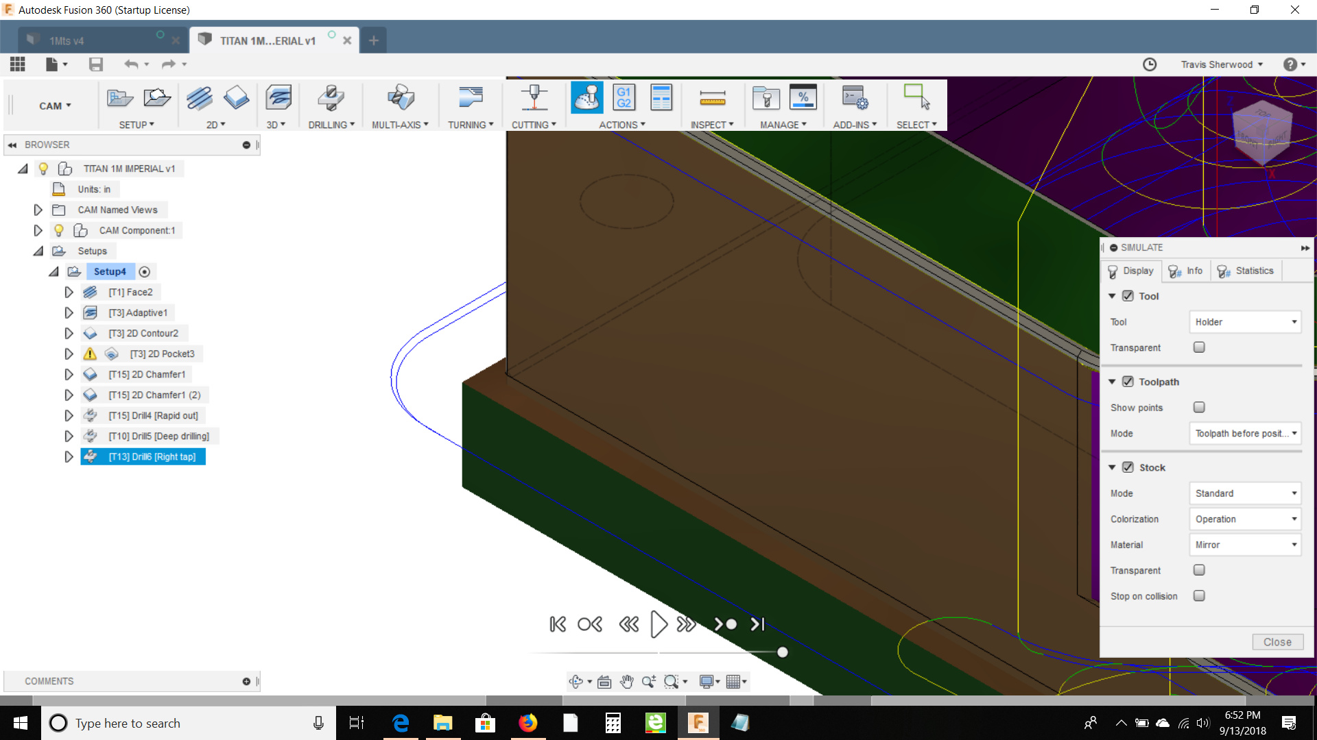

@RobThurlow
I an not seeing the issue you are talking about. I ran a simulation of your part and it roughed the outside of it once and finished it once.
I do see that there are some things you might have missed, I recommend you watch the video and cam it again. I had to watch it paws it and rewind it and watch it again over and over and over to get it right. You have to get every thing right fore it to work perfectly.
Sorry my help is not the best. if you can download mine take a screen shot of each step and compare it to your yours it might help.
if you change mine any it will not effect the one on my pc. If you need to you can down load it again.
Do you have the Face Book group if you do not get it going you might ask in there as there are some really expert camers in there. ![Screenshot%20(143)](https://cdck-file-uploads-canada1.s3.dualstack.ca-central-1.amazonaws.com/flex035/uploads/titansofcnc/original/1X/9cc159949763f32c8a96247b8f9e963419e37828.jpeg) ?

@Rumpelstiltskin thanks for the help, I was looking at yours and you had the lead in radius greater than mine, I altered mine and it seemed to do the trick!
Thanks again!
