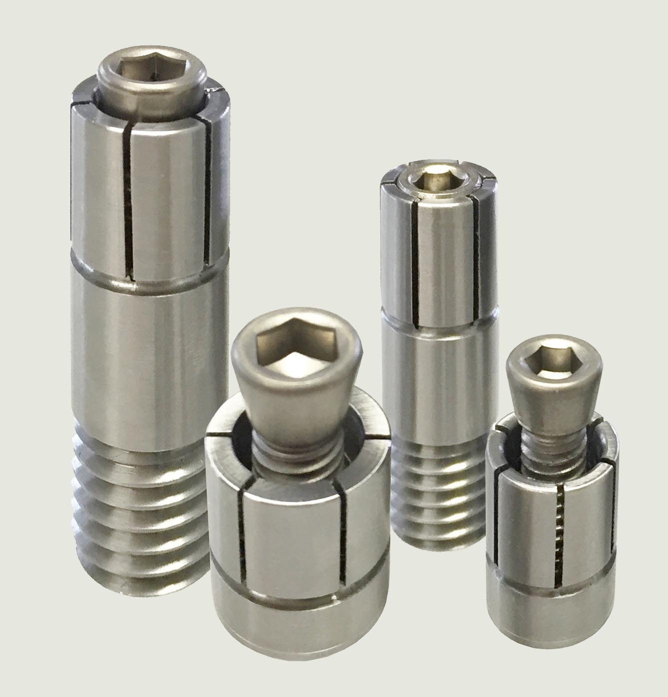

Good day to the hive! I need a little help with my soft jaws for holding this piece when flipping over for op2. I had cut a pair of soft jaws and everything was going fine until my 1/2" 3FL end mill was on the 2D contour towards the bottom right side walking around the part. The part pulled up and I snapped my tool. I checked everything out, setup a new tool but this time I decided to go with a smaller tool and less woc/doc and my jaw was no good because the part started to lift in the same area.
What strategies are you all using for work holding on the 7M?

Did you get the answer you needed in the FaceBook group page? Part # 31640
> **[Modular XYZ Xpansion® Pins | Mitee-Bite Products LLC.](https://www.miteebite.com/products/modular-xyz-xpansion-pins-2/)**

I never did see a part number but someone did mention they would get the number when they returned from the holiday vacation time. I also called Mitee Bite yesterday and was given the part number. I also decided to try something a little bit different. In F360 I edited my sketch shifting the jaws a bit to where the right side of the part has an open area. The jaws are 1/2" apart and I machined another smaller piece of stock to 1/2" x .66 tall that will sit on my parallels to provide the clamping force that is needed. I ran a trial run on the trashed piece and it seems to be holding fine.
Thanks again for the input and part numbers. Now I just need to find a vendor for the clamps.

I was the one that was going to get back with you. You can buy the clamps from MSC, but if you are only doing one to complete the tutorials, it will set you back about $100 for 4 clamps. We will make about 90 2nd op 7M runs per year minimum, so the fixture was a cost savings and provided my students with an alternate clamping method. Here is the part number in MSC. [https://www.mscdirect.com/product/details/35250257](https://www.mscdirect.com/product/details/35250257)
