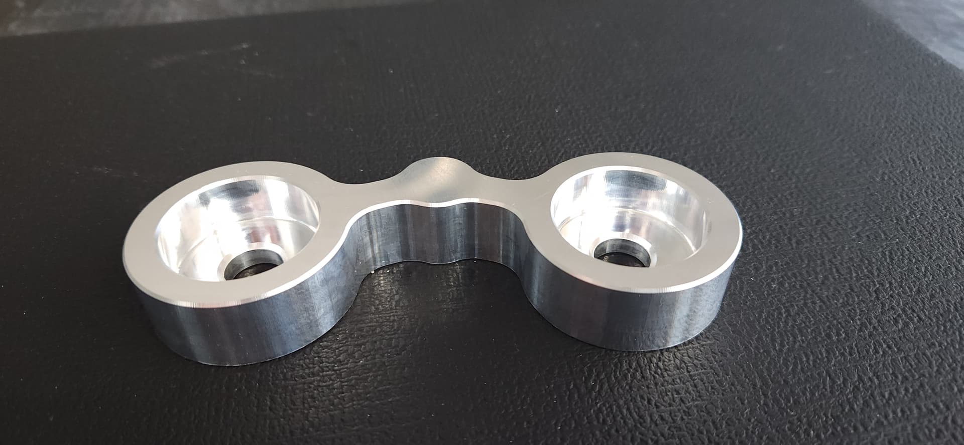

Hello Stephen,
I think I confused myself here a bit. I did machine soft jaws and machined the Titan 8M (see image). Here is what I did.
1. I established my part zero location (G54) and machined the top of the Titan 8M from the stock.
2. I screwed the 2 x 1 x 6 soft jaw material in the vise. I established a new part zero location for the soft jaws. This part zero location was in the center of the top surface of the soft jaws. I then machined the profile of the part into the top of the softjaws .300 deep.
3. I put the part into the soft jaws and established a new part zero location (center of the part and .230 below the top of the stock) and then used the face mill to machine off the excess .230 material.
Here is the Fusion file for clarity:
> **[Titan 8M v98.f3d](https://www.dropbox.com/s/ob5yshvh2dafnpu/Titan%208M%20v98.f3d?dl=0)**
> Shared with Dropbox
At this point if I try to chamfer the bottom leading edge of the part, it will not register with the model because the stock that I started with had rough cut edges and I have nothing to reference from. What am I missing here?
Should I have used the SAME part zero position that I used to machine the soft jaws and created the toolpaths with this part zero position to face and chamfer the part?

 ![20230228_110044](https://canada1.discourse-cdn.com/flex035/uploads/titansofcnc/original/2X/a/a2bdce4e1da8ec52fbdc41a580f33a6a7990409e.jpeg)

**Post date:** [February 28, 2023, 7:50pm UTC](https://titansforum.titansofcnc.com/t/titan-7m-second-side/12686/13 "2023-02-28T19:50:39Z")
</div>
You are almost there. Use the same XY work offset for fixture zero for your model… Change the Z for that offset from bottom of soft jaw profile +.750. Make sure you change your 2nd Fusion op to be center of part top of part. On your stock profile in setup, add +.230" to top of model.

Stephen… Thanks for all your input! I think the confusion here is that I did not actually model the soft jaws for the Titan 8M. I used the same approach that Titan did for the Titan 3M using the profile of the part to machine the soft jaws.
If you don’t mind looking at the tool path “Face II” in the Fusion file below, I went back and used this same setup for machining the soft jaws as the final setup to finish the second side of the Titan 8M. Please let me know if this looks good as I did not save the G54 position to be able to test it. While I think this approach will work, it may not be the best.

@RichardSalzman The stock size for your 2nd Op for Z+ should be .230 not .750. You faced to model top, you need to face using multiple depths, I usually set mine to .075" per pass. You used G54 for your work offset, that is okay, I usually use something other than G54 for all 2nd Ops. If you clamp the finished 1st op between vise jaws, you could split the distance between jaws to set your Y zero. To get the X zero, a hard stop on LH of part, then add +2.725 from hard stop. This will place your program zero as per the file you attached.
