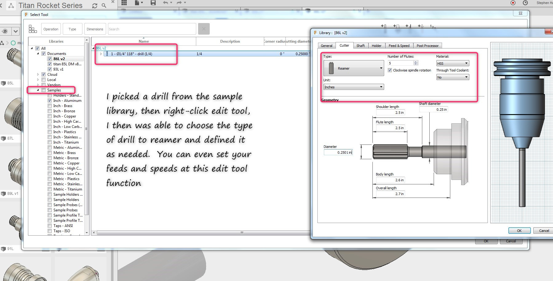

There is quite a few but i didn’t see reamers in the tool library.

You may have to pick a drill and then redefine it as a reamer. You should have a local library installed when you installed Fusion 360. See image.

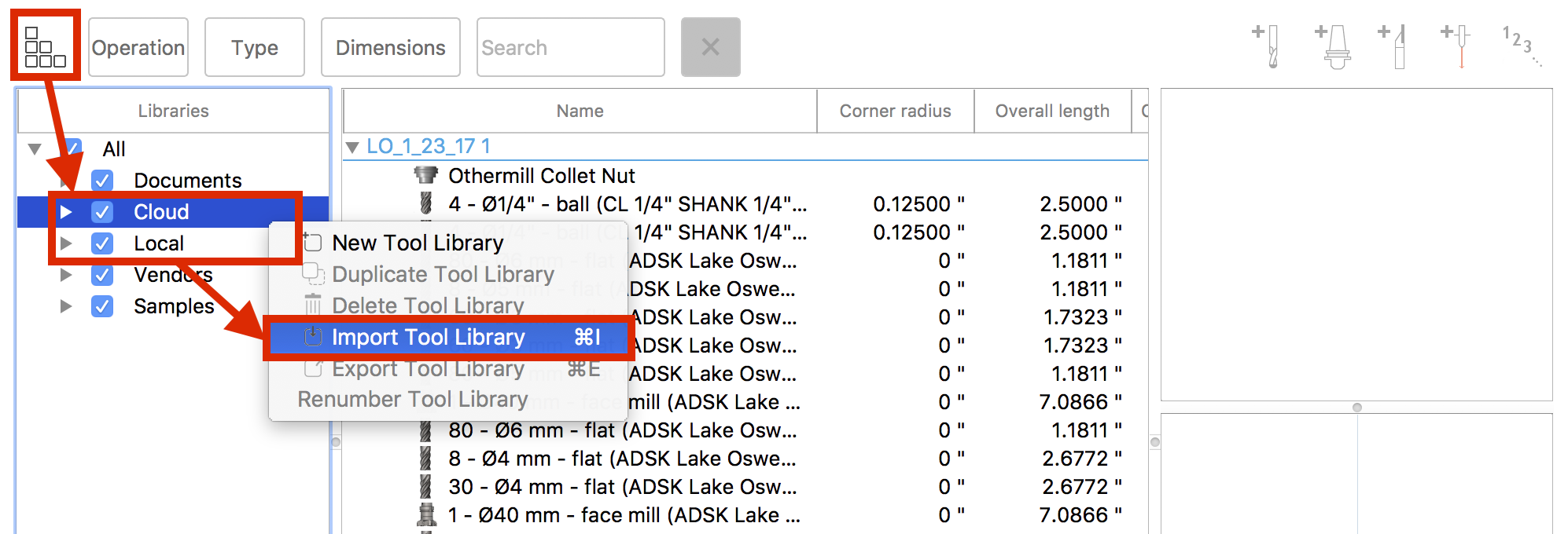

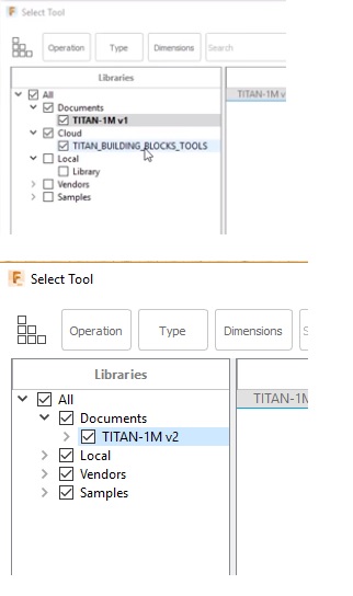

Ok, I’m just starting out on the Building Block Series, Titan-1M. The video says to download the tool library. How do I do that? I assume it has to go into a specific folder? I’m my Tool Selection widow doesn’t have a “Cloud” option. How do I activate that? This is a screenshot of the video and my Select Tool window.

Make sure you download the Titan Tool Library file first. You can find this in the Related Files area on the How to Draw the TITAN-1M tutorial page.
![Files](https://cdck-file-uploads-canada1.s3.dualstack.ca-central-1.amazonaws.com/flex035/uploads/titansofcnc/original/1X/d350d223670378017d9db9765a0391509fb5061a.JPG)
Inside of Fusion on the top ribbon is a Manage tab. Hit the drop down list for Manage Library, then follow image below. Don’t worry about Cloud services for now, just load the library using LOCAL which is your computer.
![Library](https://cdck-file-uploads-canada1.s3.dualstack.ca-central-1.amazonaws.com/flex035/uploads/titansofcnc/original/1X/a49148b881a70375ff181f4a419507e89dca4a3f.png)

Thanks Bill! Your instructions worked like a charm. I’ve uploaded the tool list into my CAM file. I’m new to Fusion 360 so I am still learning my way around the Fusion 360 windows, drop-down menus, and commands.

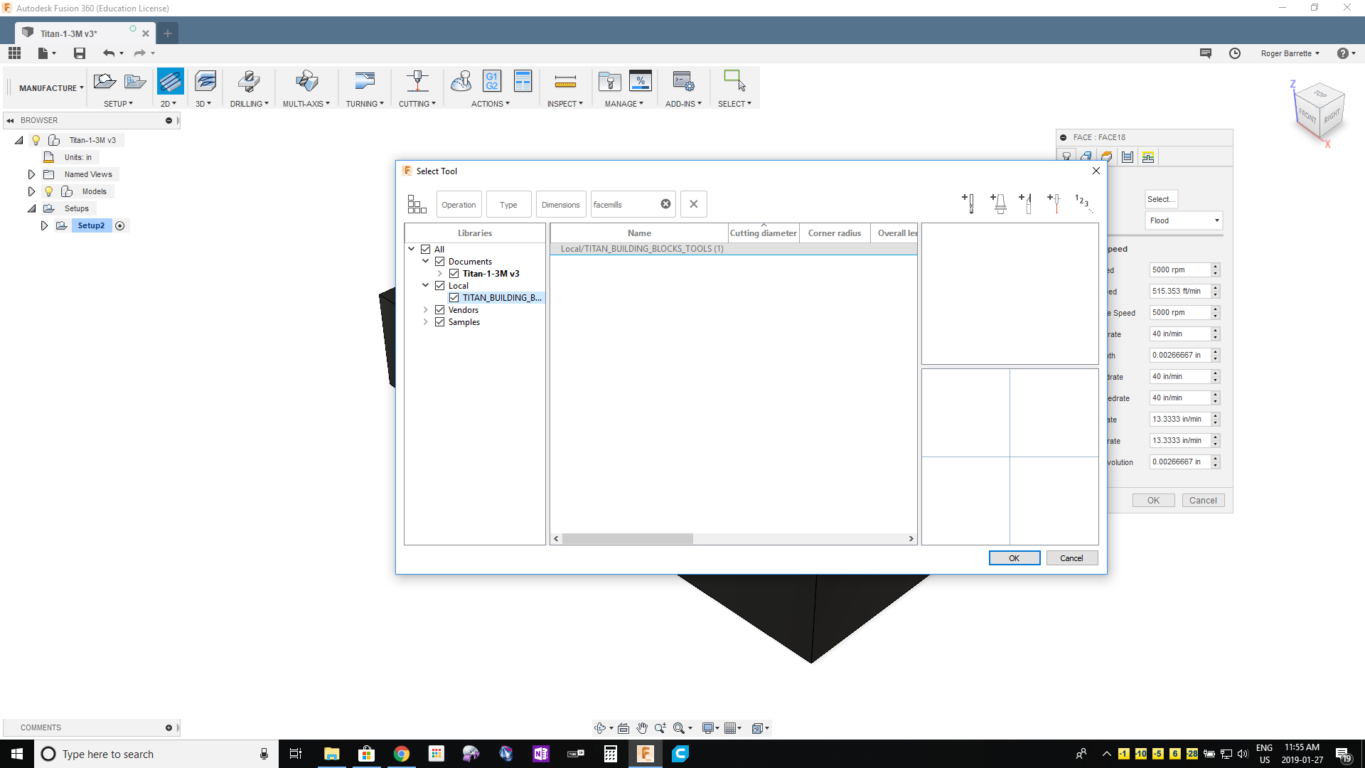

I have the same problem, trying to download the Library but it shows up a greyed out line. I am running the Educational License if that helps ![image](https://cdck-file-uploads-canada1.s3.dualstack.ca-central-1.amazonaws.com/flex035/uploads/titansofcnc/original/1X/2f9301c3545a703a8206d6b9a7c00c3be838b509.png)
This is what I get after uploading the Tool Library
