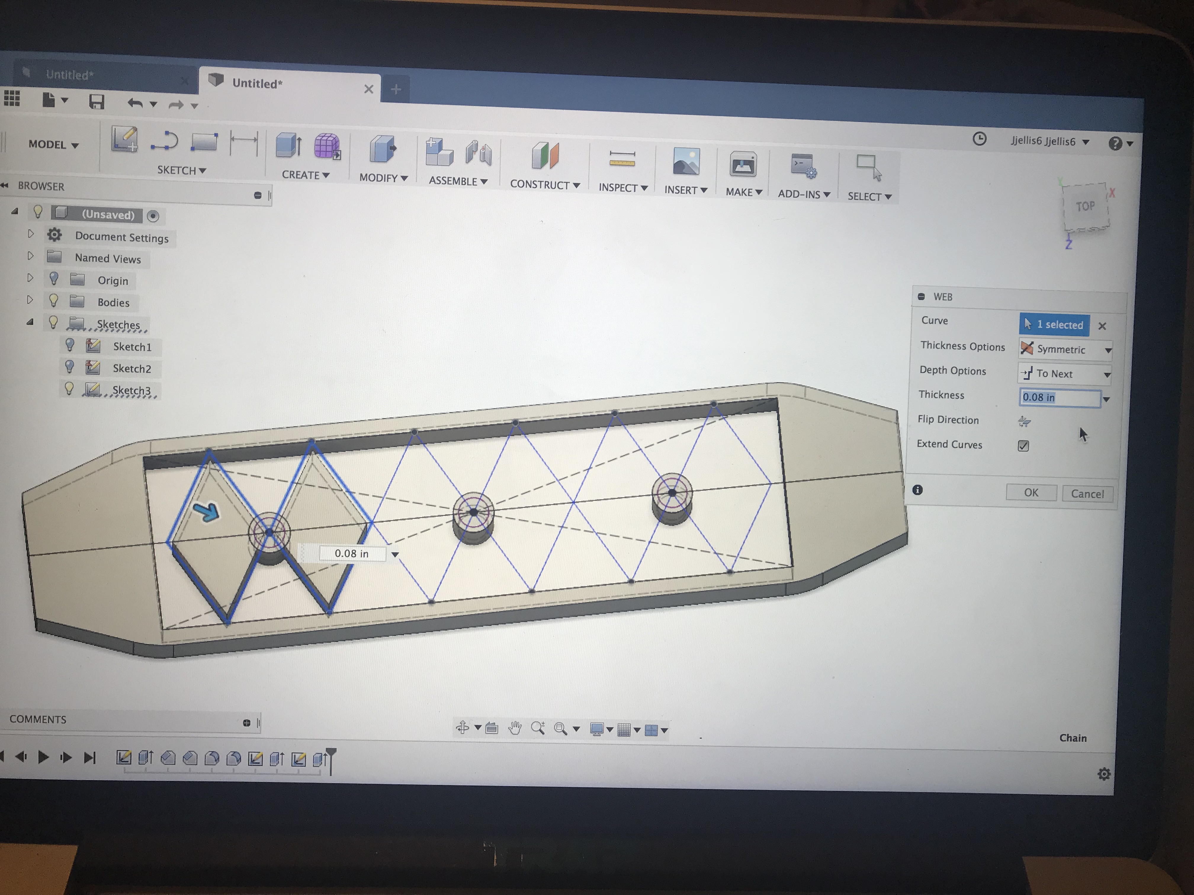

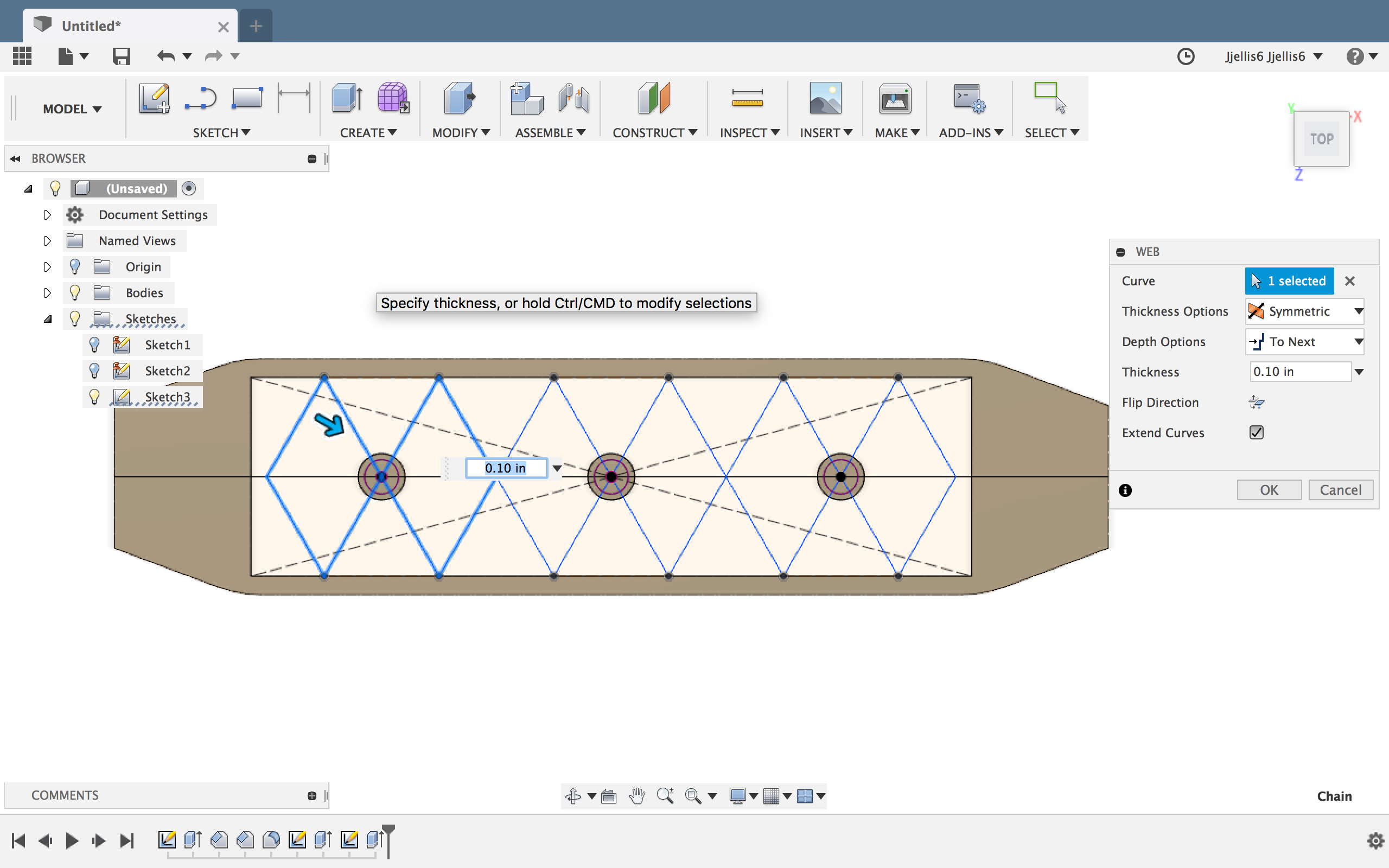

Hi, during sketch 3 around 10 minute mark of the video I am having problems making the web correctly. I followed along connecting the lines to the inside of the polygon,06%20PM but when i go to web and try to select the lines in the order you did in the video it doesn’t have the same outcome. It is selecting the entire poly and not the appropriate lines. how do i fix this? I’ve tried making the lines one by one and then separate webs but can’t find a solution.

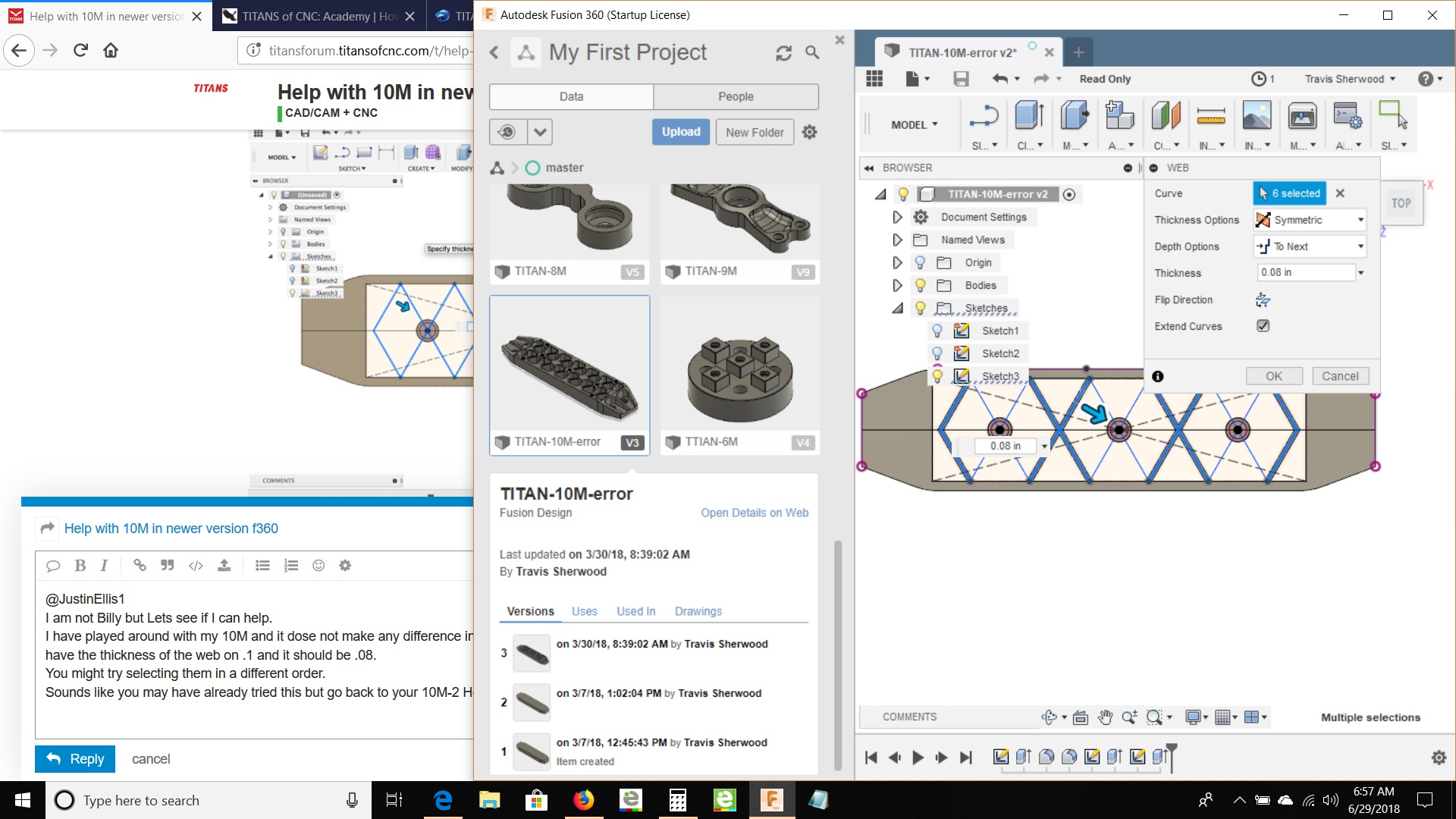

I am not Billy but Lets see if I can help.
I have played around with my 10M and it dose not make any difference in the order of selection.but I do see you have the thickness of the web on .1 and it should be .08.
You might try selecting them in a different order.
Sounds like you may have already tried this but go back to your 10M-2 Hopefully you saved it at this point.If you click on the V2 in the bottom right corner of your preview it opens up a window showing your different saved versions you can double click the version 2 and it will open. Start at this point and follow Billy’s instructions again and see if it works better for you.

My students had some difficulty creating the web. We found that they inadvertently created overlapping sketches when creating the polygons. If you find the web feature tries to create partial profiles, you might clear your geometry again and be very careful when creating lines to points that you do not overlap.

I appreciate your help. Unfortunately after trying both recommendations i still encounter the same problem. I started the video over from the beginning and made sure to make all the exact moves as did billy and when i get to the web part with the thickness at .08 it does not make a web along that outside polygon path. it instead wants to fill the diamond shapes. Im not sure how to trouble shoot this so i can continue the part. Thank you guys again though. @Rumpelstiltskin @StephenHadwin IMG_0003

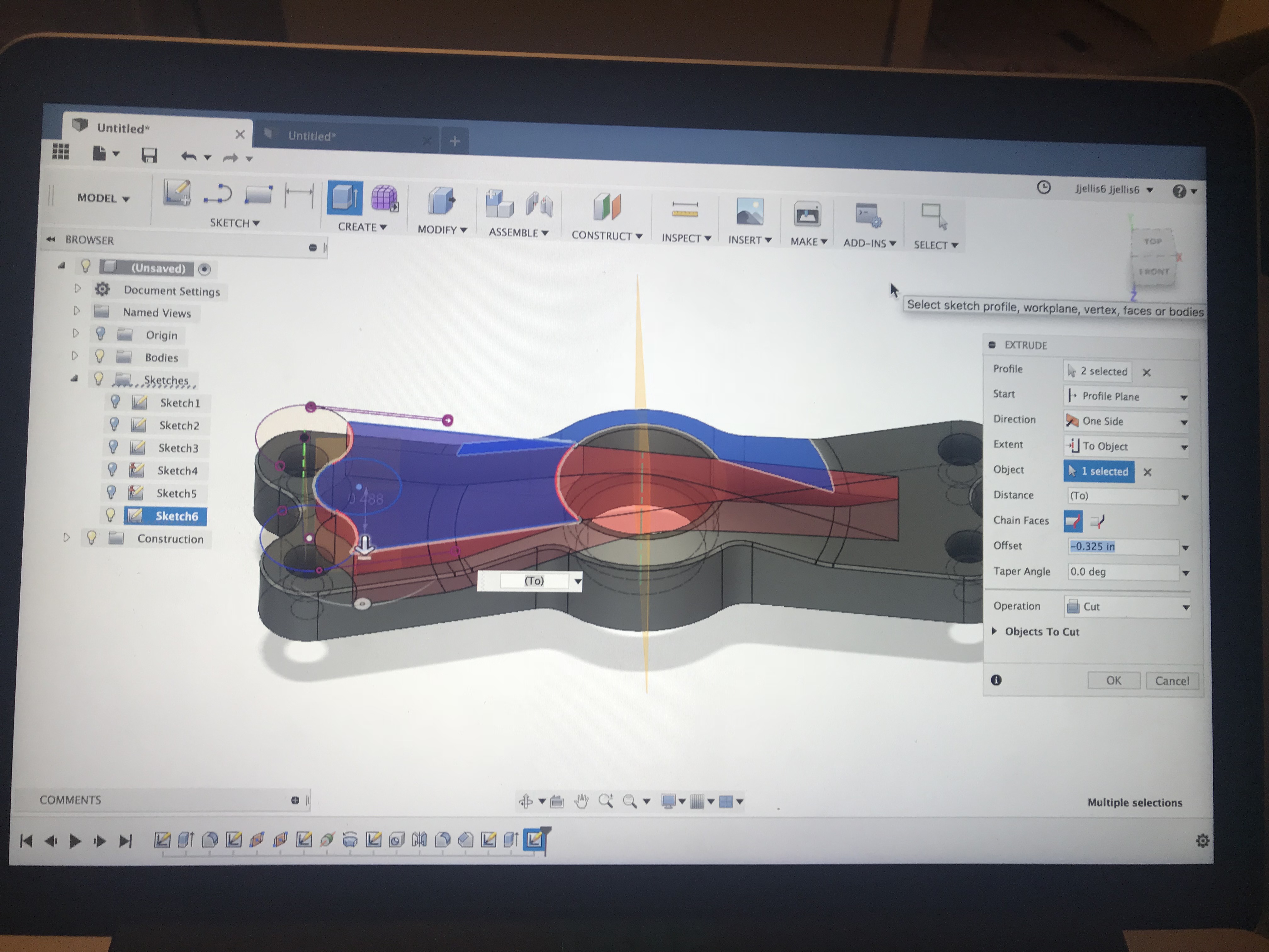

quite possibly i have a setting or something wrong with fusion? as i am not able to complete the 9M after many attempts as well. Do you guys have any recommendations for this problem? when i try to press pull the pocket “to object” it shows the intended space correctly, as soon as i type in the offset as “-.325” it unselects that entire surface and makes this weird cut away. please help! Thanks in advance. @Billy-Boyce IMG_0005
Hello ! Please share your Fusion file URL code…
Not sure how to do that ? please watch this video/ >>>>>> http://academy.titansofcnc.com/series/fusion-360-fundamentals/share-your-fusion-360-file
Not sure about the 9M, but I encountered the same problem with the 10M. I had to do the ribs in two different sketches and features to get it to work.

After fighting with the ISO web, I found a work around. Go back to the sketch and “Break” all lines where the lines forming the web connect to each other. Then you can select individual lines to make the web. It worked for me.
