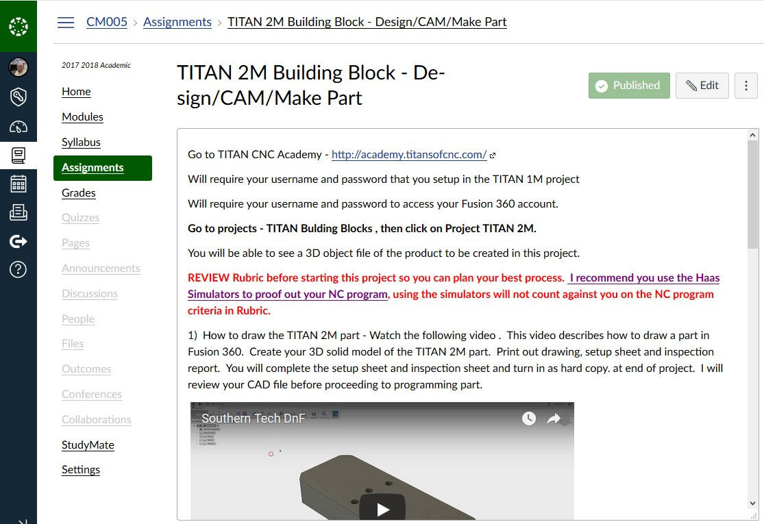

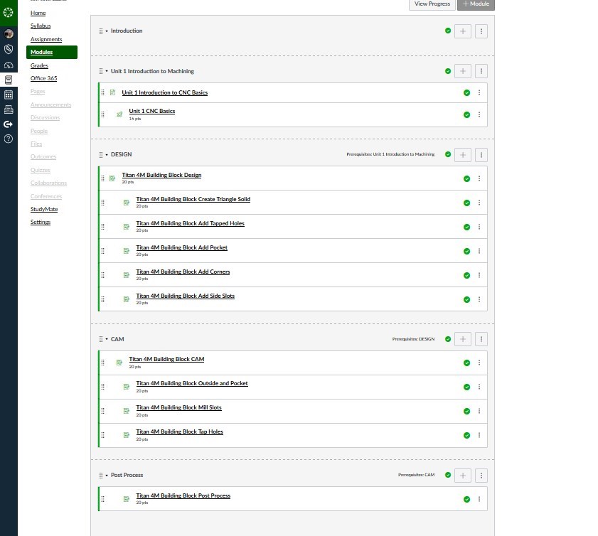

I break up the construction, CAM and Post process into segments (each has a prerequisite, each has a point value) I can easily see a student’s progress, I can catch problems much quicker, the student can complete 1-2 assignments per class period so they feel accomplished. I make it easy on myself to check progress. Of course the actual machining is a one on one verification with the student and myself. In the Post Processor assignment they have to verify on a Haas simulator, then they seek me out and we go to the machine. I have them program and include in all of the tool changes the G00 G43 Z1.0 Hxx line code. they run single block, option stop, 25% rapid, distance to go on position screen. I am adding that they run in MDI a Work Coordinate Position check G0 G54 X0 Y0 and they will check each tool with a similar MDI code. Here is how I have it setup in my LMS. modules
I create a short video, no longer than 10 minutes long and embed into the assignment. This is what the assignment looks likeassignment

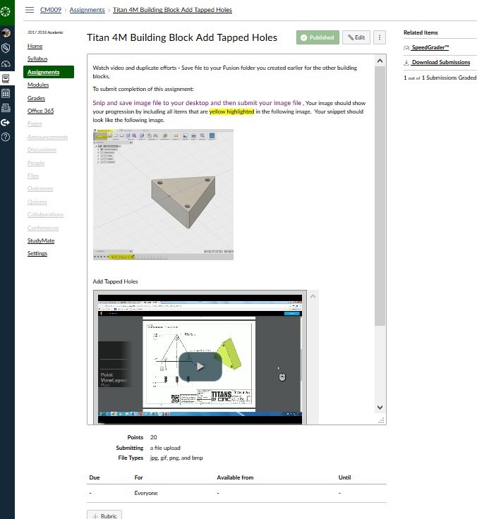

When you break projects down into smaller steps, how do you have students submit what they have completed? Are you having them export the file of what they have done to that point into a folder, taking screenshots and submitting, or how?
Shown in previous reply where I had images of the modules and a sample assignment. In the assignment it states they have to submit a snipped image of their current progression of the design. There is criteria for the image they get points for.
My apologies Stephen, I am having a hard time reading what it says. I copied the pictures but when I try to zoom in it gets very pixelated.
This is instruction/language they see typically, it will have an image they can review so they can replicate the image. The video at bottom of page is the >10m clip showing how to do the current operation
"Watch video at bottom of page and duplicate efforts to make the part - Save your file to your Fusion folder you created earlier for the other building blocks.
To submit completion of this assignment:
Snip and save image file to your desktop and then submit your image file , Your image should show your progression by including all items that are yellow highlighted in the following image. Your snippet should look like the following image."

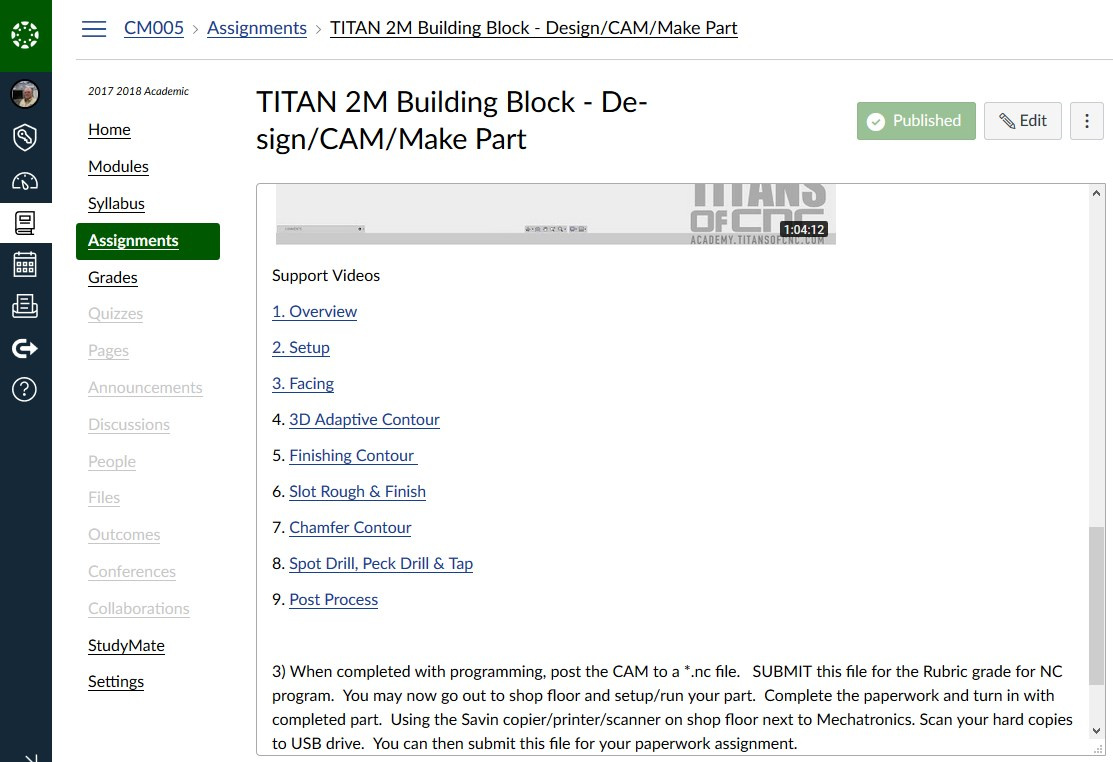

Here is the portion of assignment page that has links to the short videos. image

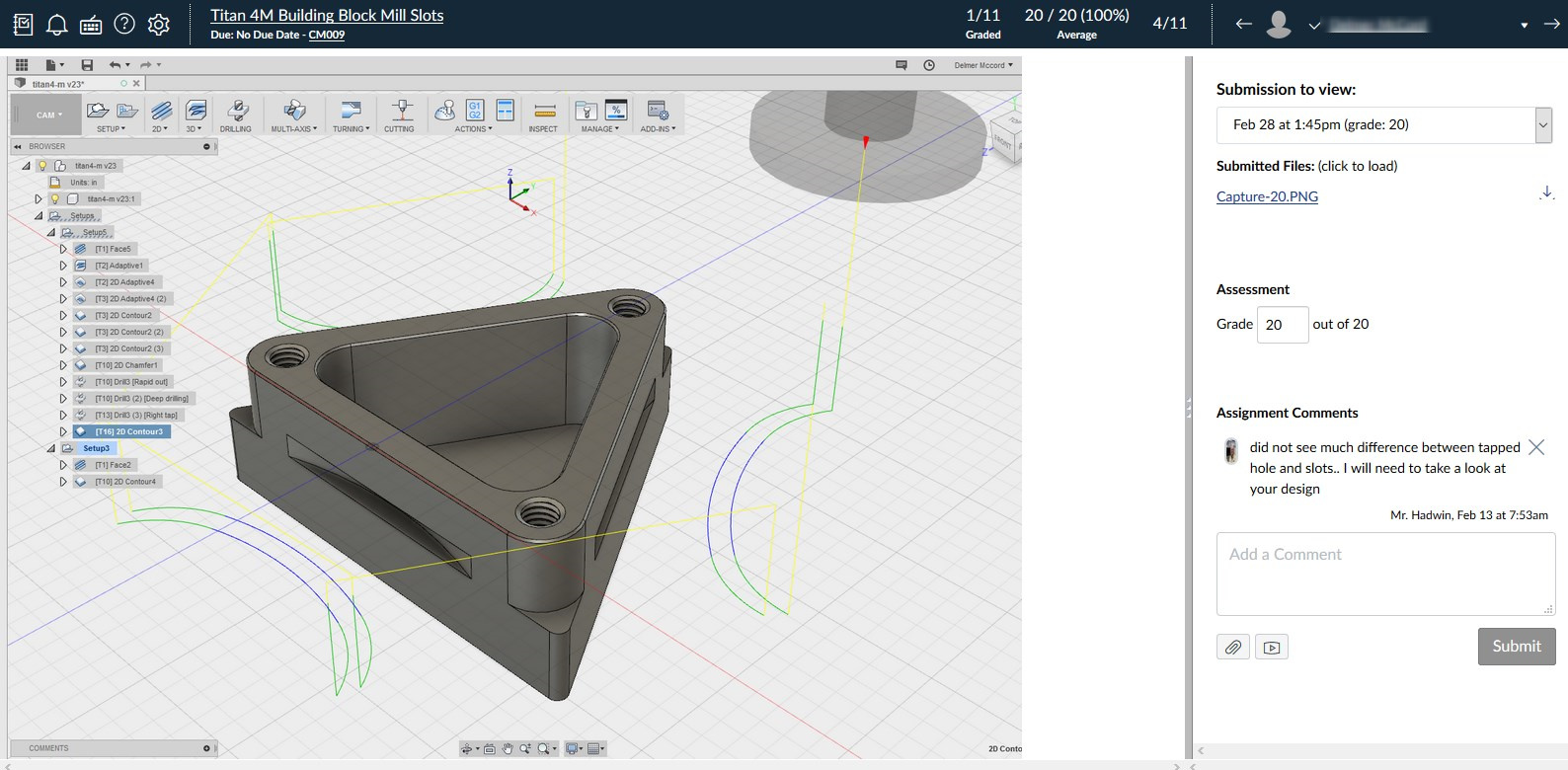

Here is an example of a student turning in a screenshot of his CAM path for milling the slots. I can verify his tool path and his feature tree at bottom of screen. I can mark up and comment and grade from my home.

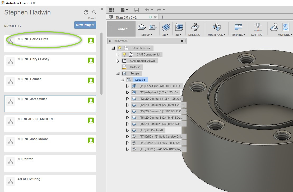

JasonNye asked me how I viewed the student’s CAD/CAM work, did I have them turn in a USB drive, save to a folder, etc. Since I had all students enroll and register at the first of the school year for Fusion 360, one of their assignments is to create a shared project folder named “3D CNC their name” and add me to the folder to be able to view and edit. So if they want some help or want me to verify something they have worked on, they just save to that folder and notify me to check it out. image
