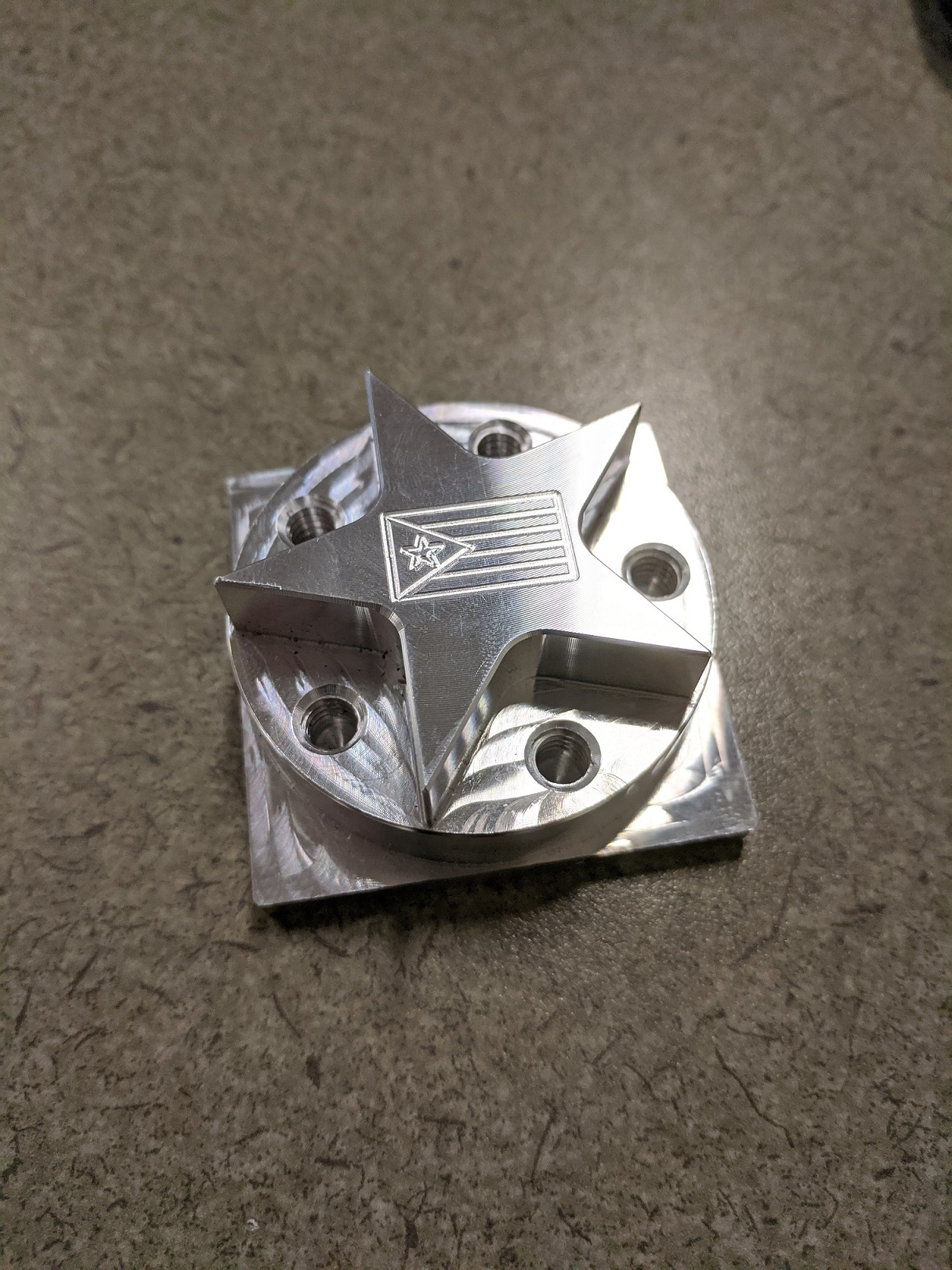

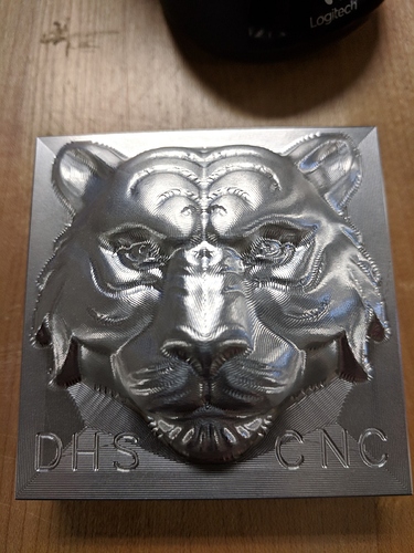

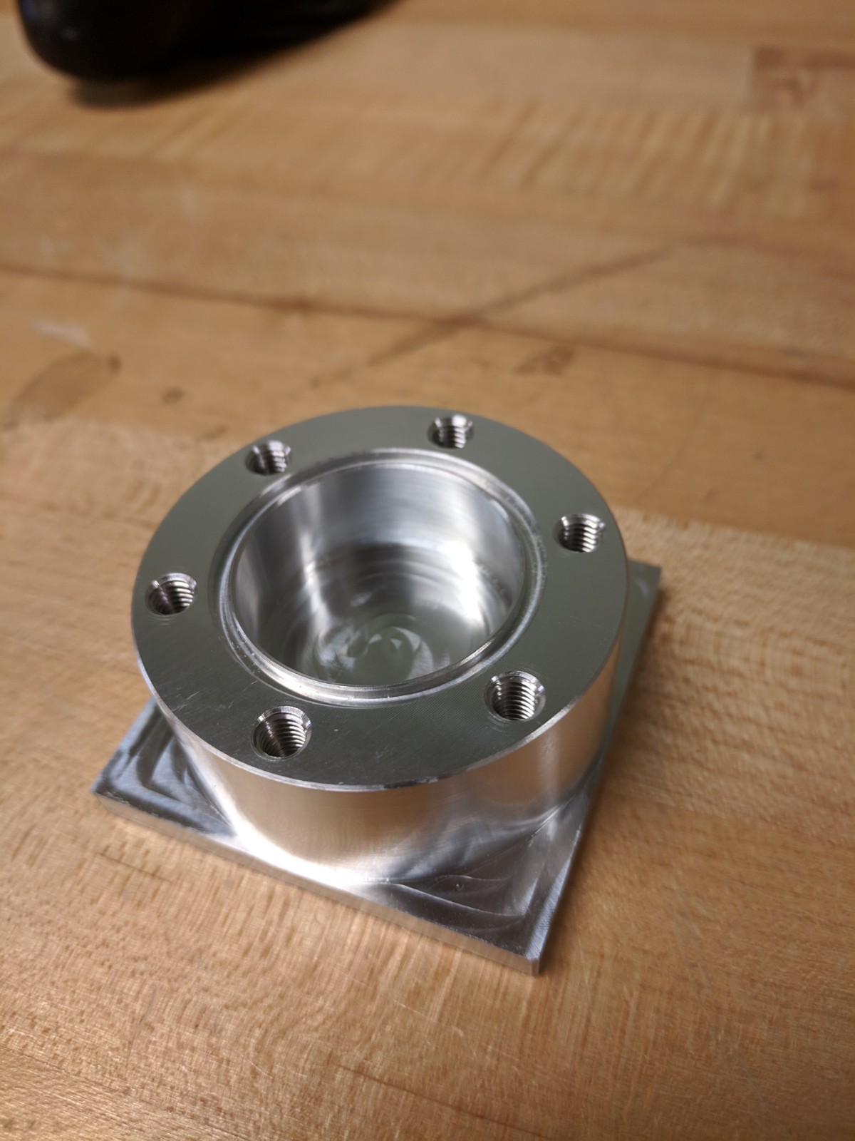

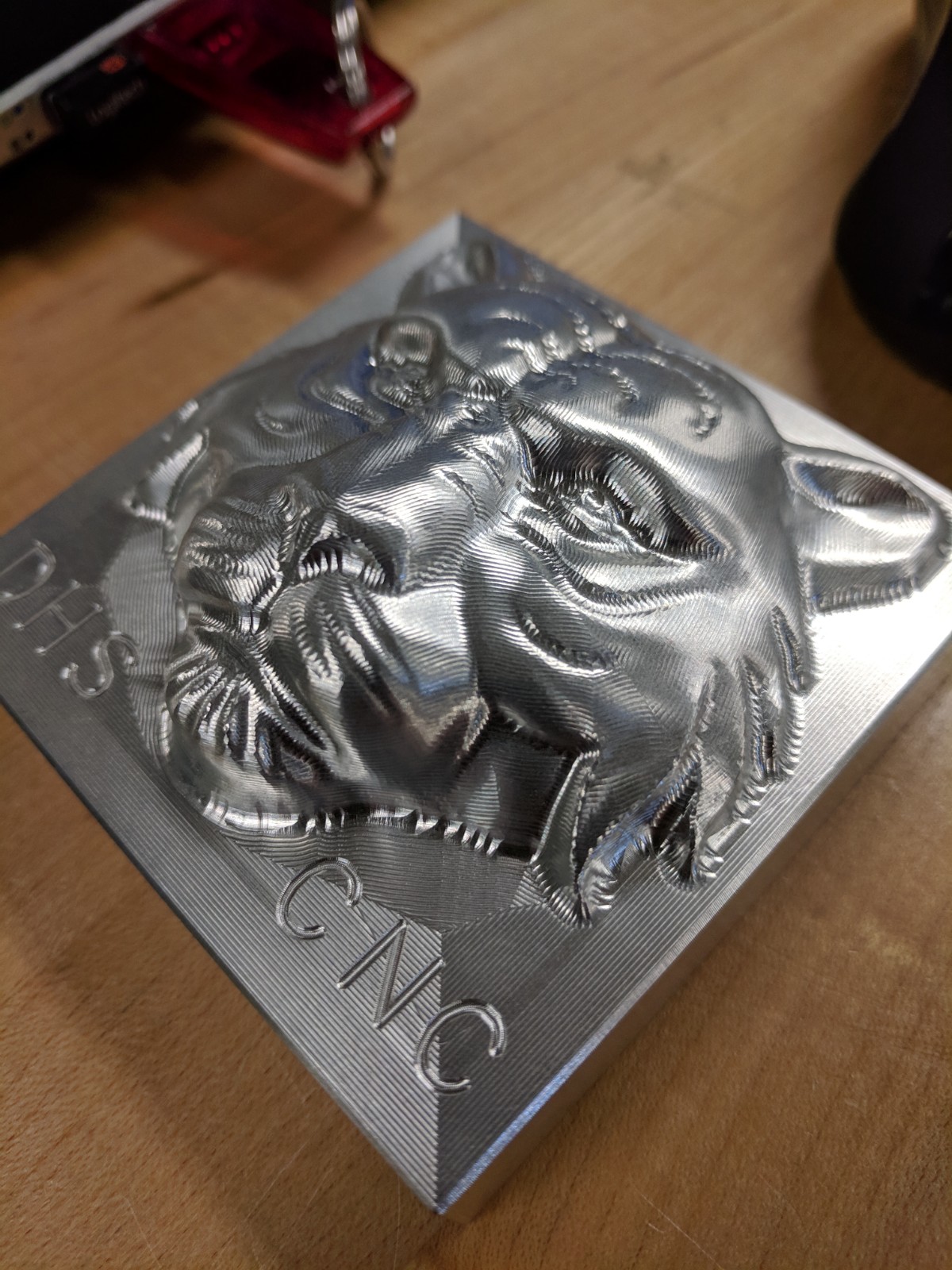

Sorry about the delay in getting back to you. We did get the lathe up and running. Thanks again for your help. We have made a couple of parts with it. One of the pictures is chess pawn a student made last year. I hope to use it for more parts this year. There are also some pictures of a couple of Titan milled parts the students are making. There is also the tiger we make because the Dunbar High School mascot is a tiger. The First Robotics season starts next week. We made some robot parts last year. We should be able to make some more this year.
So things are going pretty well.
