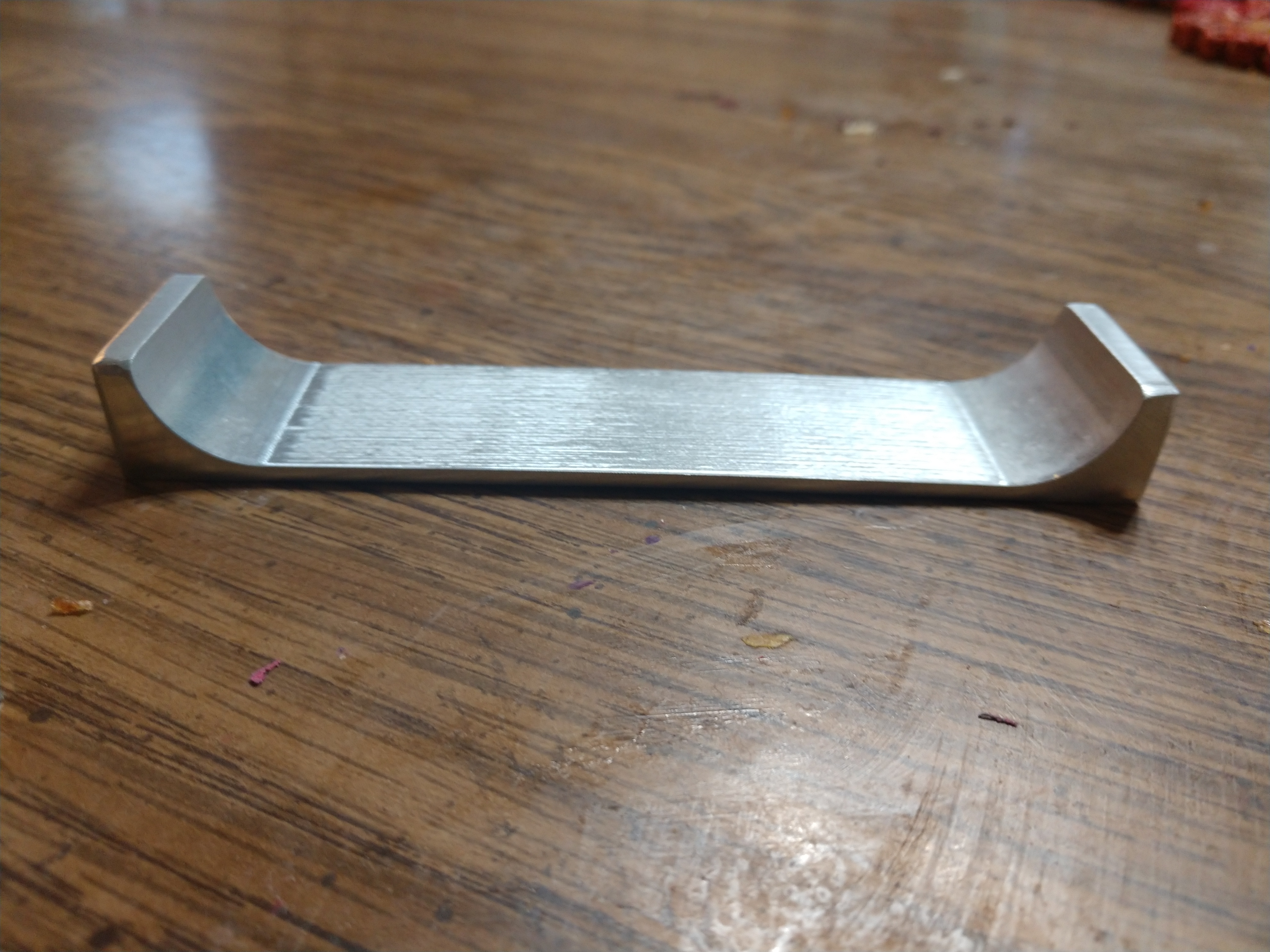

Ok so I was working on a part at work I made some soft Jaws to hold it because it was milling the part down to 2.06 mm at it’s lowest point and 14.76 mm at it’s two highest points think skateboard half Pike well the first one I ran I had at like .07 of a mm all the way around some high some lower than the 14.76 but within my .13 tolerance now there was lots of pulling off by other shifts finally what I ended up with on a different machine was a tapper from front to back of .0027 inch is there away to make my machine shift the Z to counter this angle?

So from the deck up to the top of this part is supposed to be a single height and it’s tappering off at an angle

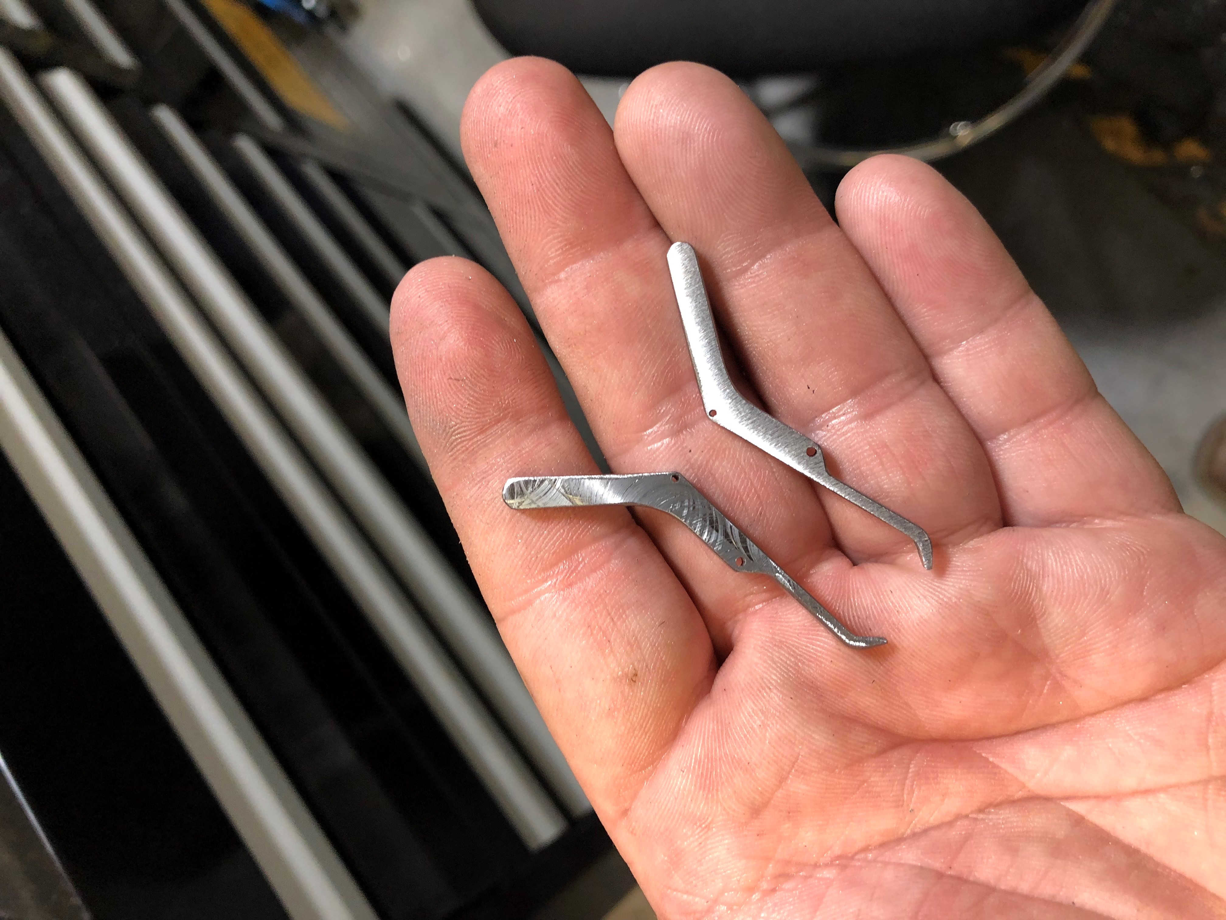

Since you asked, then it is safe to assume you do not have one in your shop. Here are a few videos showing type of work and process
That is amazing no we don’t have anything like that in our shop we have a bunch of vf2s 3s a pallet changer a 4th axis and a vf something SS and 2 manual mills
Part
This was caused by some deflection and tool path.
I’m gonna say deflection is what your getting either from the jaws or the tool path/ feeds and speeds. That is just judging by eye looking at that part and the lines i see with that lighting.
The issue isn’t working much the finish it’s the fact that the front jaw is lifting up some it’s a Kurt Vise I’ve tried tightening it and didn’t help much… another shift tried it on parallels and didn’t change anything but milling some off the hard jaws and got an almost identical part so anyway to fix this?or just insist on a little more tolerance?
So you have tried tightening the front jaw down by the adjuster screw. I have tightened them a little more snug than they should be to keep the front jaw from lifting. Which this sucks a bit as obviously will make cycling your vise will be harder but may help you out… If not then I would look into the tool path, feeds, speeds, step over, and such.
dumb question: have youput a DTI on the spindle/tool and check the vise or table, etc front to rear for taper? Basic stuff, but only takes a minute to check…
looking at the photo of your part, I would make this part using a different work holding strategy.
