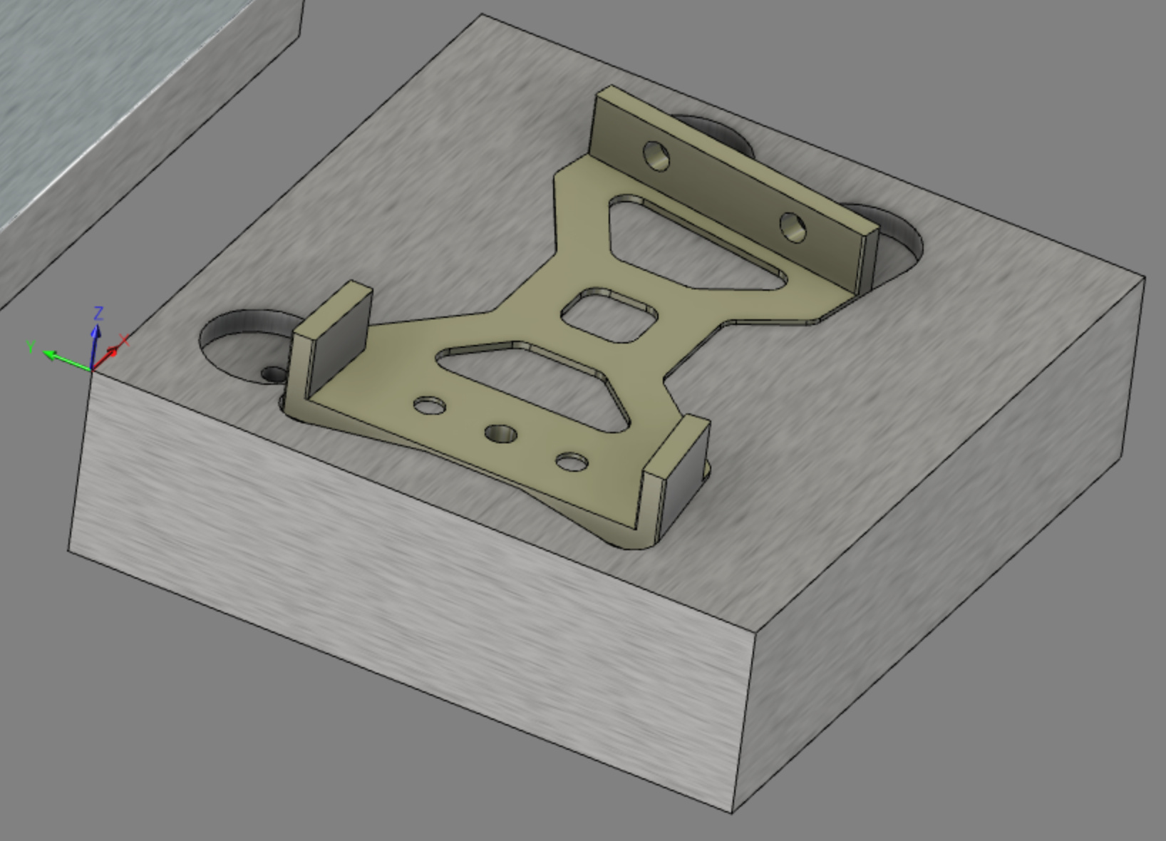

I’m struggeling a bit with a fixture design.
The part is about 80mm x 110mm x 19mm from a 20mm stock flat bar.
I machine the bottom first and go down the sides 15mm
I then flip the part into a fixture and locate off the corner of the fixture.
When doing the rest of the sides I get a little shift and a thin line on the edge.
Is there a better way to do this? When I get it right I want to make a larger fixture pallet for production

Are you sure it is shifting while you are machining?
Do you probe it after flipping?
One thought does come to mind. It looks like you have pockets for a mite bite or something similar. We have experienced part flex with those.
I know not much help but just some thoughts
Yes, I have to probe it after flipping because I’m placing the fixture in the vise.
I understand I have uneven pressure because of the miteebites being on two sides, but still.
I am not thinking so much the uneven pressure but maybe its bowing on you? It looks pretty thin.
It might be you just need a different style clamp. They have good customer support, might be worth a call.

@BjarteLunde I am curious if you were to use the top hat method. Machining the hole part using stock thicker than needed then make a fixture letting those legs go down into it. Then you would only have to cut the extra off the back.

No, I will try this in my next try.
@BjarteLunde
Have you tryed the top hat method?
Tried the top hat method.
Worked like a charm. Much better finish all over. And very easy.
Now I just need to make a pallet :slight_smile:
