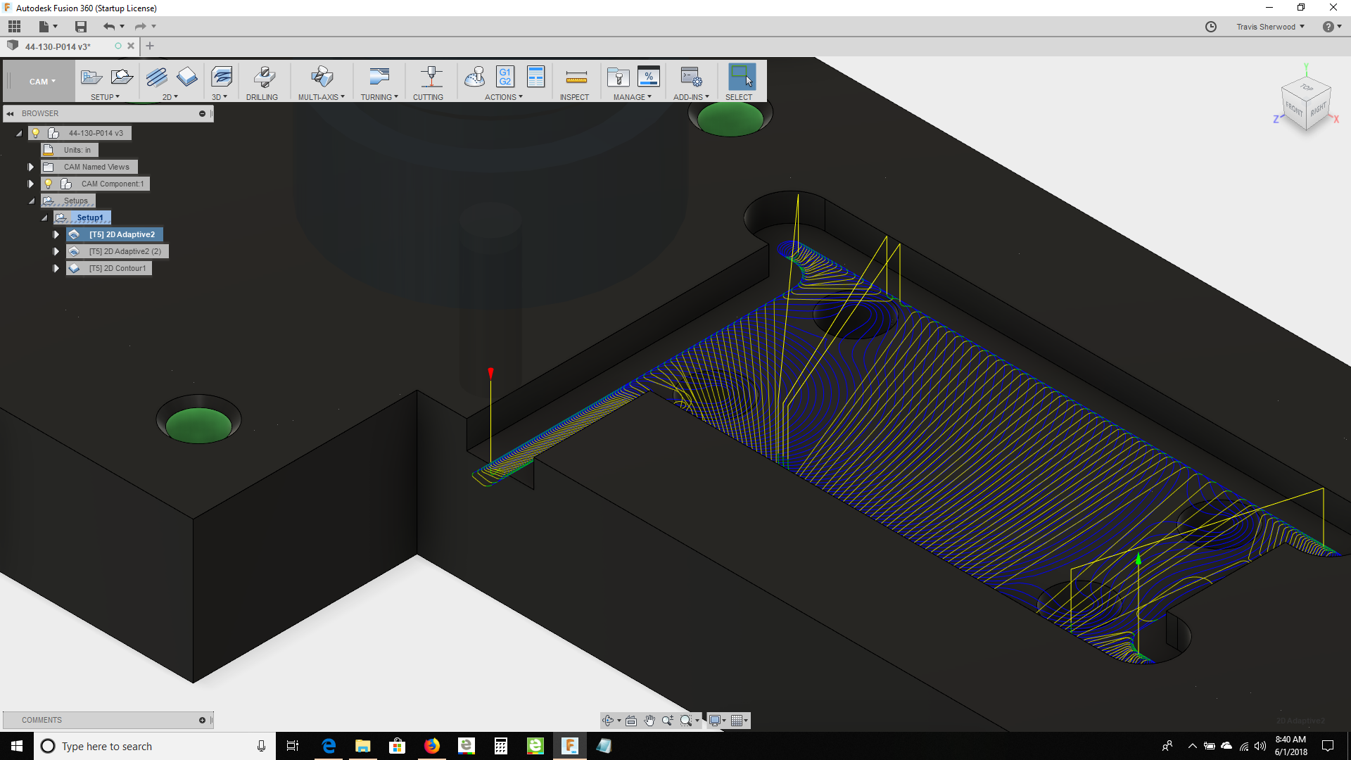

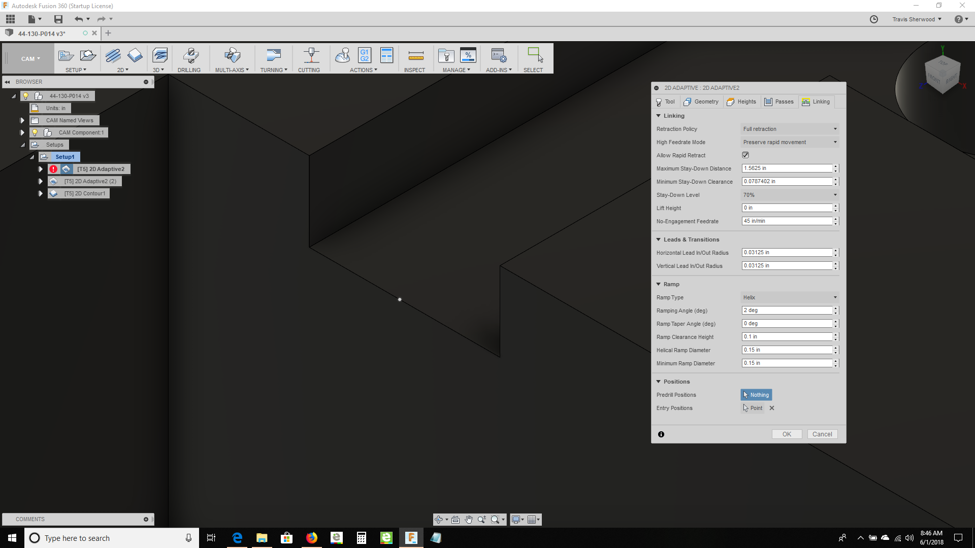

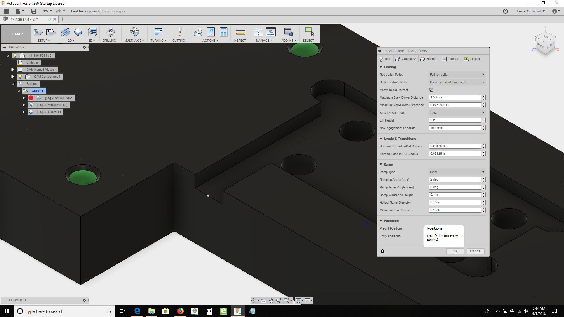

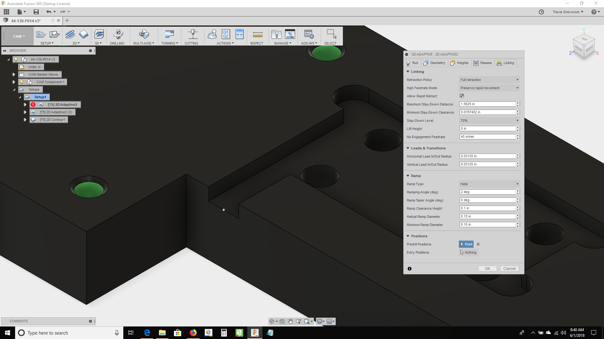

Hello I am having trouble getting Fusion to do a helical ramp into this part. can some one help?

imageScreenshot%20(31)

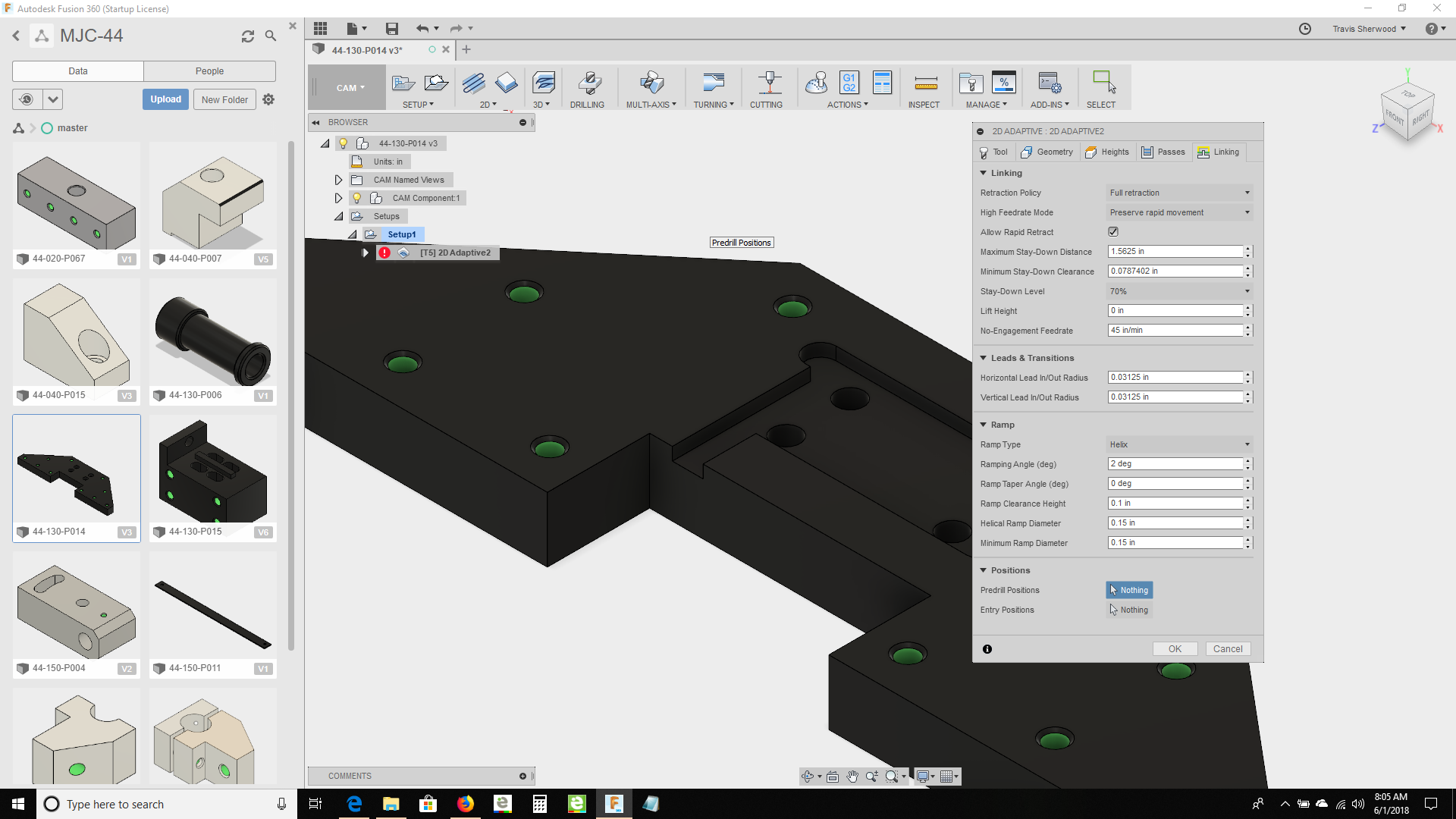

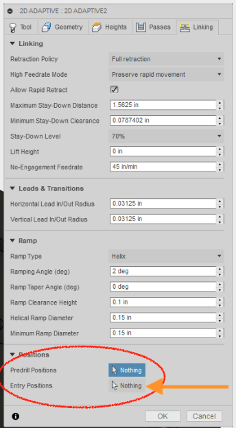

Did you try to chose a entry point or a predrill point?
00%20AM
I did try that but it is still not interning on a helix.

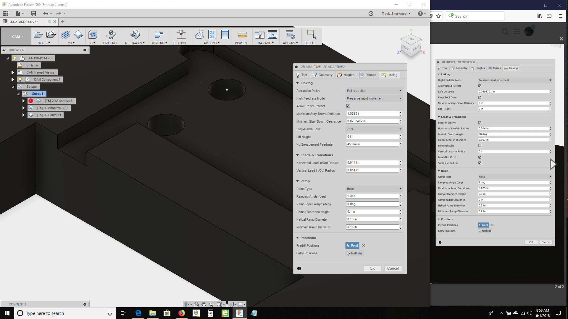

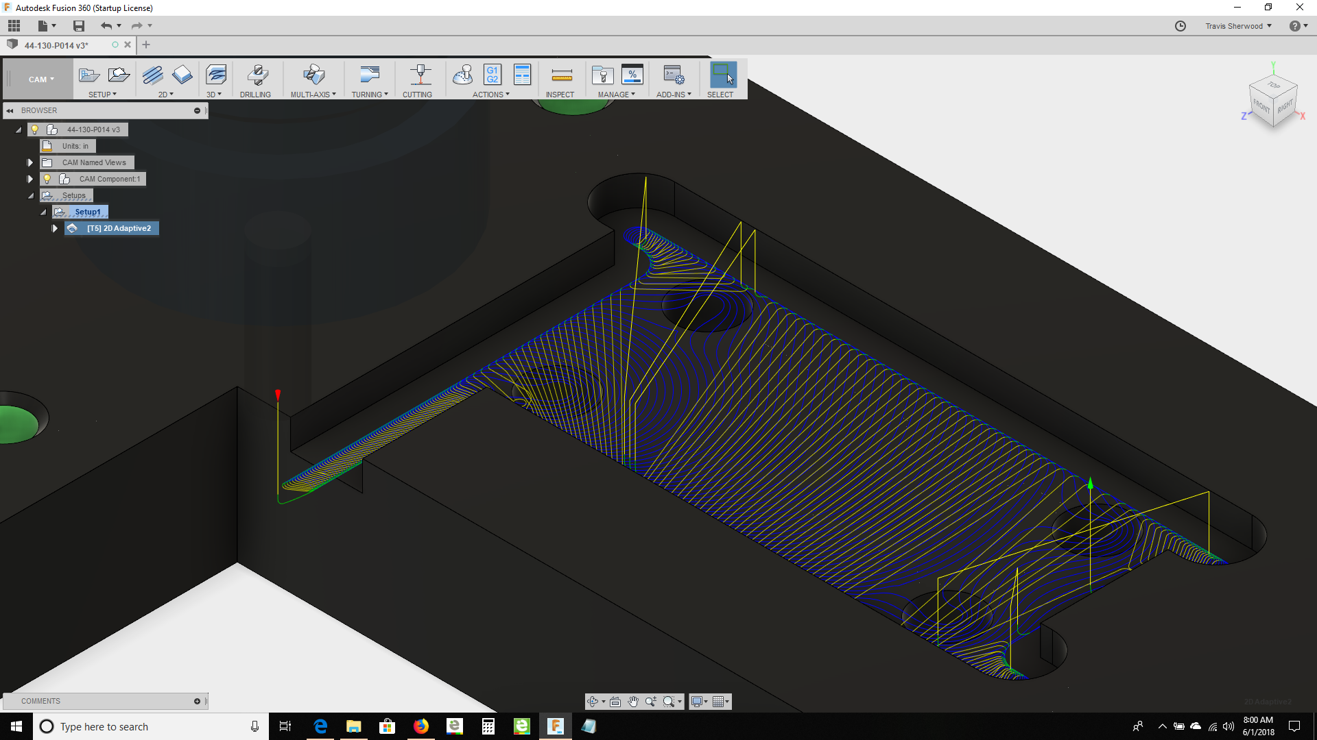

Screenshot%20(60)Screenshot%20(68)
if you drill the holes from the other side first like the file you provided you can just plunge into that hole no need to helix in.
Screenshot%20(69)Screenshot%20(72)
18%20AM34%20AM

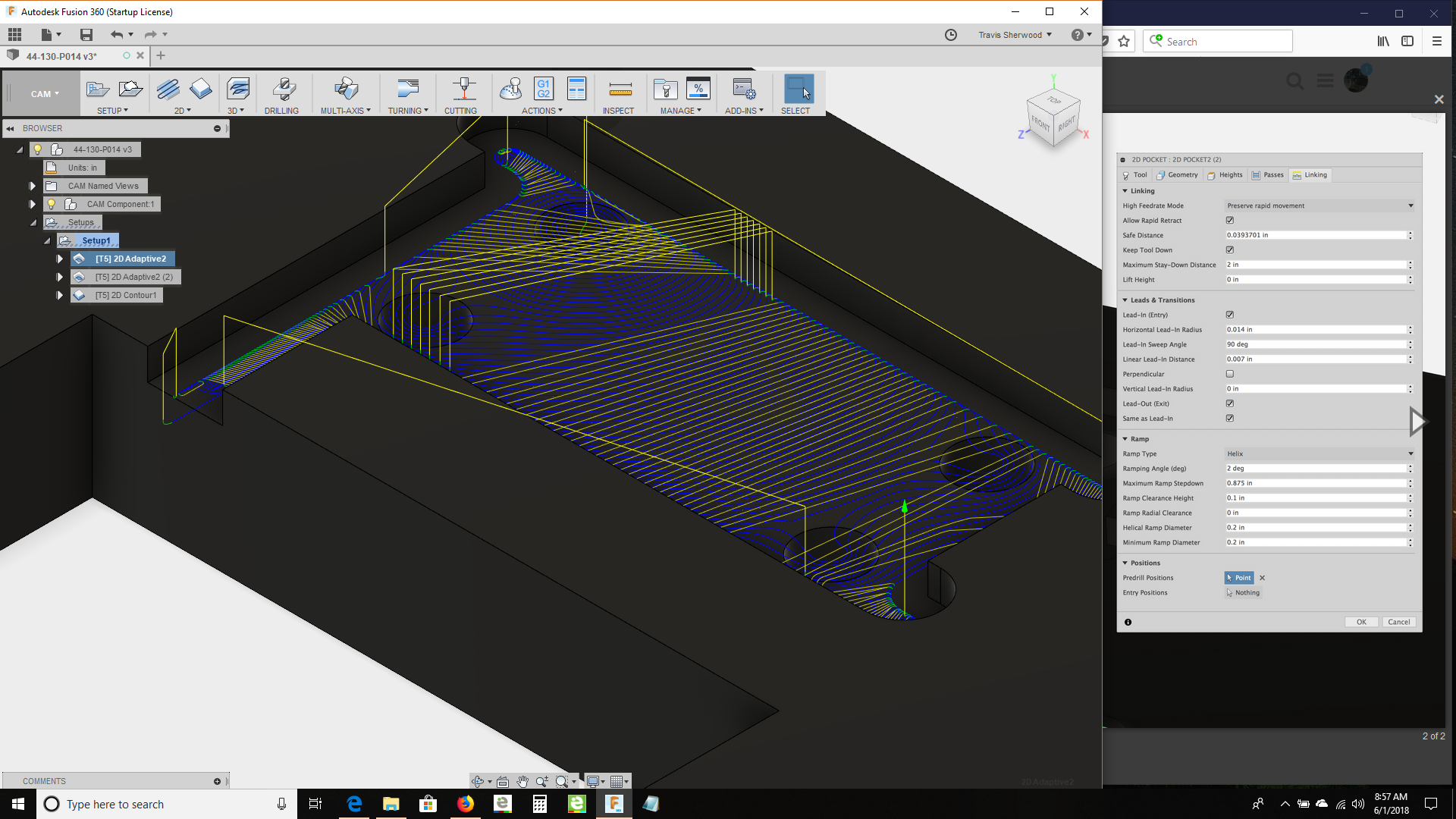

For some reason my linking window is not like yours? but I still cant get it to ramp
Screenshot%20(82)Screenshot%20(74)

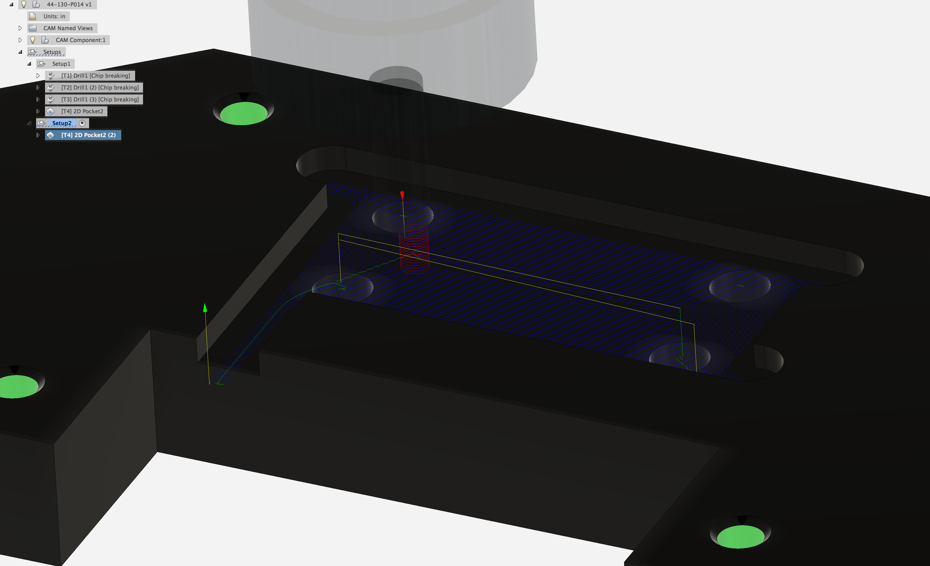

thats my bad I copped your last tool path from the other operation (pocket)
what size tool are you using? The file you linked did not have this tool path on it.
I can just get over trying to do it my way and just plunge in to the hole as starting point I have it drilled from the other side. I will revisit this and make it happen later. it is getting hot outside and I need to be slinging chips now. Thank you for your help!!! @Billy-Boyce
5/16 diameter end mill
10-4 try using pocket it seems to work better for this.
