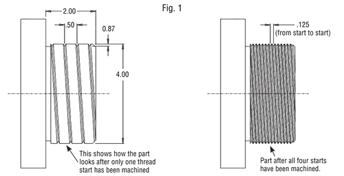

I’m trying to figure out how to program an internal multi-start thread. It’s basically an acme thread, .156 wide grooves, 24 starts, .278 Pitch, CCW. I’m assuming that I will need to use G76 on a FANUC O-T control, but just having trouble figuring out what my inputs need to be. Any help would be greatly appreciated.
this may help:
and
www.machinetoolhelp.com/Applications/macro/threading_macro_g76.html
