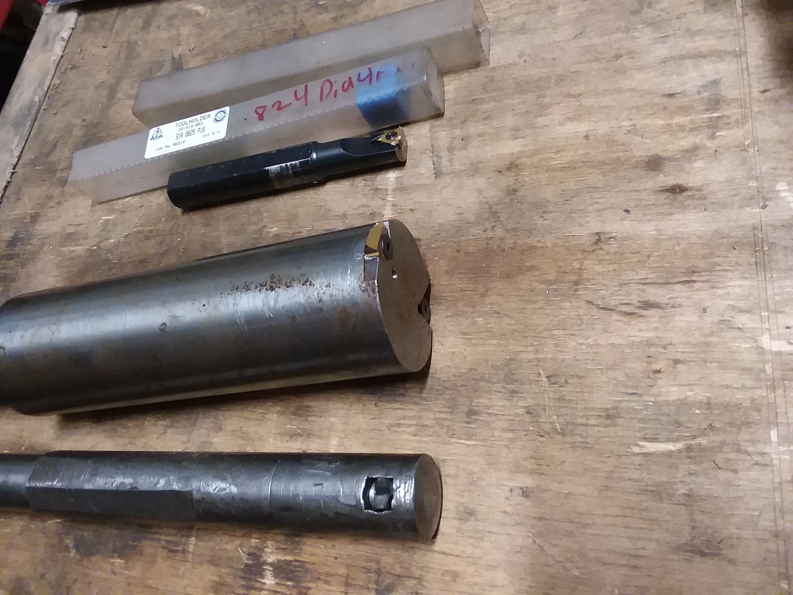

Here are some tools that I have used for single point thread Milling. The standard boring bar works fine whith it’s ability to change inserts. In 2.5" diameter shop made one works really good also. But the one that I have used the most is the old shop made one and a quarter inch diameter with 1 inch shank that I turned down. this one has six inch of reach as a minimum but it does work good with that length.

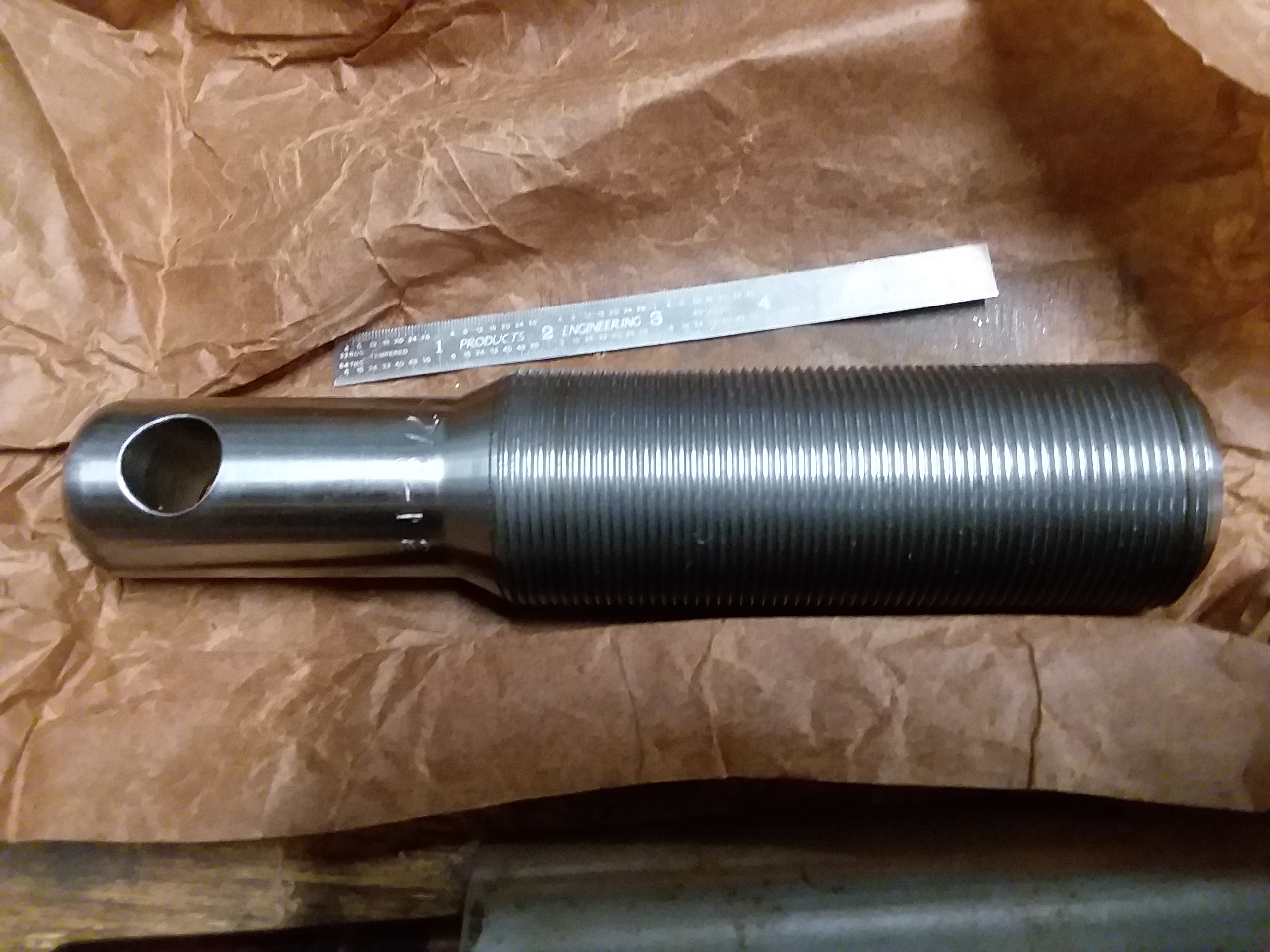

Also on those Oddball threads I generally make a gauge if I cannot easily obtained a bolt this one is a 1 7/8 - 12. A word of caution if you make a gauge or use a bolt you need to allow clearance don’t just cut it to where the bolt fits there’s a specific amount of clearance and most larger-diameter bolts .I will check your ready reference for that data. I also often purchase the larger Taps on eBay rough cut them in with the treadmill and I finish them up with the tap.
Internal threads use a laydown thread bar if you can the cost is way less and quicker in most cases.
If you are doing these in the mill and time is a concern and you can spare a little extra money a full profile thread mill works well. Much faster than a single point thread mill as well.
Od threading again use a laydown threading insert.
