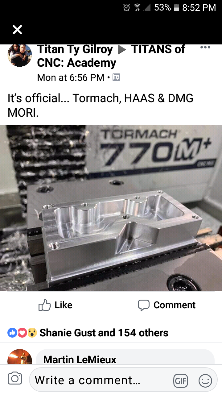

@FrankGoodman Hear is a post in the Facebook group using a small mill like you are talking about.
