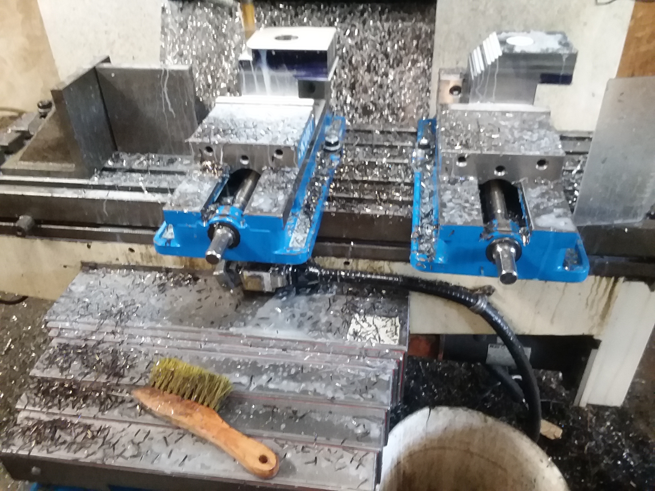

I Have 10 of these to make I was wanting to make 2 at once 1 in each vice. I wonted to use tool 1on both parts then tool 2 on both and so on. I was going to ust G54 and G55 for the location. I do knot know how to do this any help Would be Appreciated!!!

it’s easy to do. It’s all in the set up block on fusion. In the set up block where you set your stock etc. Go to the post process tab. Make the WCS offset 1. Check the box that says multiple offsets. Make the duplicates 2 and increments 1, and in operation order make it order by tool. When you post the program it will use G54 (datum 1) it will use 2 Datums and the second will be G55(incremented 1 on from G54). Ordering by tool will use tool 1 for both then tool 2 for both etc.
Thank You all for the help.

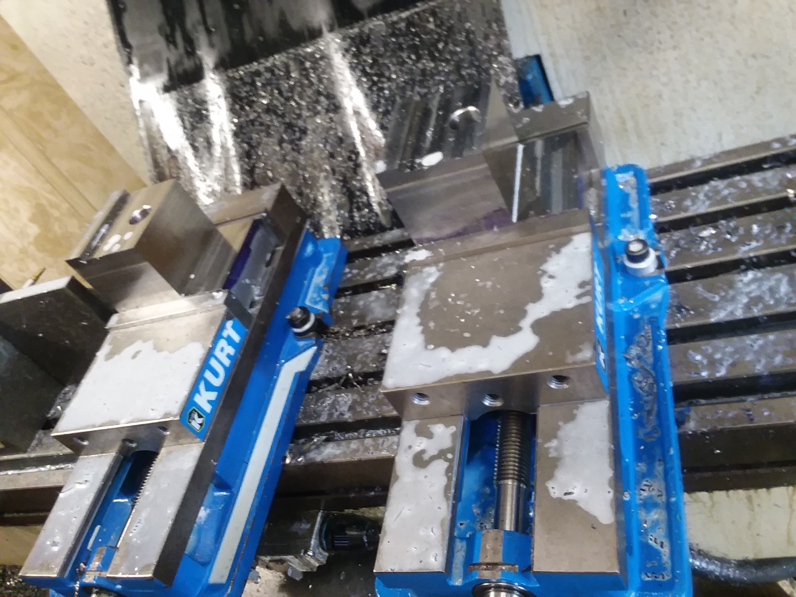

I had sweet success making the parts.20180619_08364420180619_150153
I’m glad it worked so well. Parts look good.
