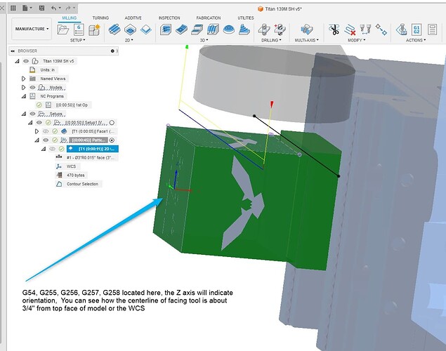

I am working on the 5 axis parts and have run into an issue with the Tool Orientation not being available. It seems to be a pay-for-play issue now as there is no box to check, just a pretty blue Icon that basically says pay up when you hover over it. Is there a work around or do I need to create new setups for each face? PITB if you ask me. How would each setup work in a HAAS 750?
Regards,
Brian Gracia

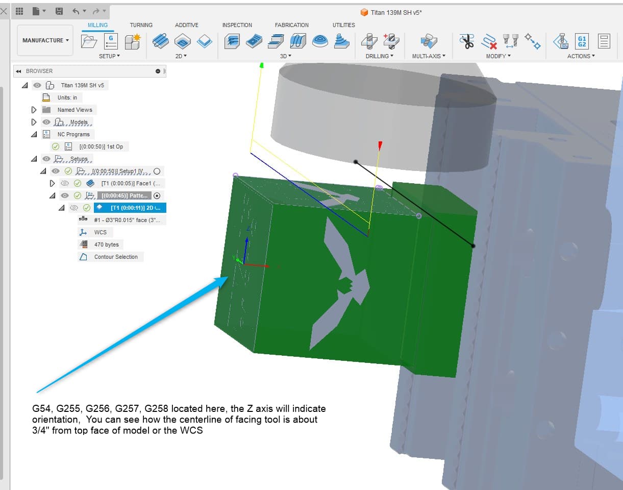

The free Fusion was always 3-axis only, you will need to add the manufacturing extension. It is a pay feature :frowning: UMC-750 use G54 for top of model centered XY, the G254, G255, G256, G257, G258 for a 4 sided square… Here is the code, I was machining a 2.075 Cube that has a stock that is 2.25" square and length of 3.00 long. I faced the top, then used contour to face the four sides.

N145 G254 (1st side WCS - center of model for Z)
N150 G1 X0.775 Y-3.1245 F650.(Moves 3" Face Mill to clear outside of stock in Y)
