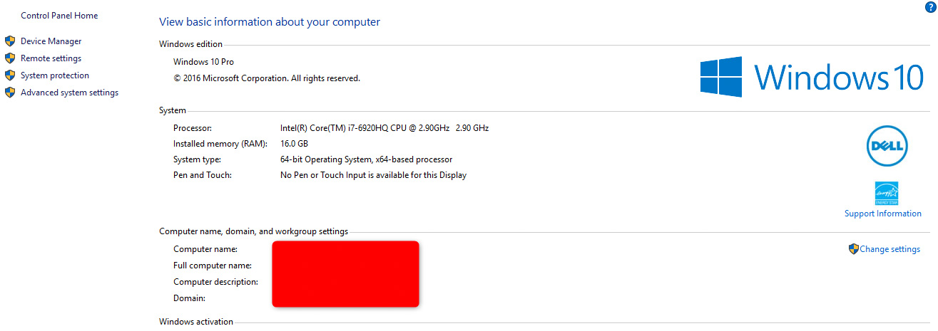

Hi @TrevorStudley I am a professional working in the UK and train in Fusion and HSM and this is the speck all of our Applications Engineers run with.
Most CAD/CAM work runs seamlessly but i would also suggest upping the RAM if you are looking to do large part count assemblies. If you need help buying a PC in the UK you can contact a company called Elmtec which is where we buy all of our hardware from.
Dell Precision 7710 Mobile Workstation
Nvidia Quadro M3000M GPU.
2018-01-08_16h55_41_edited
That’s great thanks for that, how long do the engineers run these machines ? Is 5 years reasonable?
3-5 years is reasonable!
