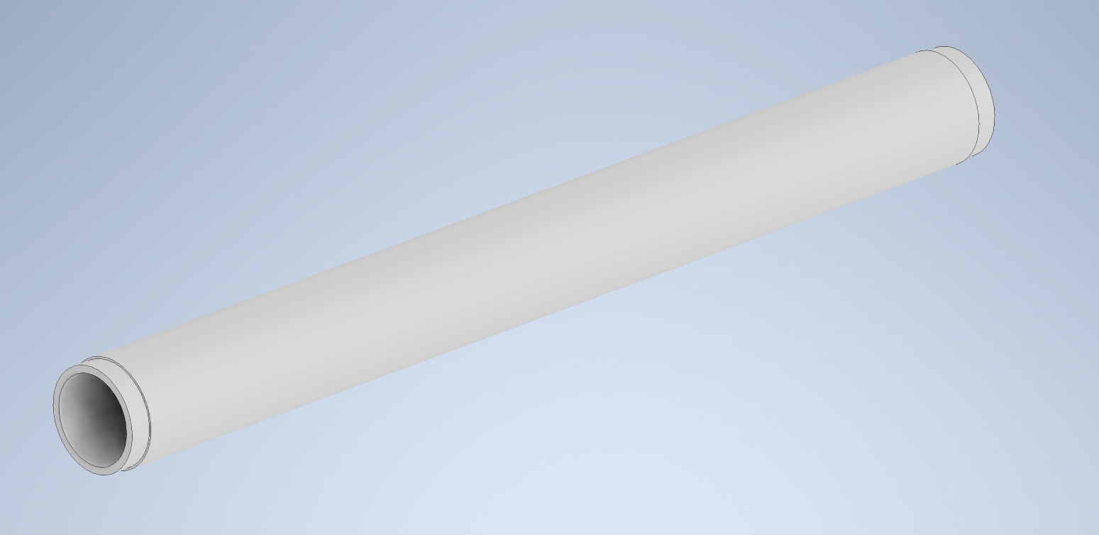

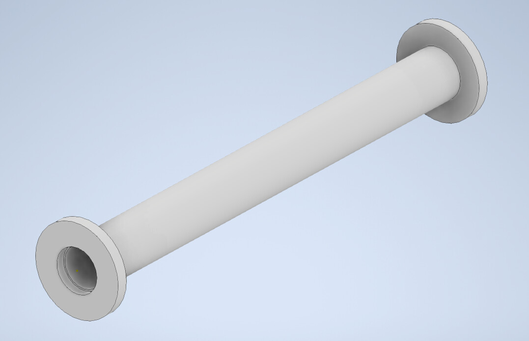

The part in its two stages:
The pipe has two steady rest area’s made in stage one, we are Currently making this part on a conventional lathe.
After welding the flenges we use the steady rest again and finish the pipe with a 0.02 mm tolerance bearing housing on each side.
Have ideas? or tips on what machine is the best? I am completly new in the cnc buisnes. What counts for me is a brand that has good schooling & accuracy
