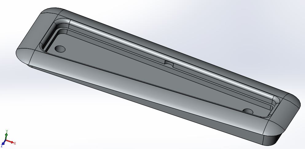

Really could use some help on surface finish and reduce run time
@MitchDomina Its hard to see the actual shape of the part but you might be able to use a form tool like a corner rounding tool.

I was hoping I’d be able to upload my model so people could see it better.
Machine time oin this part is over an hour.
It’s only 2.5" x 6" by 1" deep.
I’m using a 3/8 flat endmil to 3d adapt clear the inside and out.
Then using a 3/8 ball end mill and a parallel tool path to do the large outside filetted lip. This operation is 80% of my run time. I’m doing it in 2 passes. First one is with a 0.020" step over. The second pass is with a 0.005" step over. I need a very smooth surface finish. Feed rates are 30in/min
Any help would be AMAZING!
Thanks guys!

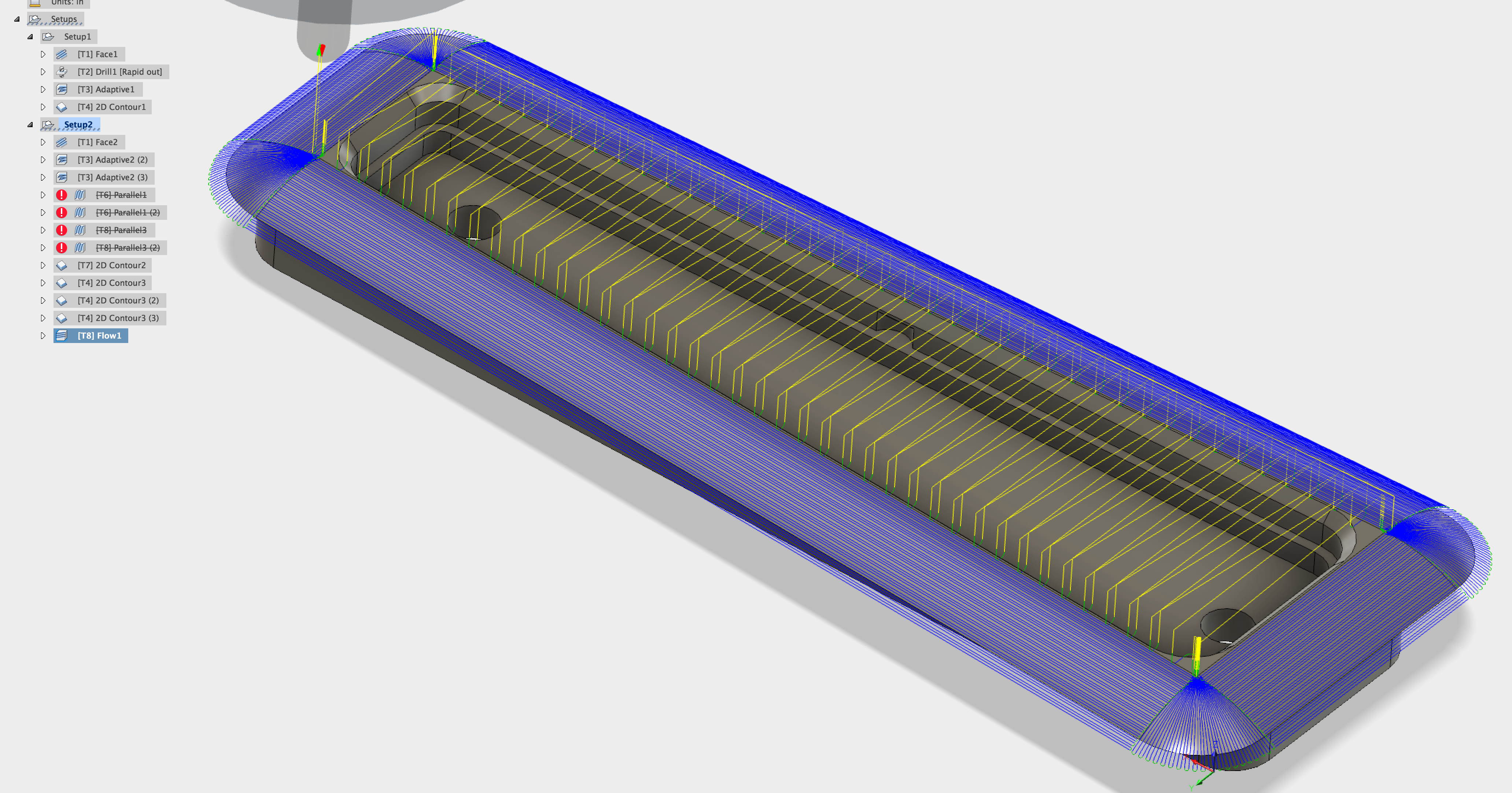

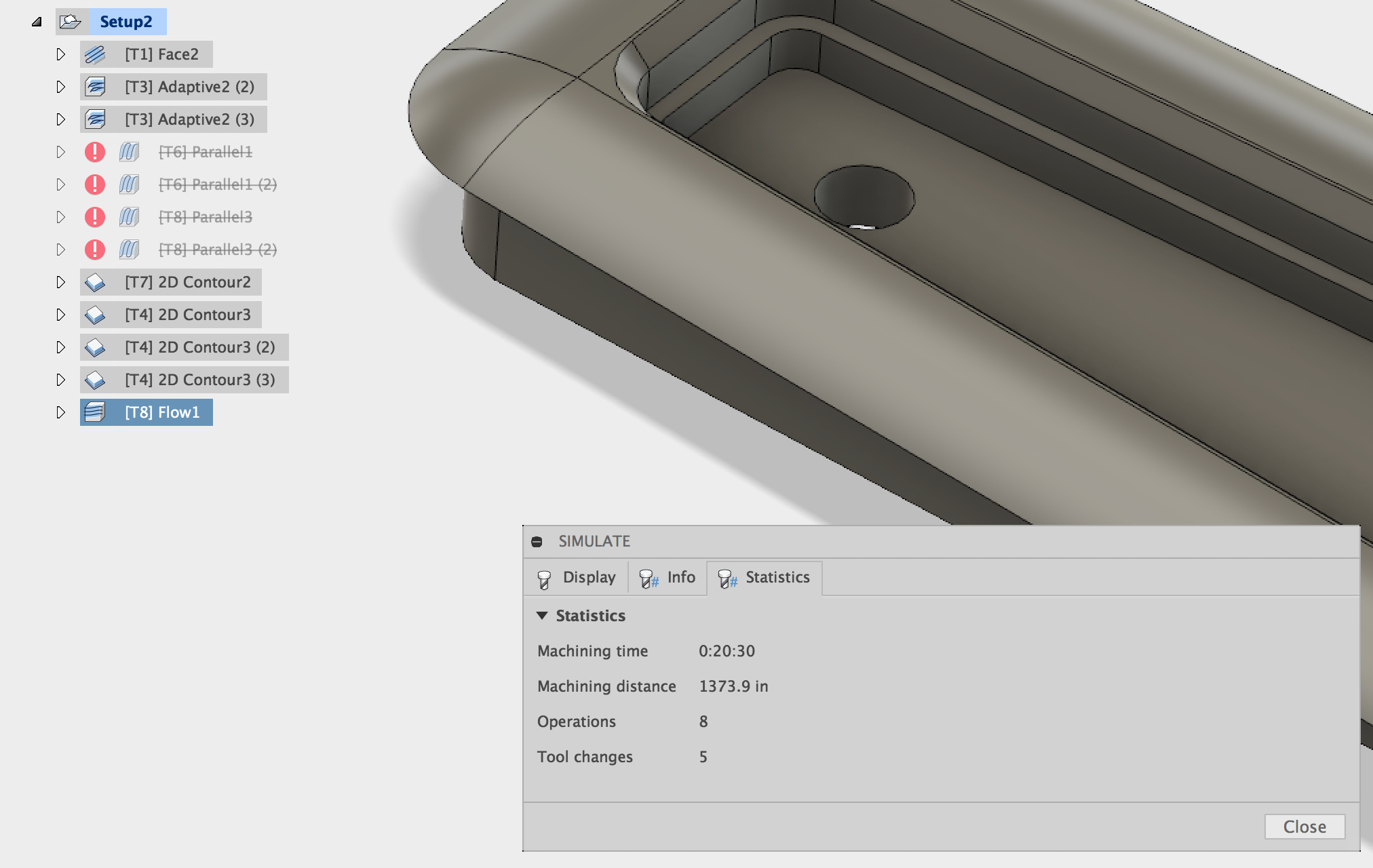

It looks like you could cut down the time by just using FLOW. I think you can also join the 2 Adaptive paths http://a360.co/2C8flKs
19%20AM39%20AM

THANK YOU!!
I never even played with the Flow feature
Thanks again! You Rock!
