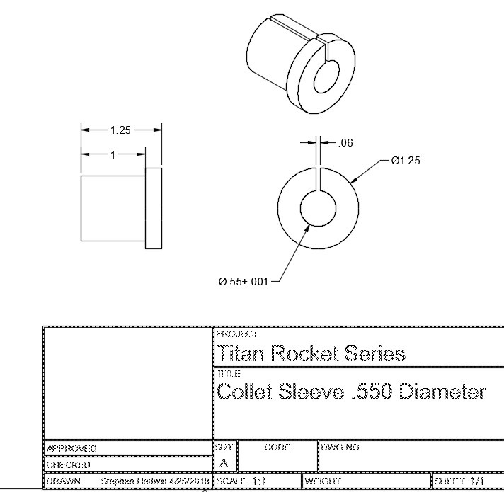

Seeking ideas and suggestions for fixture or work holding the 2nd Op routines for the Rocket Series. I have two ST-20 lathes, one with a Collet chuck and the other with a 3 jaw chuck. I am thinking I might dedicate the Collet chuck for all 1st Op Rocket parts and use the other lathe for 2nd Ops. I made a sleeve with a 1" OD and .550 ID, about 1 -1/4" long, having a 1/16" slot cut thru from OD to ID. Position the slot between jaws of the 3 jaw chuck and clamp. This holds the .550 barrel of the 85L part really well.
Seeking solutions or recommendations or best practices for work holding the 7 parts that require a 2nd Op.

Here is how I will attempt based on accessories I have. Subject to change
1st Operations using Royal 1" collet chuck and barfeed (all parts)
2nd Operations using three-jaw chuck sized to hold 1" barstock ( I plan on having this machine tooled up to do 1st Ops also)
84L - 1" diameter x 1.5" long AL with 3/8-16 tapped hole (face nib off end only)
85L - 1.250 diameter bar, OAL 1.5" lg, AL with 1" turned diameter x 1.25" lg, having .553 ID thru, adding 1/16 slot thru to allow compression
86L - Not required
87L - 1.250 diameter bar, OAL 1.5" lg, steel with 1" turned diameter x 1.25" lg, having .953 ID thru, adding 1/16 slot thru to allow compression
88L - 1" diameter x 1.5" long steel with 3/8-16 tapped hole (drill and tap hole)
89L - 1.250 diameter bar, OAL 1.5" lg, steel with 1" turned diameter x 1.25" lg, having .953 ID thru, adding 1/16 slot thru to allow compression
90L - 1.250 diameter bar, OAL 1.5" lg, steel with 1" turned diameter x 1.25" lg, having .953 ID thru, adding 1/16 slot thru to allow compression
91L - 1.250 diameter bar, OAL 1.5" lg, AL with 1" turned diameter x 1.25" lg, having .503 ID thru, adding 1/16 slot thru to allow compression
92L - Not required
93L - 1.250 diameter bar, OAL 1.5" lg, steel with 1" turned diameter x 1.25" lg, having .953 ID thru, adding 1/16 slot thru to allow compression
I will make the .953 ID thru sleeve out of steel.
I will probably opt to use a 5C collet holder (with outside Hex) to machine and hold the parts using a 15/16 5C collet and stop as Tyson recommended. I will try using the steel sleeve, but concerned a 1/32 wall in steel is too weak to clamp and hold part accurately.

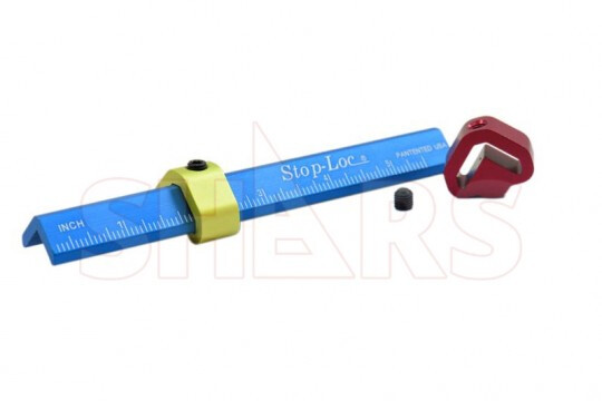

@EdDoherty1 No kidding, I could run any Rocket part 1st Op or 2nd Op with this method. The Hainbach collet chuck provided me .0005" repeatability on Z when I changed from the 1" collet to the 1-1/2" collet. Using the back of the ER collet holders, butting against the face of the collet I still maintained .001" repeatability. So using the different WCS for specific operations, all I had to do was the collet changes and pull up the right program. I used T1212 for 3/8 tap and T1222 for 1/2 tap… Removing and replacing the taps was the most time sensitive aspect and this tool less than a minute. I used the Stop-Loc for all 1st Ops, same length for all parts.
