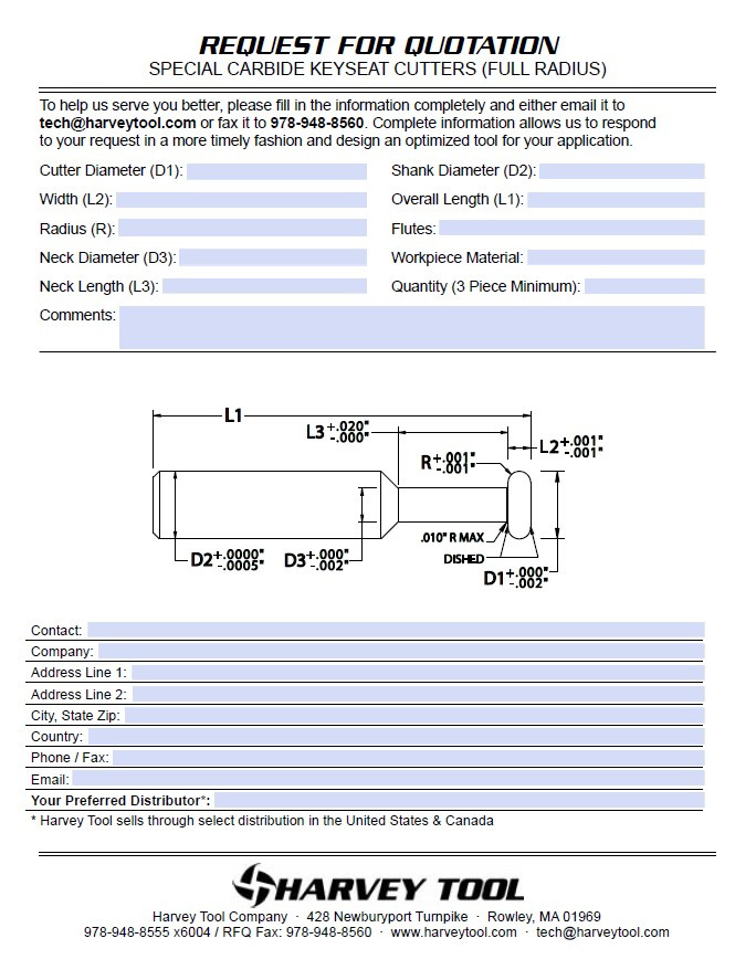

If you are making more than a few, you might consider having a tool ground to shape. It looks like you would need about a 1" shank tool for part shown.,

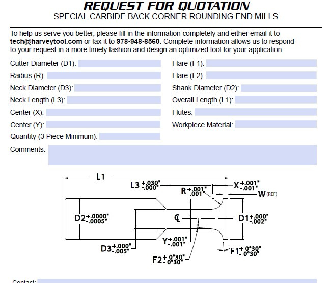

Thank you for the response. Please note that the tool you recommended is for a curvature in the opposite direction. I don’t believe it would work for this application.

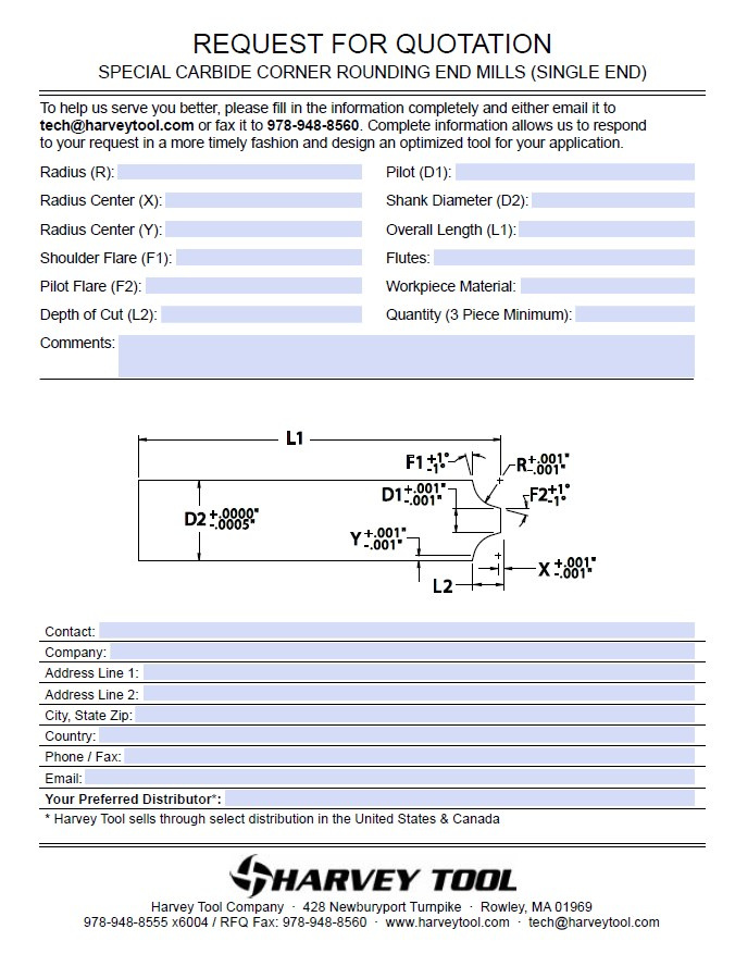

If they can make a back corner radius tool, I bet they can make a tool to machine your form
That is definitely a possible route to take. I will contact them and see what they can make.

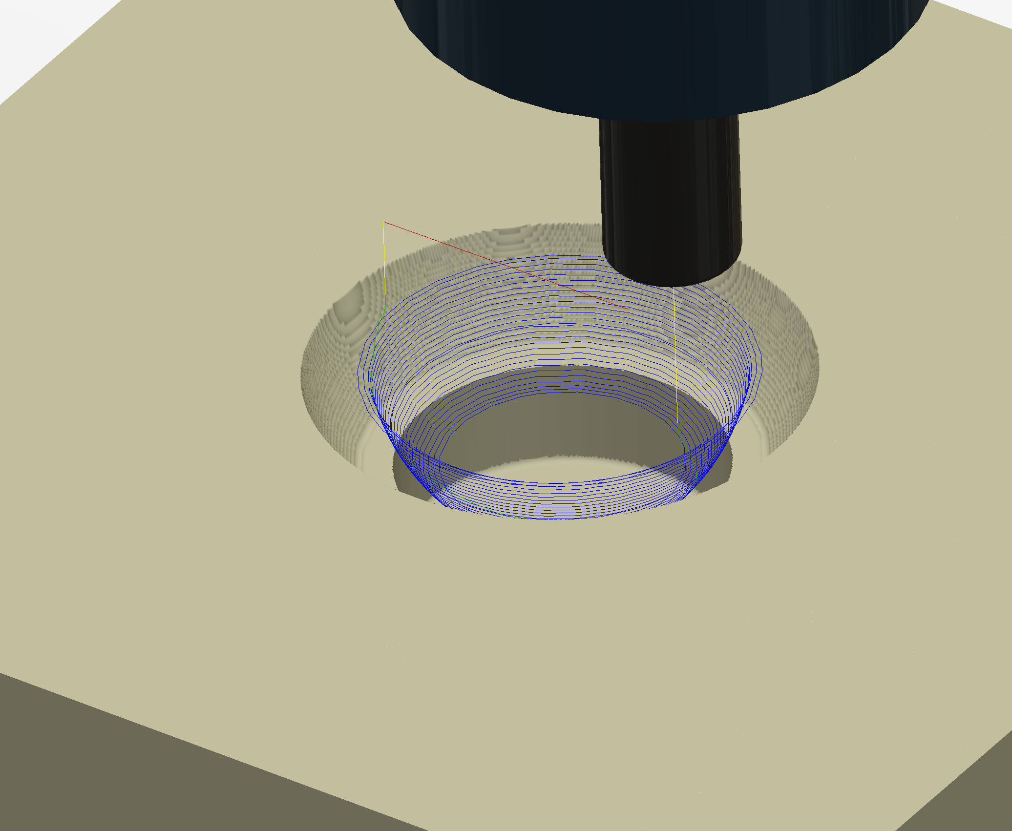

I made my own model just off of what it looked like. this is the scallop tool path I think it would work the best out of the 2 options I mentioned. I guess the problem would be the sharp corner at the bottom of the arc 05%20PM
I was expecting to have to use a different tool for the bottom corner. I’ll try the scallop when I get a chance to see if it cleans up with only 3 axis.

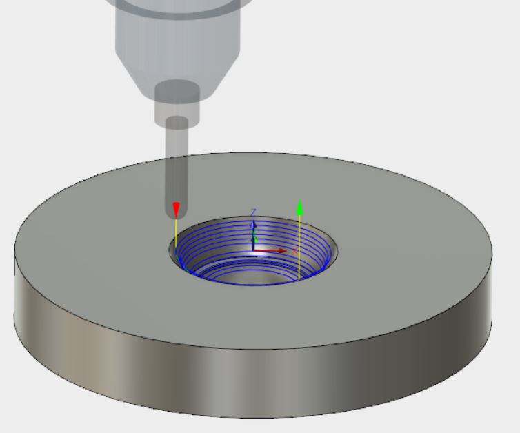

@Billy-Boyce I tried the scallop (see screenshot below). It still seems to want to make the same circular tool paths as with other strategies (which will take forever to clean up) instead of what was shown in your screenshot. Are you using more than 3 axis for yours? Or is there something I should change in the programming? Thanks.
Scallop
The pic I posted was the same thing it just has a lot more times around and yes no 5-axis required. If you wish to go this route maybe a bull nose would be better. Then you could also cut the shelf. If its just a weld grove the fillet at the bottom of the shelf could be cleared with a bevel on the pipe.

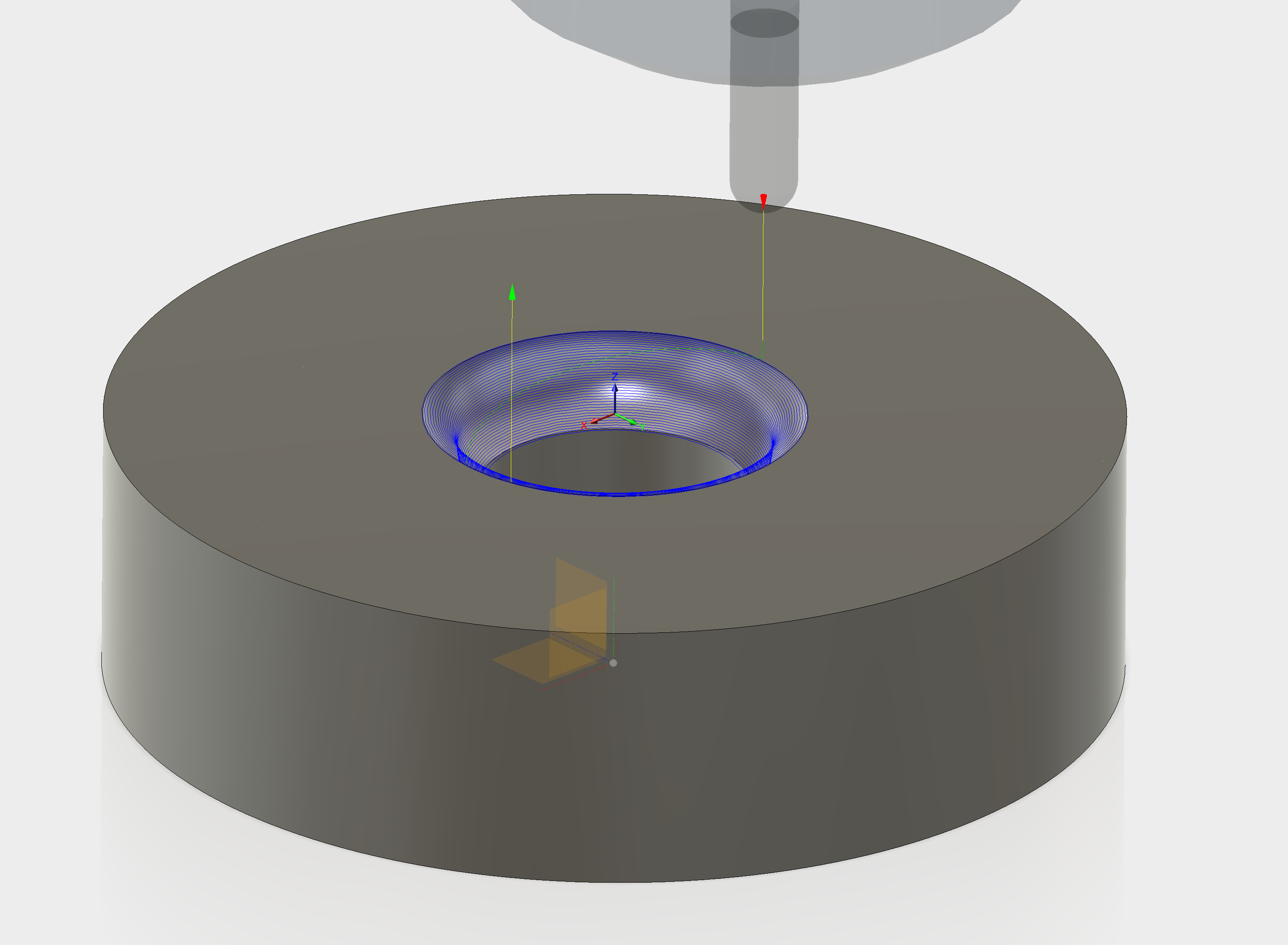

Here try this https://a360.co/2LilkNq has the tool path sample on your part.
18%20AM
Thanks Billy. It’s hard to see exactly how it will clean up. Will have to run a few parts to see for sure.
