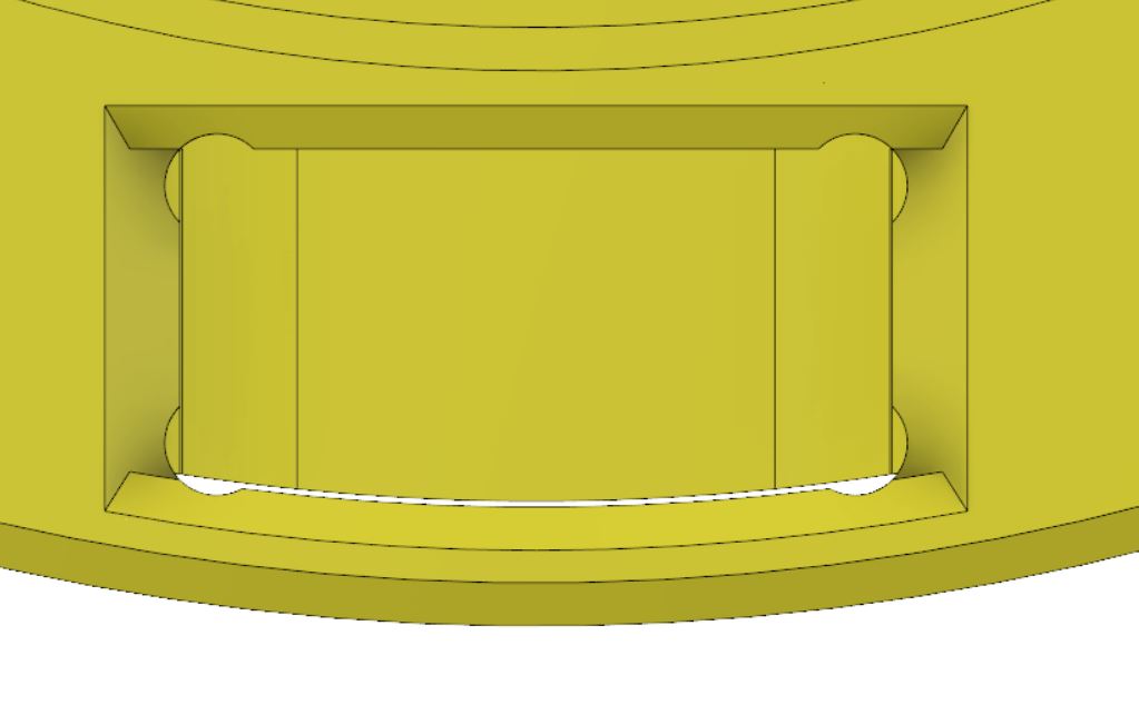

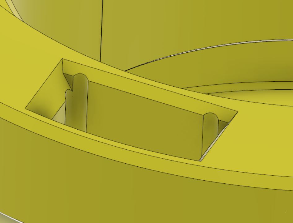

Hello,

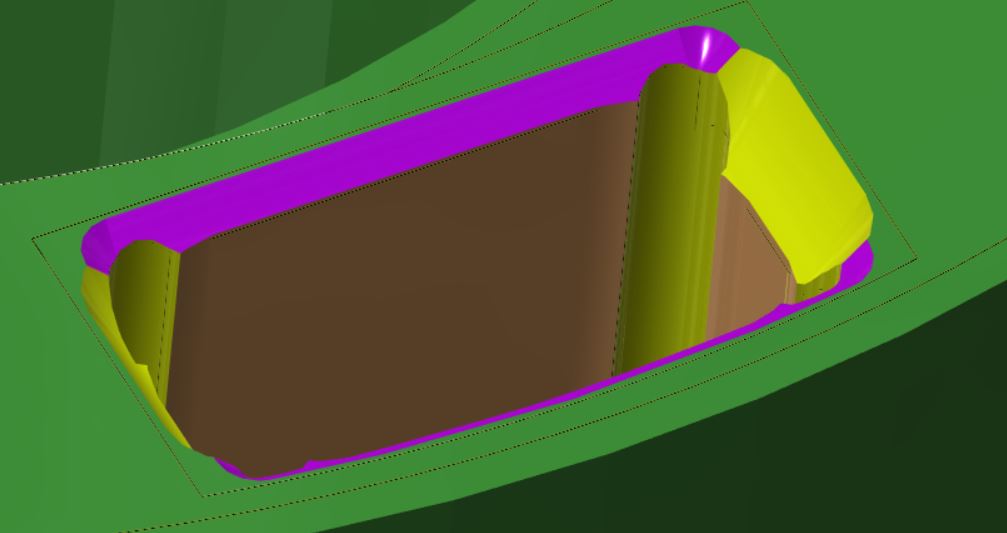

Does anyone have advice for the best milling strategy to use for the internal pocket edge chamfers in the pictures below for Fusion 360? The pocket size is .146" x .323". I already have the main pocket roughed and finished, including pre-drilling the holes in the 4 corners. The long edge chamfers are .02" x 45deg. The short edge chamfers are .060" x 30deg. I also roughed out the chamfers with 90 & 60 deg. chamfer mills (see simulated picture). I just am not sure how to approach finishing the chamfers on the top edges efficiently. I only have 3 axis to work with. Tools available are small ball end mills (1/16" & 3/64"). At first glance I am thinking 2D contour. Thanks in advance!!

If you have to get the sharp corner you would probably either have to tip it or 3d it will a small ball mill.
A round tool can never make a sharp corner. Unless you can run an end mill on a slant (ramp) you really cant get that done with 2.5 axis toolpaths
If you can figure out what is the biggest radius you can get away with in those corners. What i did on something very similar was drop down and use a 0.02" ball nose. It was a tight fitment for holding a part that was having to hold very tight locations for pins to be pressed into it. Surprisingly, worked great and i ran it pretty fast yes it will add to your cycle time. Yet this will be faster than tipping the part “IF” you can get away with a radius in there
