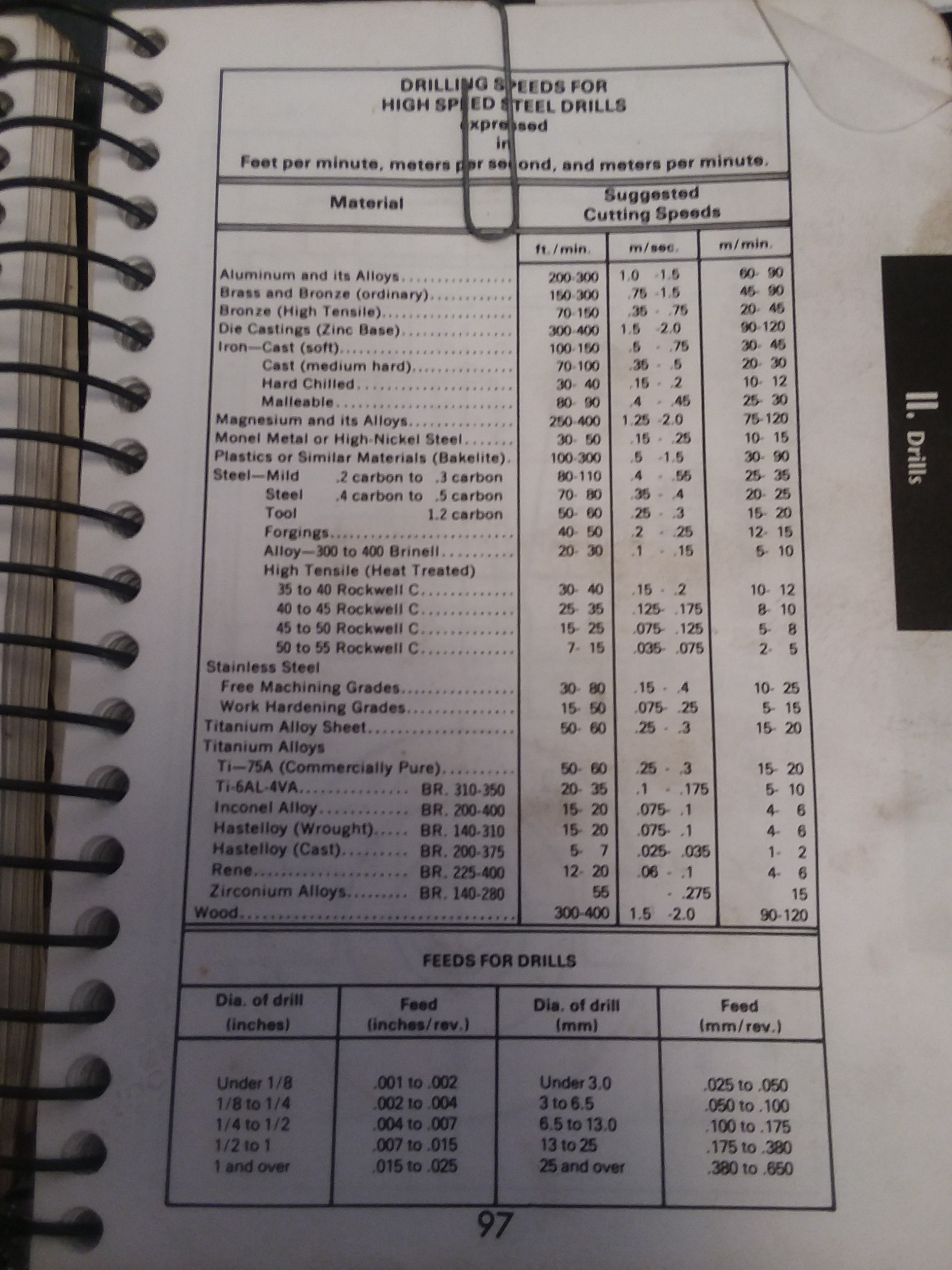

20190407_151239

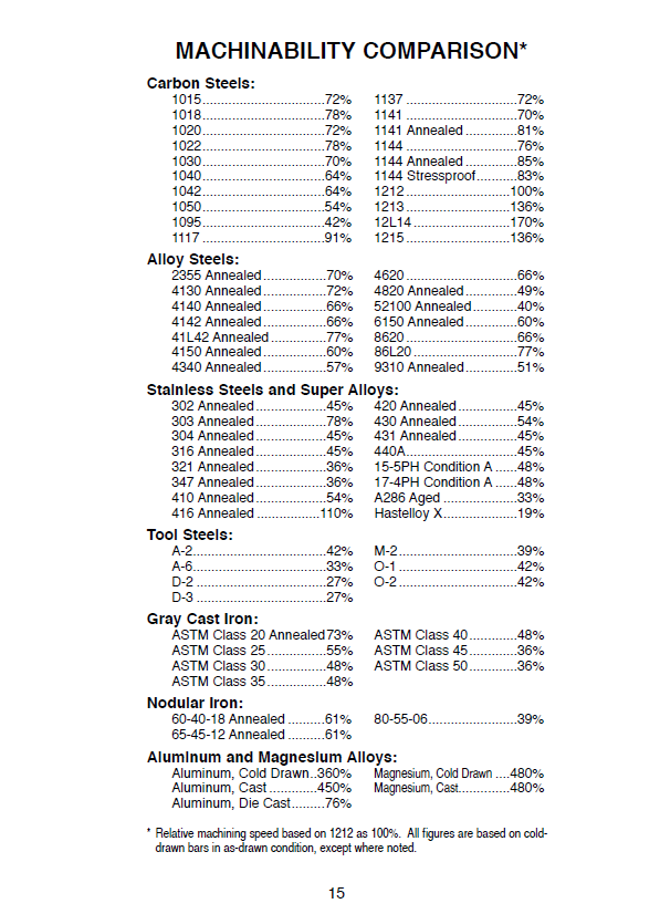

This was out of an old Carr-Lane Trigonometry book.
I’ve seen information like this from material suppliers. Seems a little confusing to me because it doesn’t give a baseline surface feet for the 1212. Am I missing something?
I guess us old guys always understood the baseline to be 100 SFM with HSS cutting tool. So if you used carbide, your SFM would be 300…
