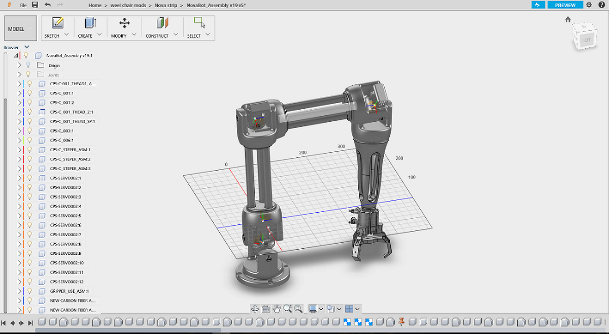

You can open any off your files that you have done on the desktop and make adjustments to them If it’s a full bore parametric model you can change the parameters and it updates ok (internet connection can slow this down).
The pick I just opened in the browser, it’s a big model it only took about 30 secs to load up from the US to NZ thats quite good for speed.
