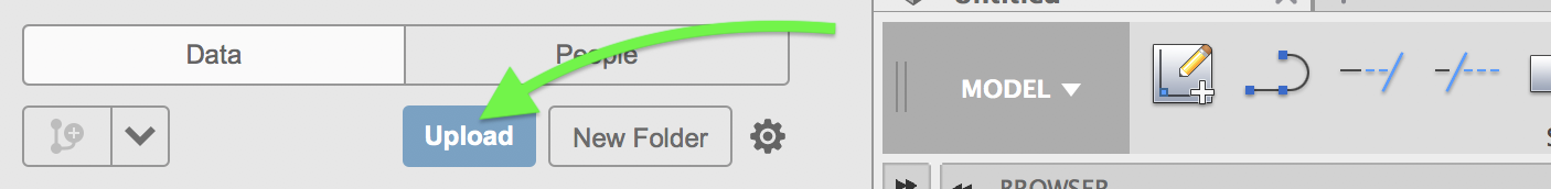

Hello I have no idea if Fusion 360 will open Creo .prt1 solid model drawings. If so how do you do it?
Thank you
What solids can Fusion open?
Fusion does pretty good at opening lots of other cad formats. Just load the file into Fusion using the Upload button located close to the top left hand side. Some files will then need to be made into a fusion job just right click it and create a fusion file .

hi @Rumpelstiltskin,
As @Billy-Boyce said Fusion is very good with taking in other CAD formats and in answer to your other question Yes. Fusion will take .prt files directly into Fusion using the Upload function as @Billy-Boyce stated above here is the full list of which formats Fusion will directly upload.

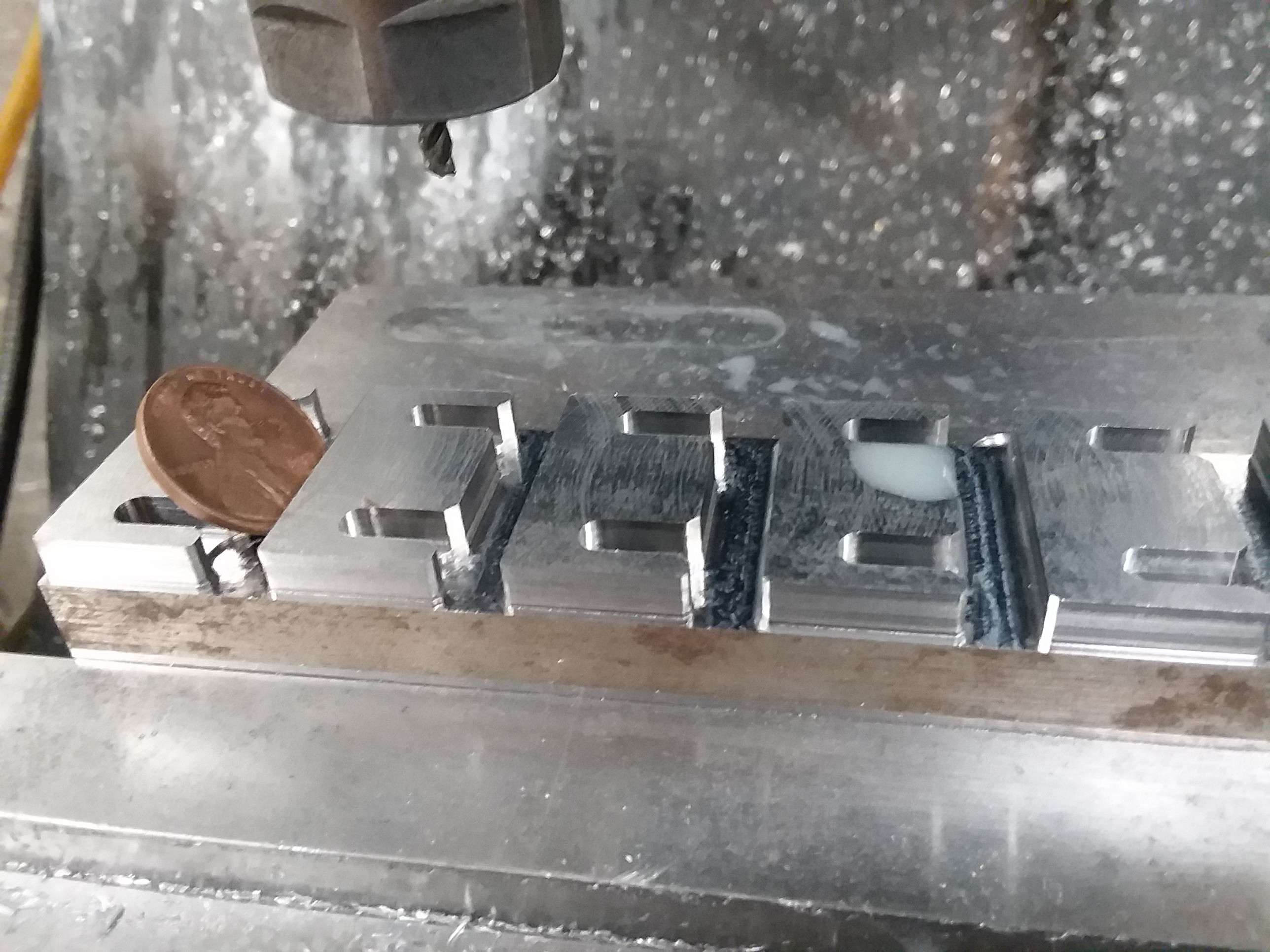

15185437454321120306609This will be the first Fusion 360 code I run on my mill. I’m totally stoked!

1518554585389-655911089It turned out great. I grabbed an old 1/8 endmill that already had one flute broke to use. Thought I would break it right off. Not the case she made it thrue. Thanks @SeanIsle & @Billy-Boyce .

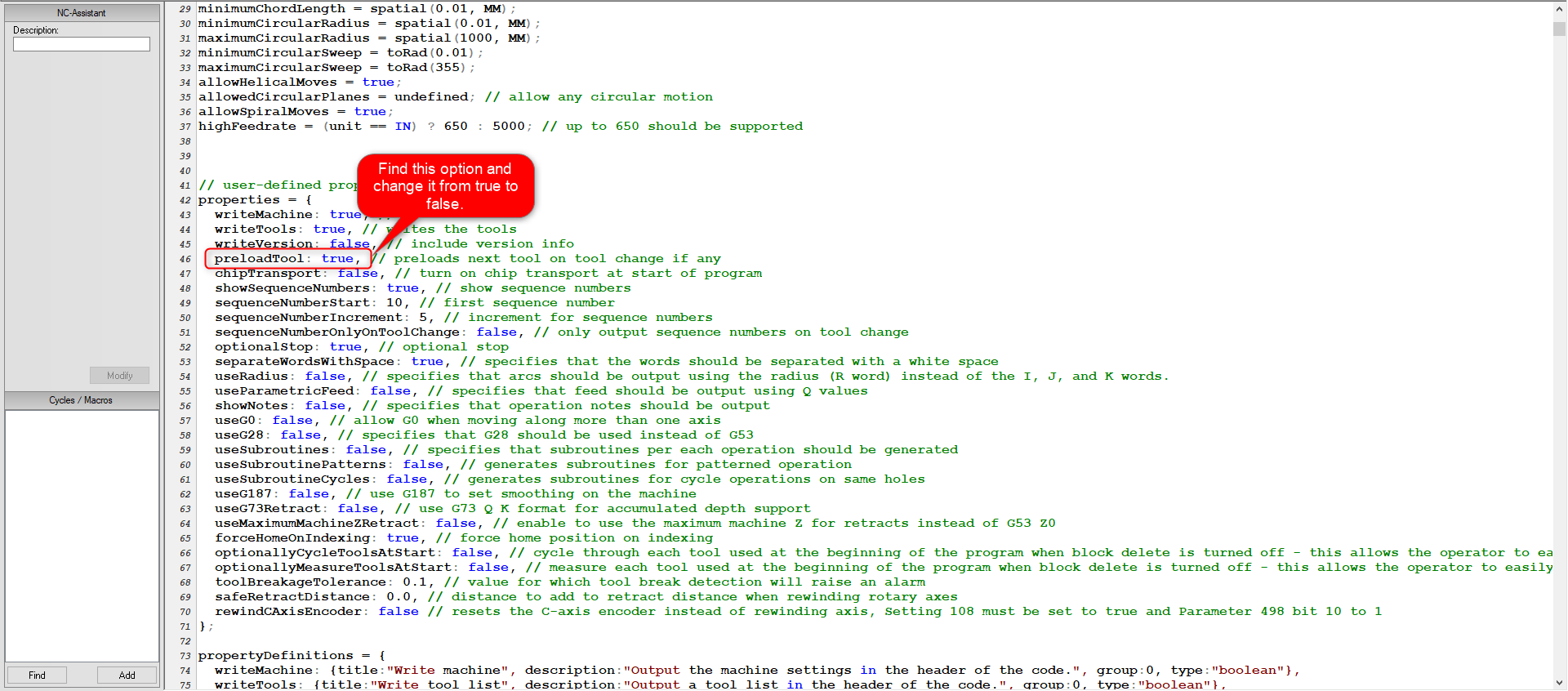

I only had issues with the post adding a T3 after a tool change to T2 but caught it and edited out on the control.

The T3 is tool preselect in the post.
To stop it…

I found out that the belts on my Router needed tightening hahaha. Ended up with some very oblong holes when it did some magnet pockets. Second run today.
Well eggs are good for breakfast but not that great on parts. I hope it works better today.

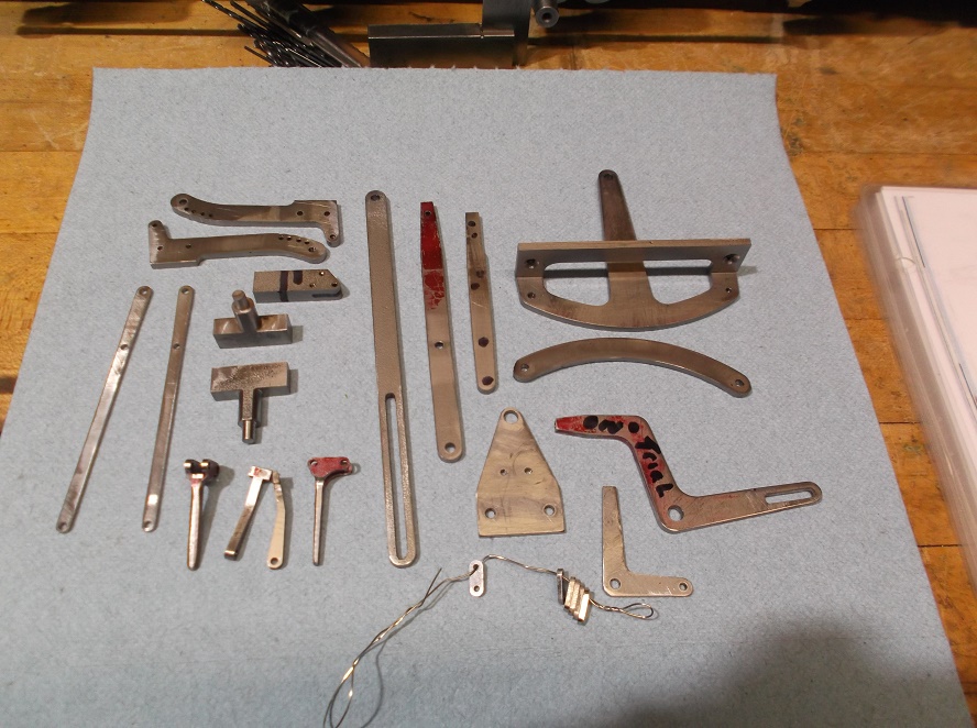

Well I have learned to use Fusion 360 .Here are a few of the parts I have made .This is just 2D Now the next thing will be 3D Thanks to you Titan I was able to do this by follow you along on the M1 project so I owe all the thanks to you and your programs .Many Thanks DaleDSCF2739|670x500
DSCF2739
Those are some great looking parts.
Thank You. Very simple but a start!
