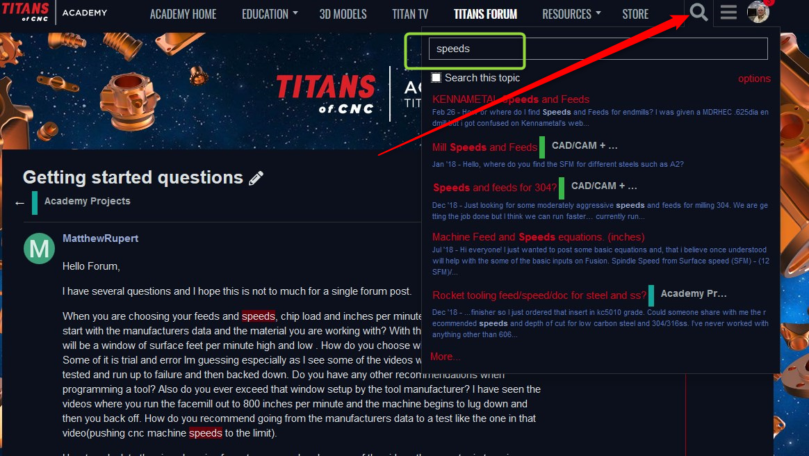

@MatthewRupert I feel you have too many questions in this one topic, most of questions have answers in the forum. Use the search function. image
