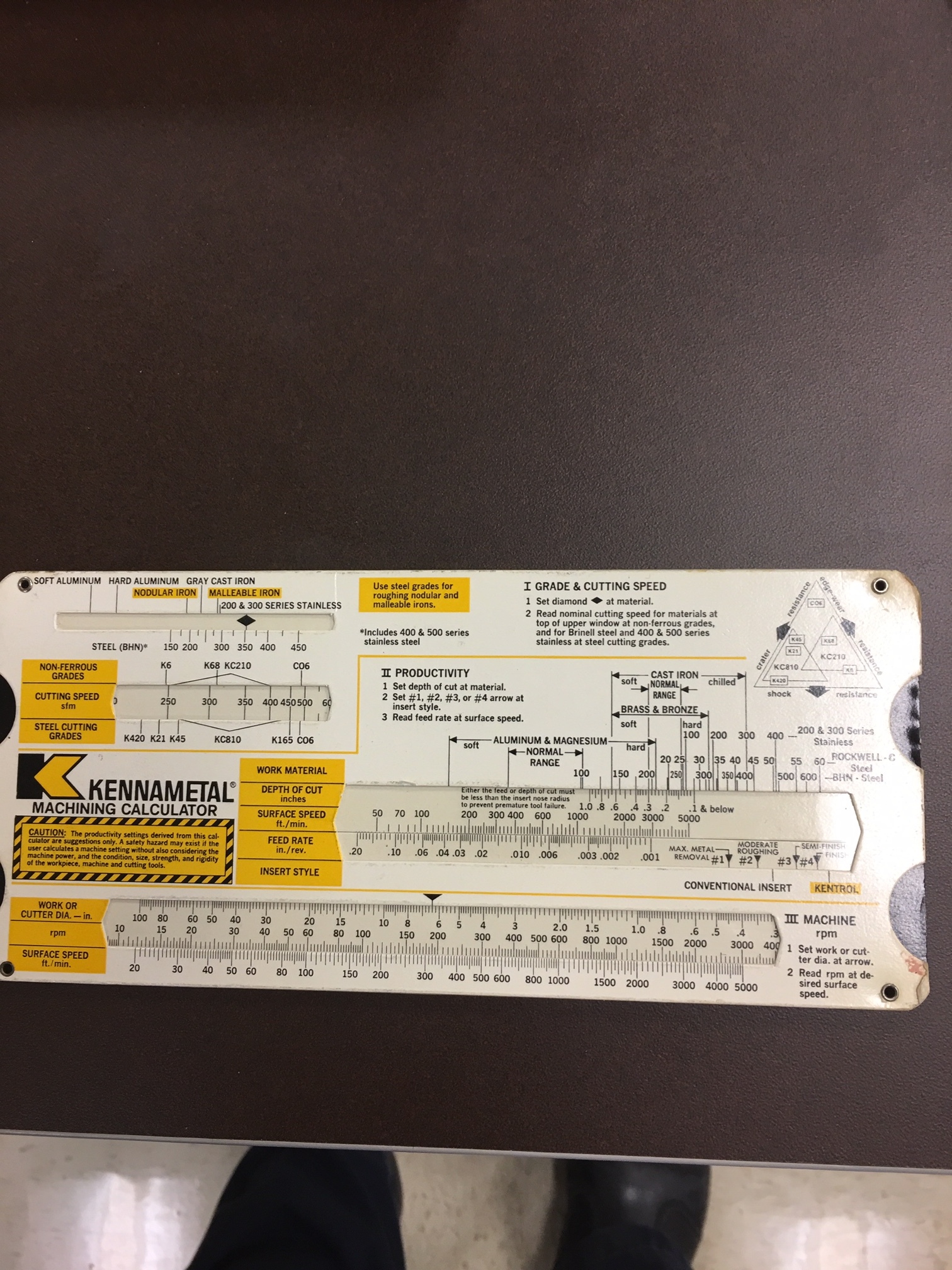

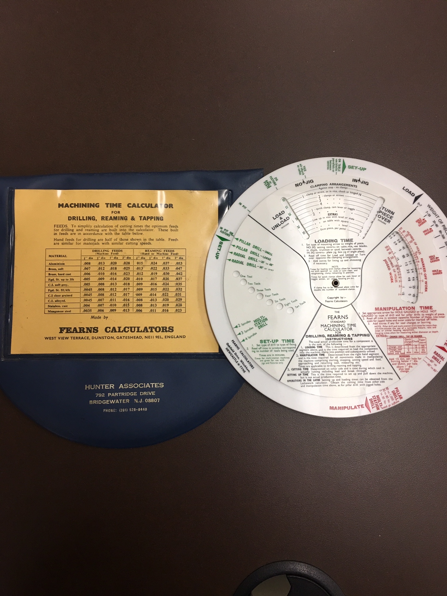

Many years ago, right after inserted carbide cutters were readily available and cemented tooling was slowly disappearing, we used slide or rotary calculators to determine RPM and feed rates. I found these two in my collection of useless nor longer used junk. As machinists we all had a slide calculator calculator in our toolbox,
but our programmer/estimator had the rotary calculator to determine quoted price per unit.
