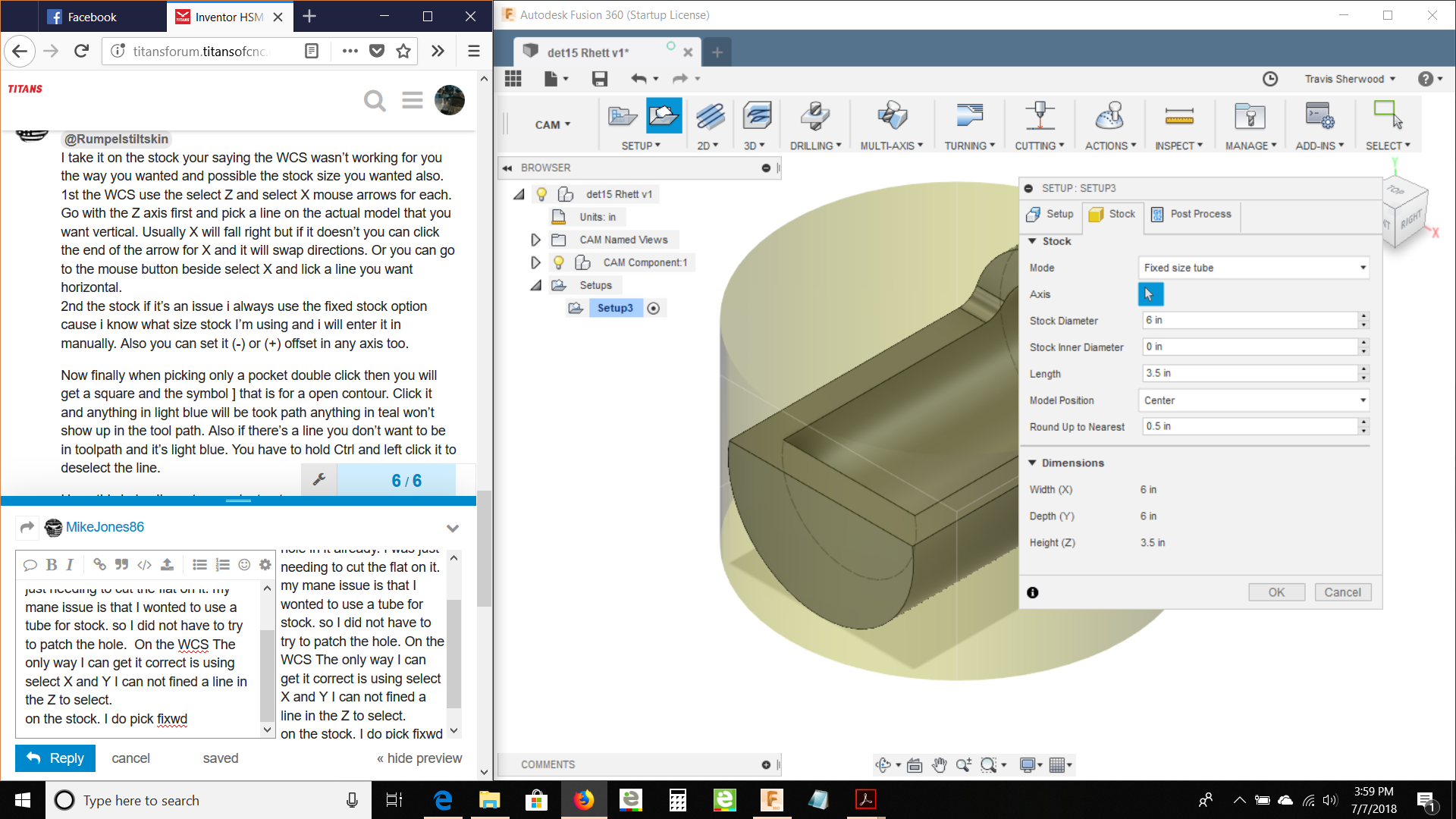

This is a problem I had the other night I could not get the stock to go right. I ended up programing it my hand at the control. any help would be great.
@MikeJones86Screenshot%20(106)Screenshot%20(107)

I take it on the stock your saying the WCS wasn’t working for you the way you wanted and possible the stock size you wanted also.
1st the WCS use the select Z and select X mouse arrows for each. Go with the Z axis first and pick a line on the actual model that you want vertical. Usually X will fall right but if it doesn’t you can click the end of the arrow for X and it will swap directions. Or you can go to the mouse button beside select X and lick a line you want horizontal.
2nd the stock if it’s an issue i always use the fixed stock option cause i know what size stock I’m using and i will enter it in manually. Also you can set it (-) or (+) offset in any axis too.
Now finally when picking only a pocket double click then you will get a square and the symbol ] that is for a open contour. Click it and anything in light blue will be took path anything in teal won’t show up in the tool path. Also if there’s a line you don’t want to be in toolpath and it’s light blue. You have to hold Ctrl and left click it to deselect the line.

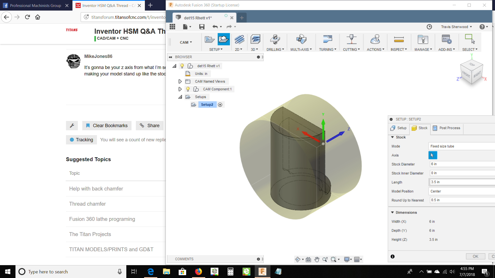

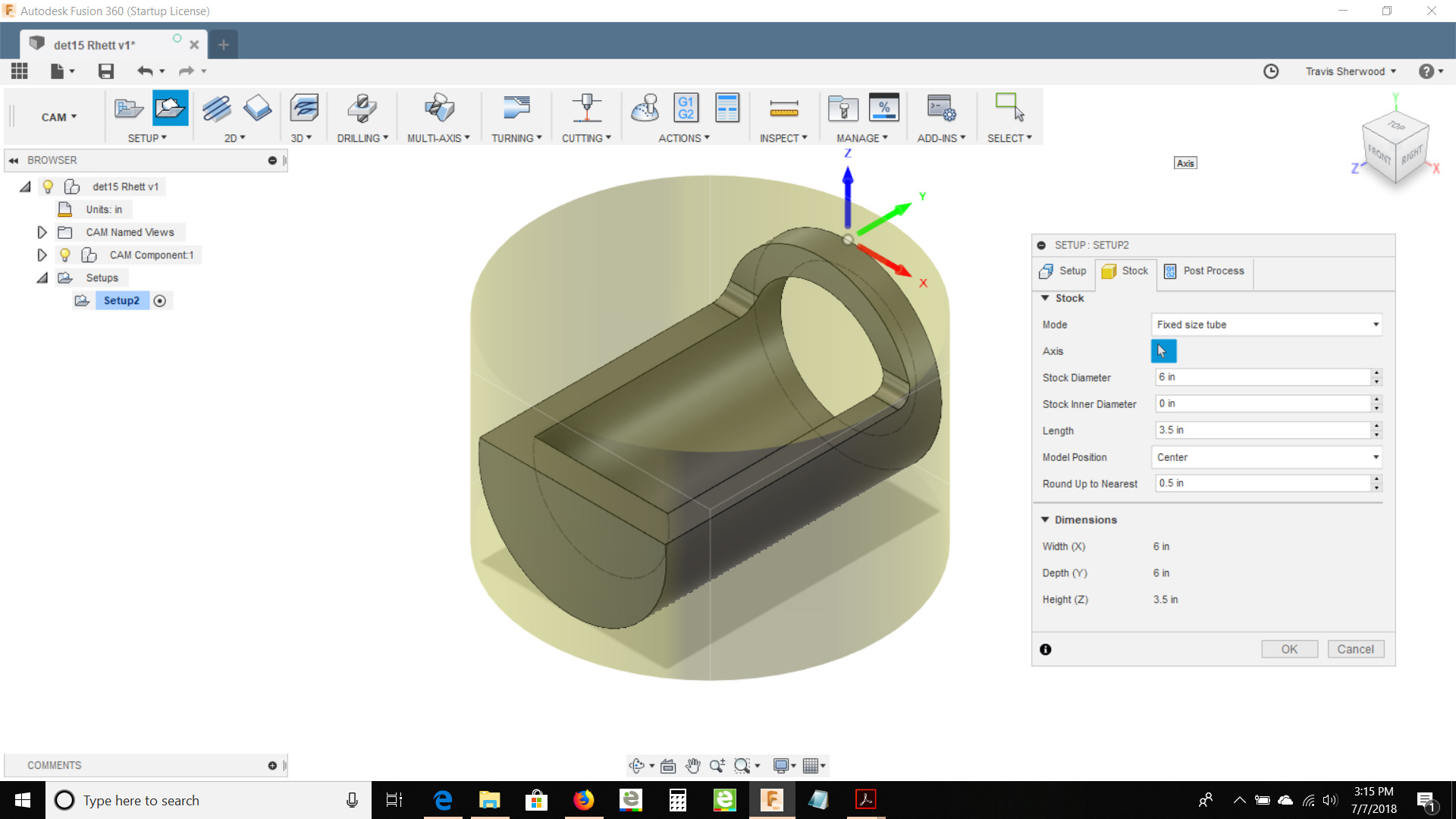

@MikeJones86 Thank you !!! This is a turned part that has the hole in it already. I was just needing to cut the flat on it. my mane issue is that I wanted to use a tube for stock. so I did not have to try to patch the hole. On the WCS The only way I can get it correct is using select X and Y I can not fined a line in the Z to select.
On the stock. I do pick fixed size tube but it is flipped in the wrong direction.
I can get then stock right but the WCS is wrong if i flip the WCS the stock flips.
ThankYOU!!!
Screenshot%20(108)!Screenshot%20(110)
It’s gonna be your z axis from what I’m seeing. I haven’t messed a lot with tube stock. Another thing to try is try making your model stand up like the stock wants to stand. Then try setting your WCS

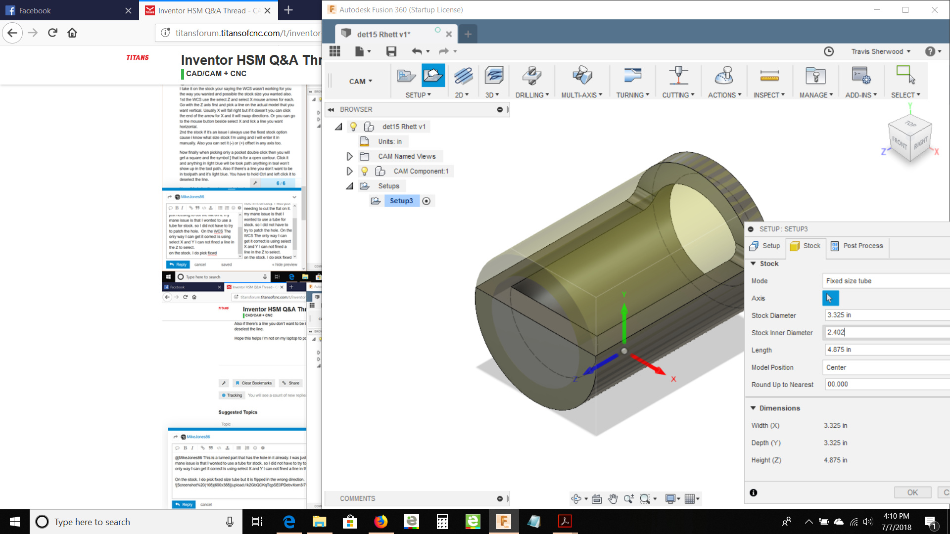

The stock is tied to the WCS I Guess I rotated the part and that did not help.
the Tube works just like the cylinder.
I do thank you thew.
I will throw it up on Face book and see if some one has the answer.
Screenshot%20(111)
Do you want your stock in that orientation or in the orientation of your part model. To me your z is off if mill that part
That is the root of the problem whenever I would switch Z the way I needed it stock and turn would rotate. @DanielLyall made the video below on how to correct the issue. Thanks to all, for your time and help

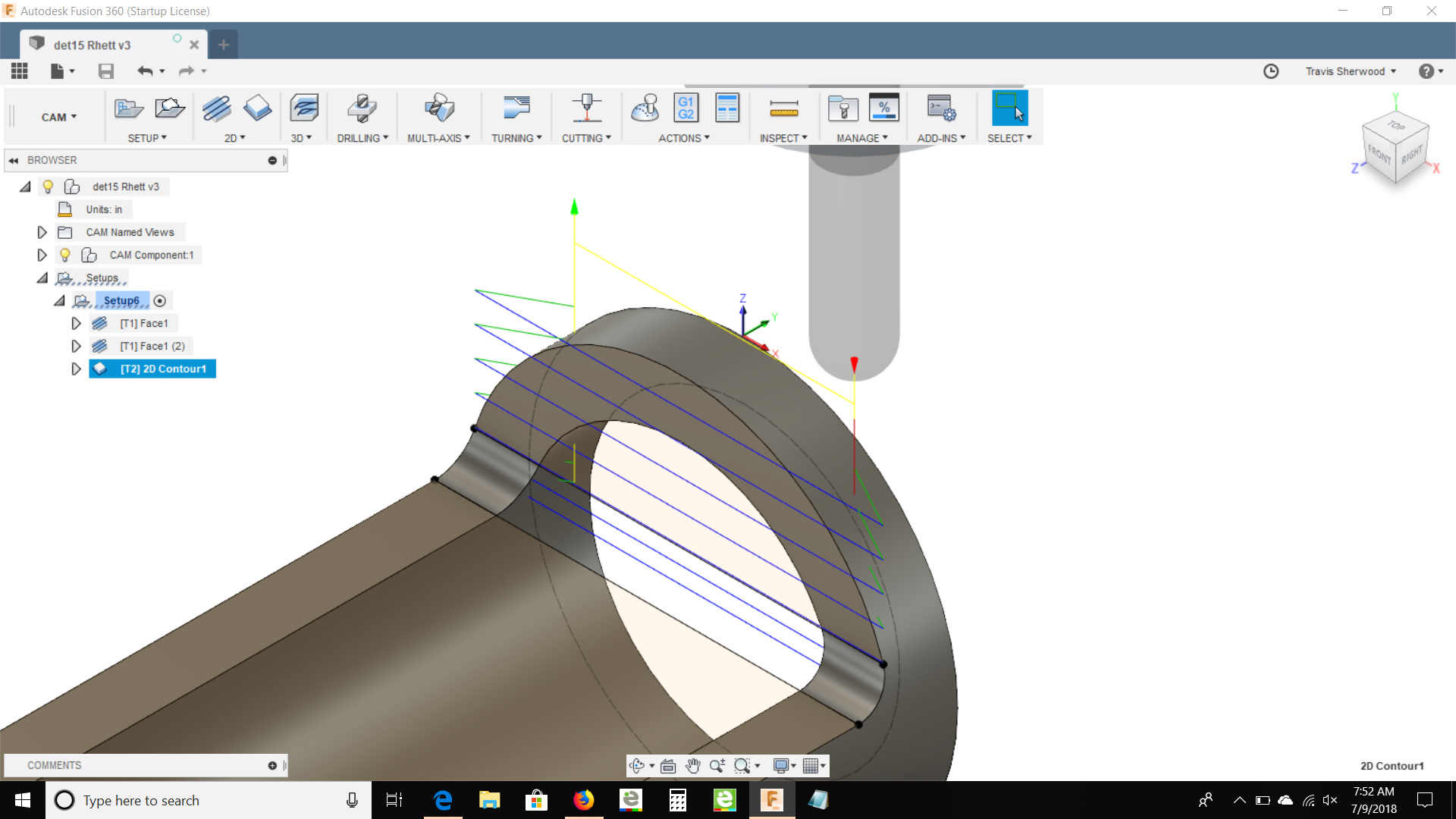

Help please !!
I have gotten the stock all lined out but for some reason when I do a contour with my ball mill.the lead in angle is right threw the part.I have tried changing the angle but it just frustrates me doing the wrong thing.

Ok the way I fix this Oh don’t mind the numbers in the boxes
Horz. Lead in Radius - 0
Lead in sweep angle - 0
Linear lead in distance - I usually do just a little over half the tool radius EX 1/2 tool I do like 0.3
You can do Perpendicular if its needed depending on part
Vertical Lead in Radius- I hardly use this on in tight spots

If you wanted to use a tube for the stock, keep in mind you can actually draw anything you would like to represent the stock (in Inventor, I assume Fusion is the same). You are not limited to just the default pop-up selections. This is helpful with multiple ops, as you can use the partially completed part to accurately represent the next op. -Robert
