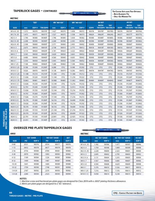

This a chart of your thread sizes and the pre-drill hole sizes I have this exact chart posted on the wall of my shop, it helps with the day to day of remembering all the different holes required, these charts are pretty easily acquired by googling them and they are available in both Freedoms (Imperial) and Communist units (Metric)
Thanks this will really help me.
