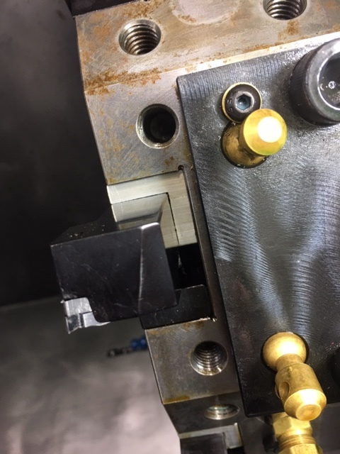

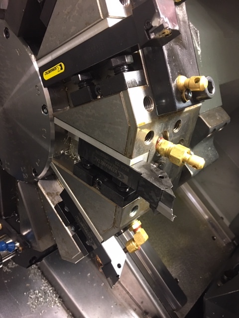

Well, one of my students changed out a spacer to position my 3/4 shank tool to a 1" shank tool. The spacer was .005" short of .250 thick. Swapped the legs of the spacer, and now my tools are all synced up… It was something very simple and basic. I did not know they had taken the spacer out. :smiley:titan%201 Titan%202
Are those something you made in class or purchased?
We made in class. one spacer had .245" thick leg out of 24 spacers made, of course the one spacer that was undersize was the one that was swapped
