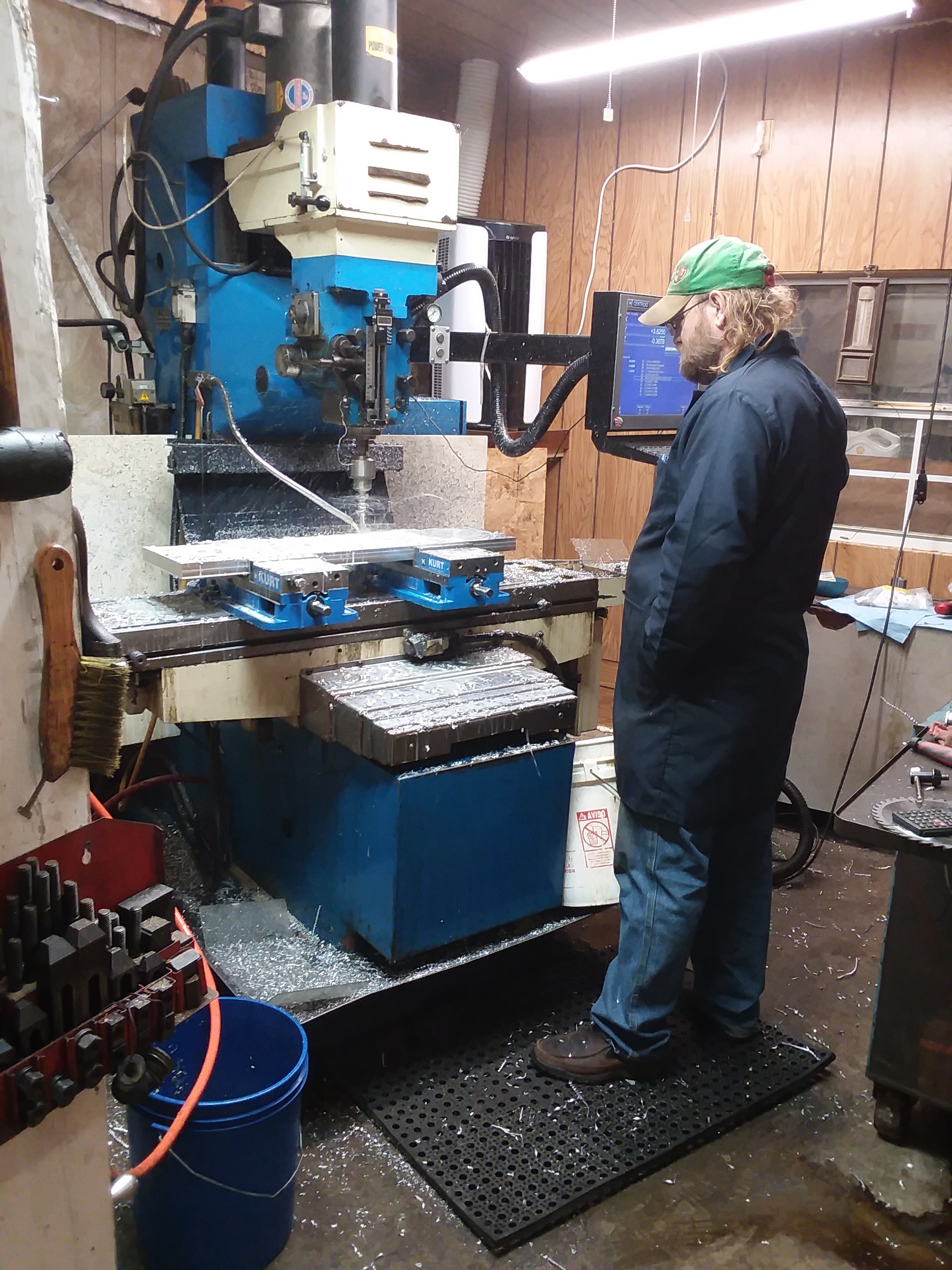

It sorta helps…I need to wrap my mind around Automatic Tool change vs what I currently have to do which is Fast Tool Change. I have my tools lined up how I will use them…My machine pauses, request a tool-change…I manually make the change and it touches off against a known hard surface to determine the Z travel distance. Because I am not a production shop I use the Fusion Setup Feature to print out the list of tools/operations. It’s very slow and tedious and definitely not something I would want to do in a more-than-one or many environment when tolerances and accuracy is imperative.
20181023_085643
No tool changer for me eather.
You would be surprised. I have a friend just bought a 80k mill and tool off the tool setter to make room on the table to make parts.
Mine is much more basic even than that. I basically have a CNC router but the same principles apply…Most of what I am doing these days is not a 4’ x 8’ sheet of Richlite but instead aluminium. I am jones-ing for a Hass Mini Mill as it will be a much better fit for the operations.
