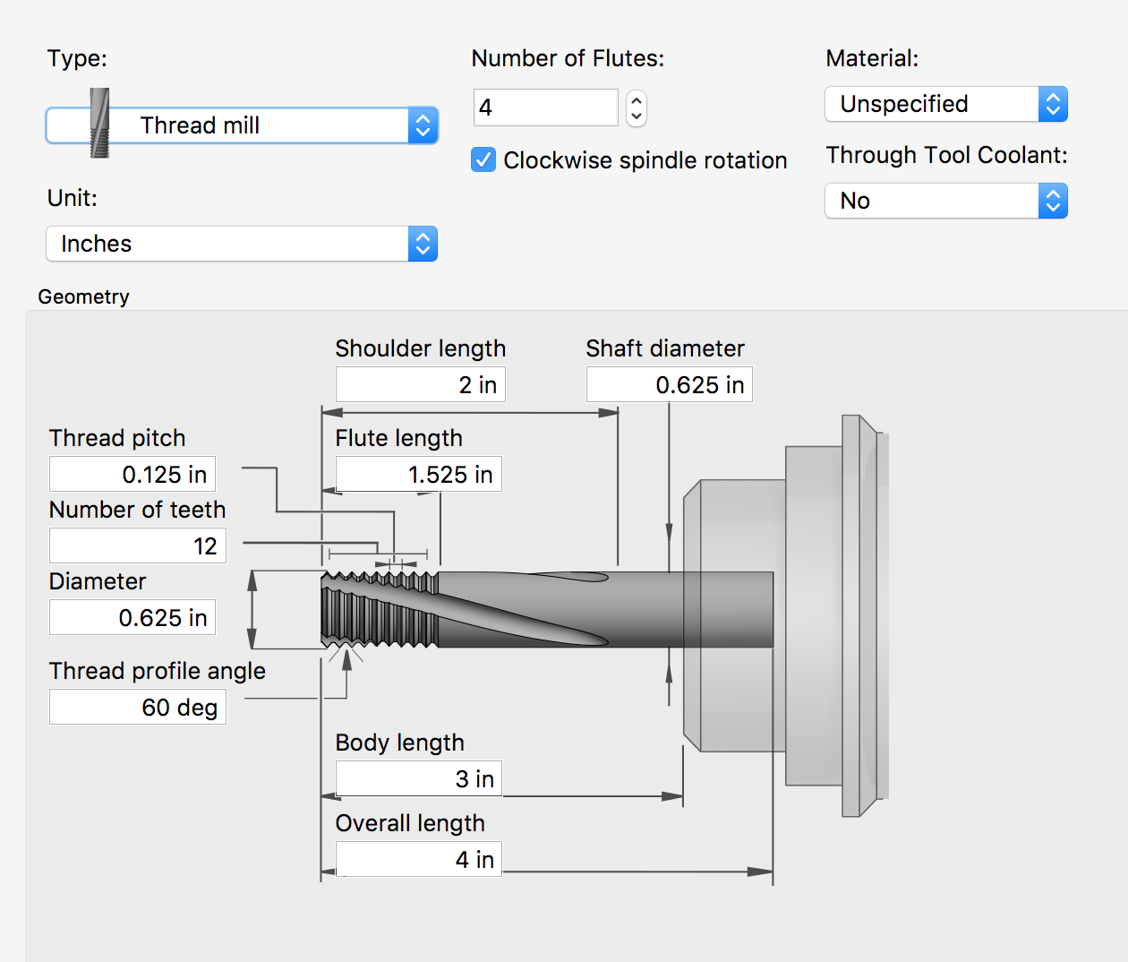

Found this 5593181 Kennametal, but not sure how to program it…or even
https://www.mscdirect.com/product/details/76418292...from above…
so how many holes can I do with this one? @JimDawson
Most likely hundreds of holes if everything is working correctly, depending on the material you’re working with. You normally use your CAM program to generate the G code. You should have an option for thread milling.

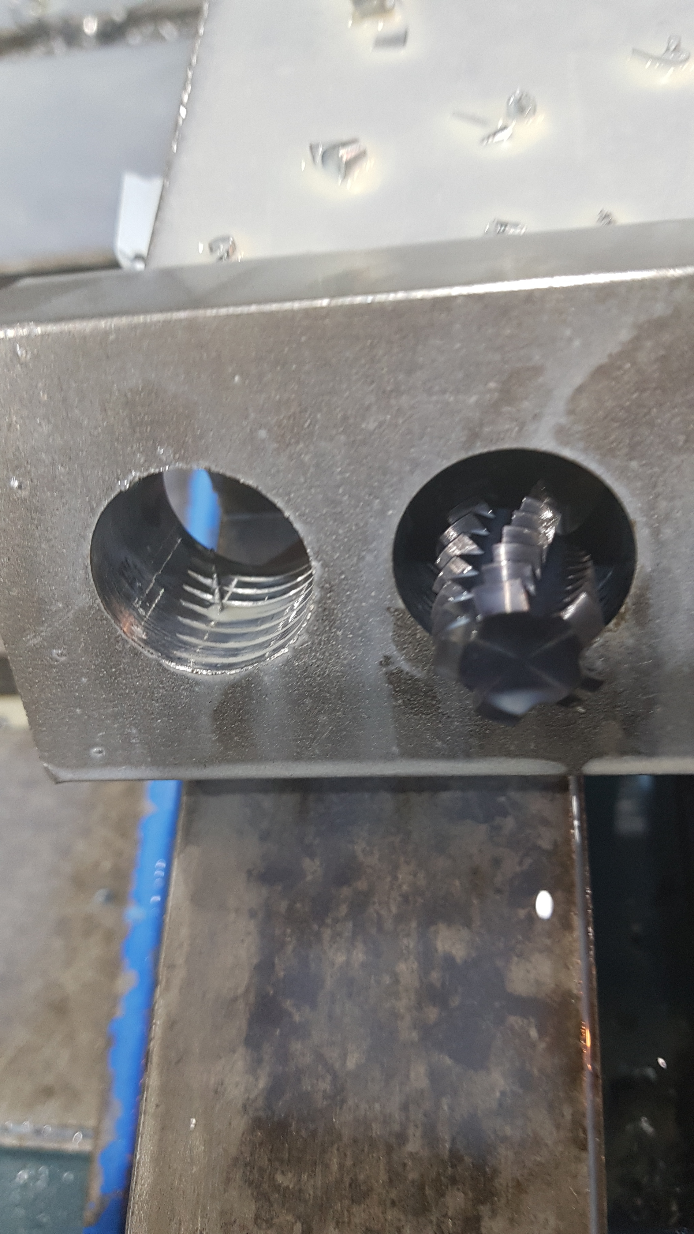

WHAT HAPPENED, Used a col-let holder for the Morse 1-8 thread mill…and broke, did not even make a single thread…20200323_190728

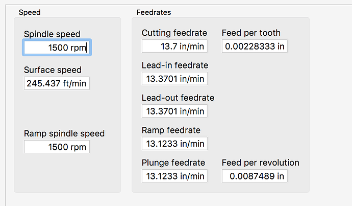

Hello,
You’re running at 39.4. You should have it running at 13.7.
LD

Hello,
Lead-in and Lead-out are better now.

so this is running on an old milling machine with just low pressure flush… what do you think about the rpm…? Is it ok to use a collet er20 to hold this Morse threading tool…? THANK YOU…
HI, I have been using “stock to leave” to slowly increase the thread size, is that the correct way to do it?
So if this thread is to small, use a negative stock to leave…?
Yes, that is the way I make minor adjustments to hole sizes.
hi, I am now using this tool
https://www.iscar.com/Ecatalog/Item.aspx?cat=5603885&fnum=1650&mapp=TH&GFSTYP=M&srch=1
running at 1200 rpm and feed at 2 inches per min…(I can set at Machine,) anything faster it sounds rough…this seems slow to me?. Also using wear as an offset adjustment at machine to adjust size of
thread, this works nice…
The feed does seem slow, but if the tool and the machine sound happy, then I think it’s OK. You are removing a lot of material with that tool.
