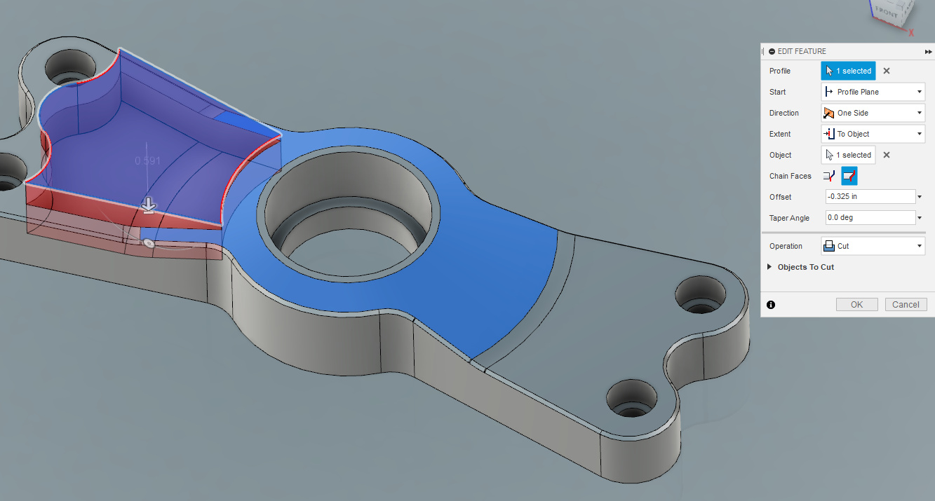

i need help making the pocket, i follow the video exactly but it comes up with an error every time i press pull. what is “tool body creation failed”
Do you have the second option for chained faces checked? If that doesnt work maybe try creating a screencast video to show us exactly what you are doing. Attached is a screenshot of the settings that worked for me. Hope this helps image
Billy Boyce and I both shared some videos on how to do this. Need some help with titan-57m
THANK YOU! it worked!! it was the chain faces feature… dont know why i didn’t try that… thanks again man. much love from Ontario Canada
