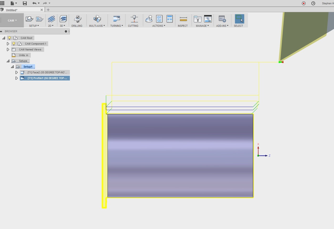

20180319_165101_Film3~2
It’s the moves in the upper right. As it finishes the facing it goes up out of the way then comes down and does the OD profile then goes up out of the way then does the final profile. I hope this helps. I’ve edited the post processing to eliminate those moves especially since it’s the same tool but I’m not sure why the inventor writes them that way. Thanks for any help!

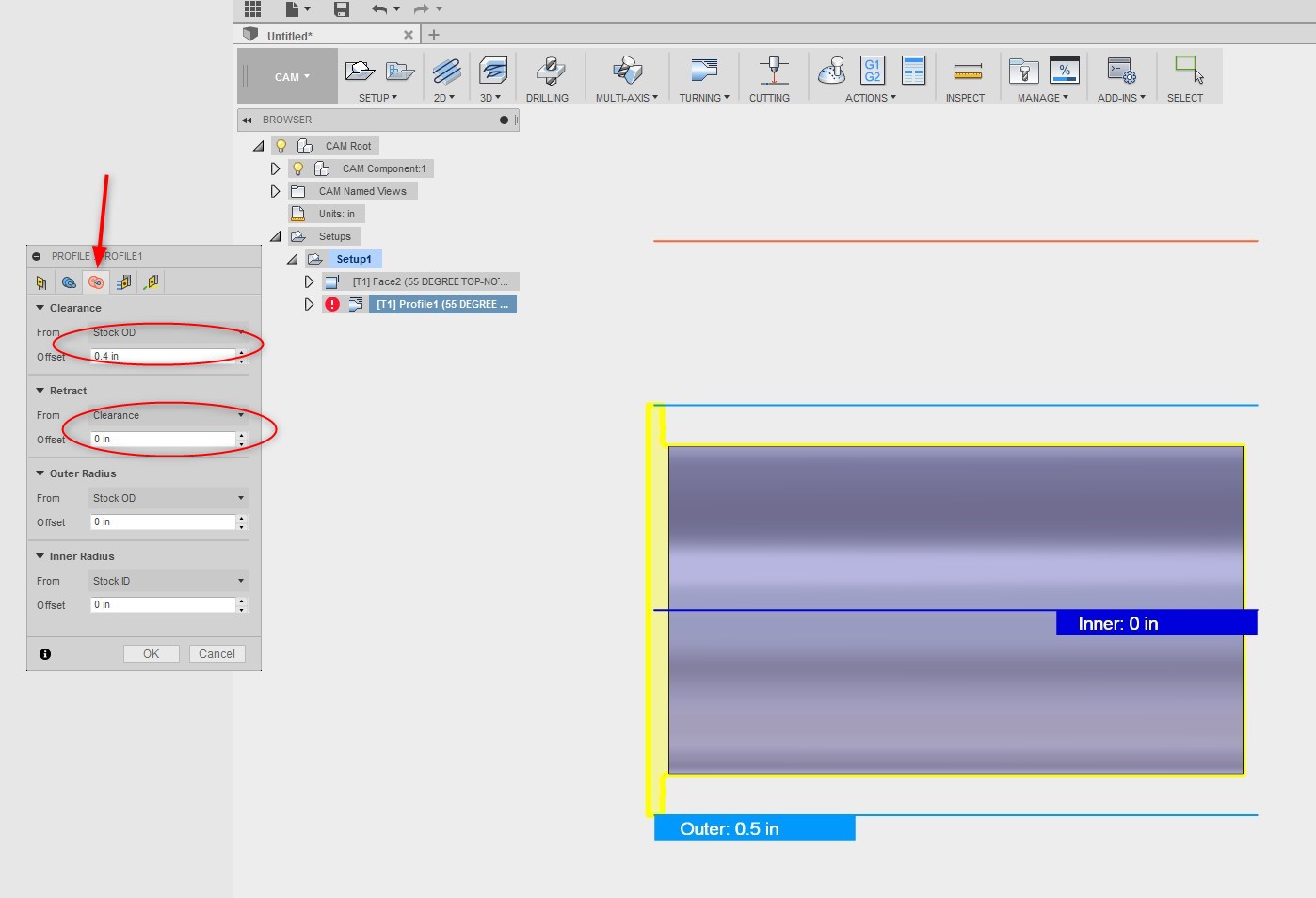

After you selected what type of operation you are going to process (face, profile, etc.) in the radii tab you can specify your clearance values. You may want to select stock top for initial cuts and further into the turning processes you might select model top. I would play with the different values and selections and note where your tool starts, where it retracts to . I hope this answers your question.

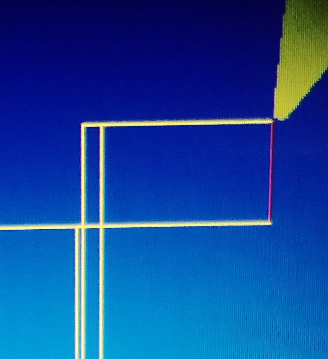

The values I had in my box created the following tool path retract locations.
change%20clearance%20values%202
I have my clearance set for 0.200 above stock top and my retract set at 0.080 above model top usually. I get good tool paths until I go to another process with the same tool then I get the tool wanting to return to machine home. I’m waiting for a callback from Autodesk to see what we can figure out. Thanks for trying to help It’s very highly appreciated!!

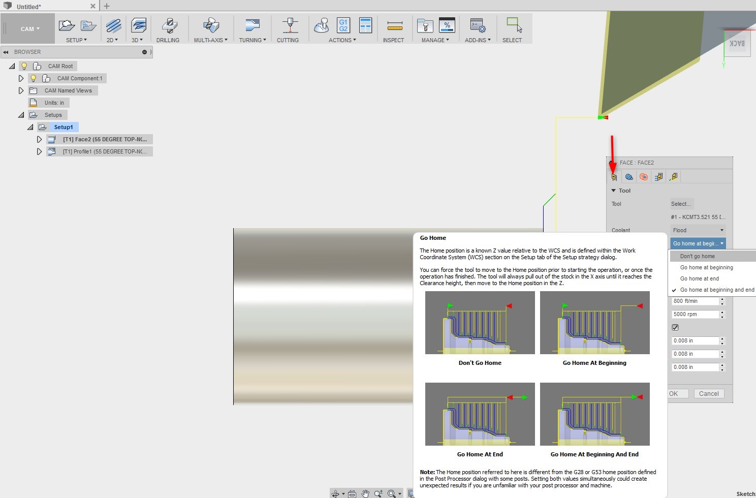

When you select the tool and the next process is using the same tool, tell it to not go home.
change%20clearance%20values%203
It’s the same cam…
I do tell them not to go home but it does that anyway. Lol
