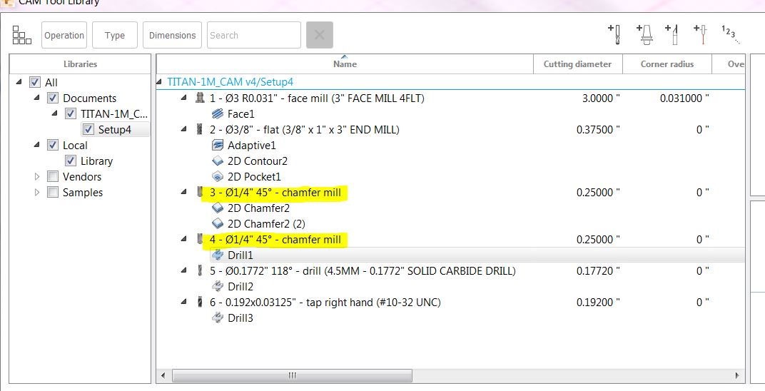

For some reason I am getting a duplication in my tool list for the 1/4" chamfer mill
The software is not combining these three operations that use the same tool
Return to you CAM screen and pick the process where you are chamfering the tapped holes, edit tool and choose #3 tool.
Then right click on Tool #5 (.177 drill) in your tooling list and change it to Tool#4
Repeat for tap and change it to Tool#5
I was able to manually change the numbering, thanks
