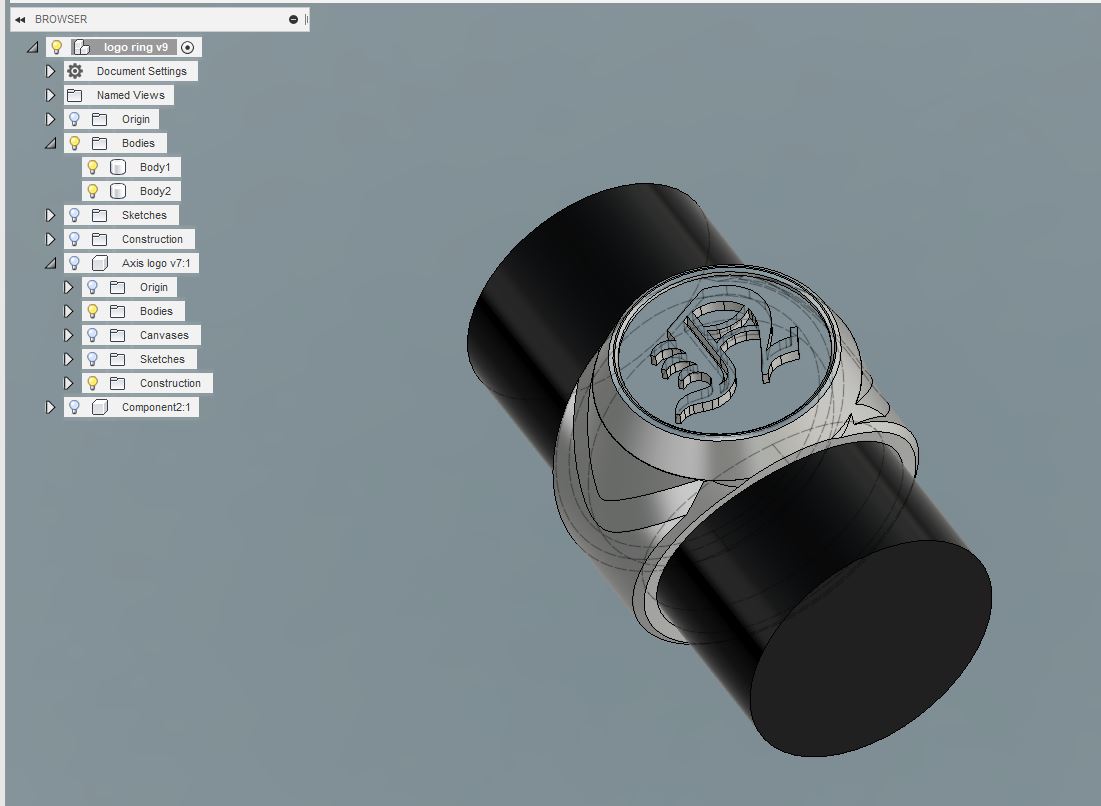

I was pretty sure when I viewed the tutorial, the bottom of the pocket was a curved face and not a flat face, it may have been the part 2 video of the same tutorial that actually showed more of a simultaneous movements.
The bottom Bottom of the pocket was curved. and the is the only way to get the angle on the wall by rotating it. I cut ring patterens in wax on my bench top mill and I have not found a way in fusion to cut 360 degrees and do 3d cutting also. Yeah I can 2d cut all day on the 4th axis. and from all the research I have done I would have to goto Inventor to do what I want.
If you know of a way to do this I would really. I attached Ia Picture of what I would like to cut. other Wise I have to find someone with a seat of Mastercam I can use.
What machine are your running this on? Lathe with Y axis or 3 axis mill with horizontal A axis?
Taig mill with a axiz running mach3

I have zero spare time this coming week, but will see what I can muster on the ring part you imaged. I will need some quality quiet time to work on this :smiley:
Well thanks I have thought of trying 3d cutting and just index it 15 degree ingriments I but I think on my machine Tere could be a line up issue.
It is only steppers and thead rod
