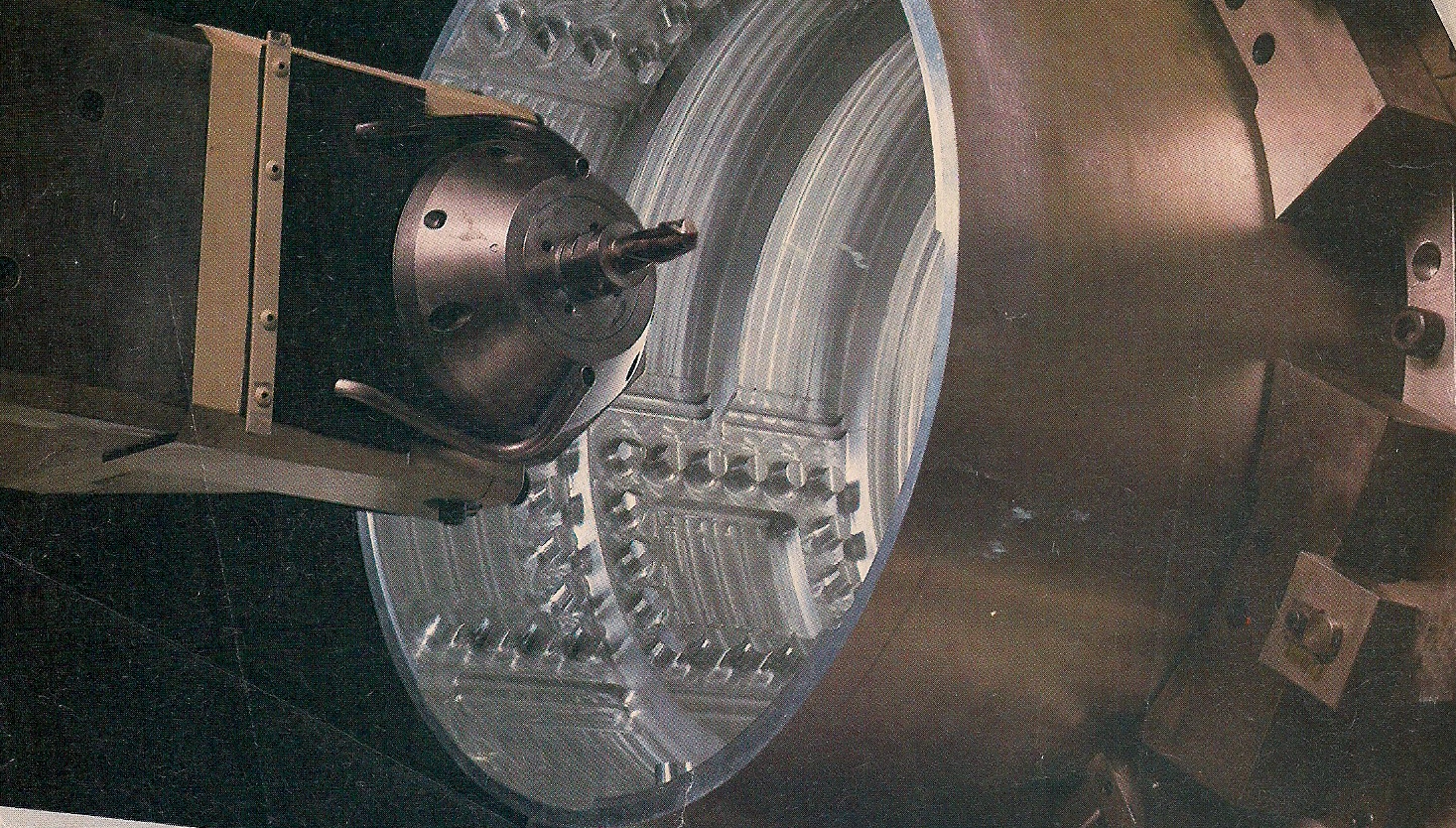

Hi Everyone, I programmed an Onsrud 4axis for a part on the DC-10 original first ships, Yeah somewhere early 70’s. Think this way, the rotary axis designations are A, B, and C. A rotates “about” the Xaxis in the YZ plane. B rotates “about”: the Y axis. We did this with blueprints and punched cards. Graphics as you now know was not invented yet. Here is a picture of 4axis

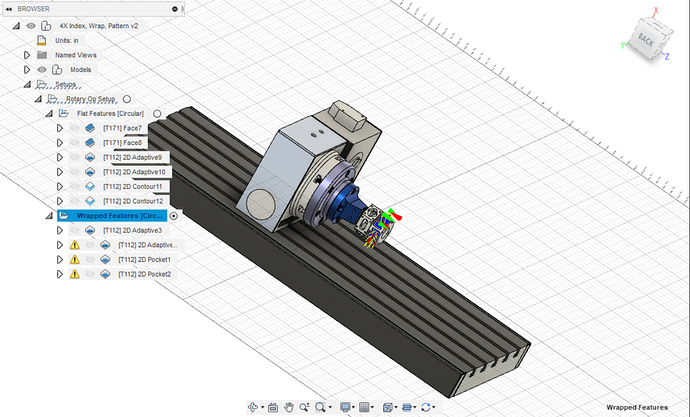

In fusion there are nice examples - in Cam samples 4X Index wrap, Pattern has 3+1 and simultaneous

I made a copy of that 4th axis pattern - here is a share link file - we are trying to build our own workholding similar to the raptor but using Mitee Bite clamps
https://a360.co/3ebvyhC
I forgot all about the samples included in Fusion 360
I learned a whole bunch from that example - my student made a shifter knob 3d machining on our 4th axis using Fusion - pretty impressive
