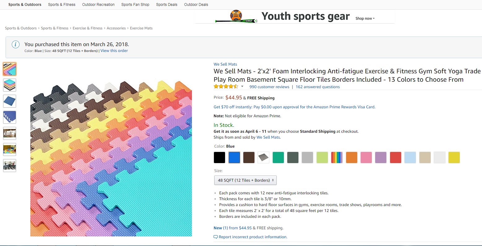

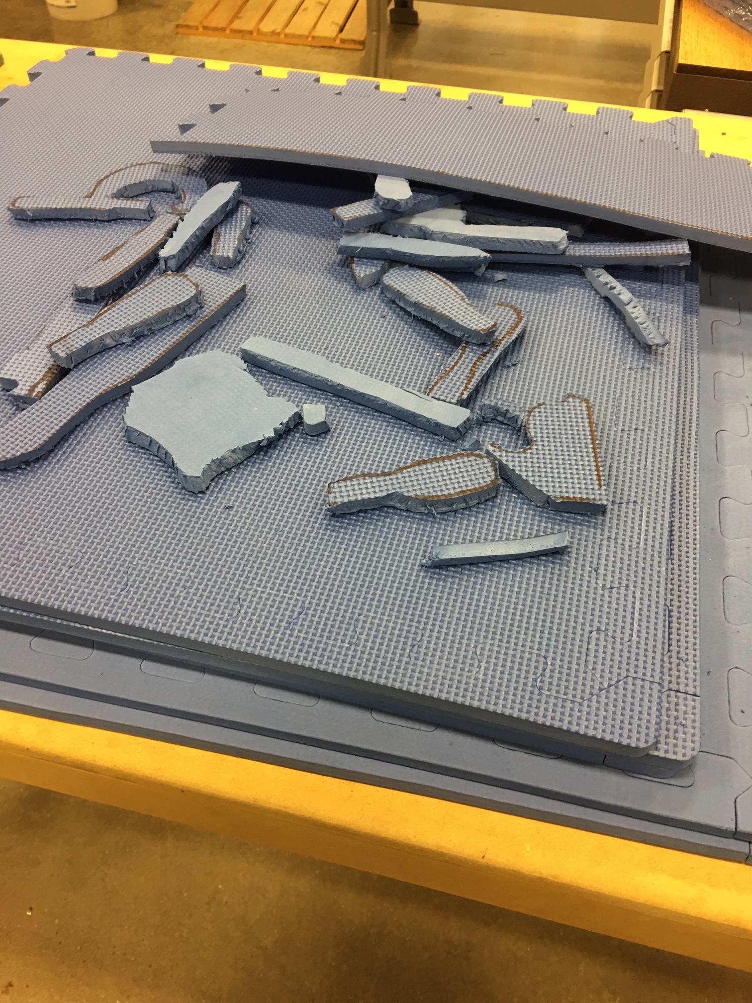

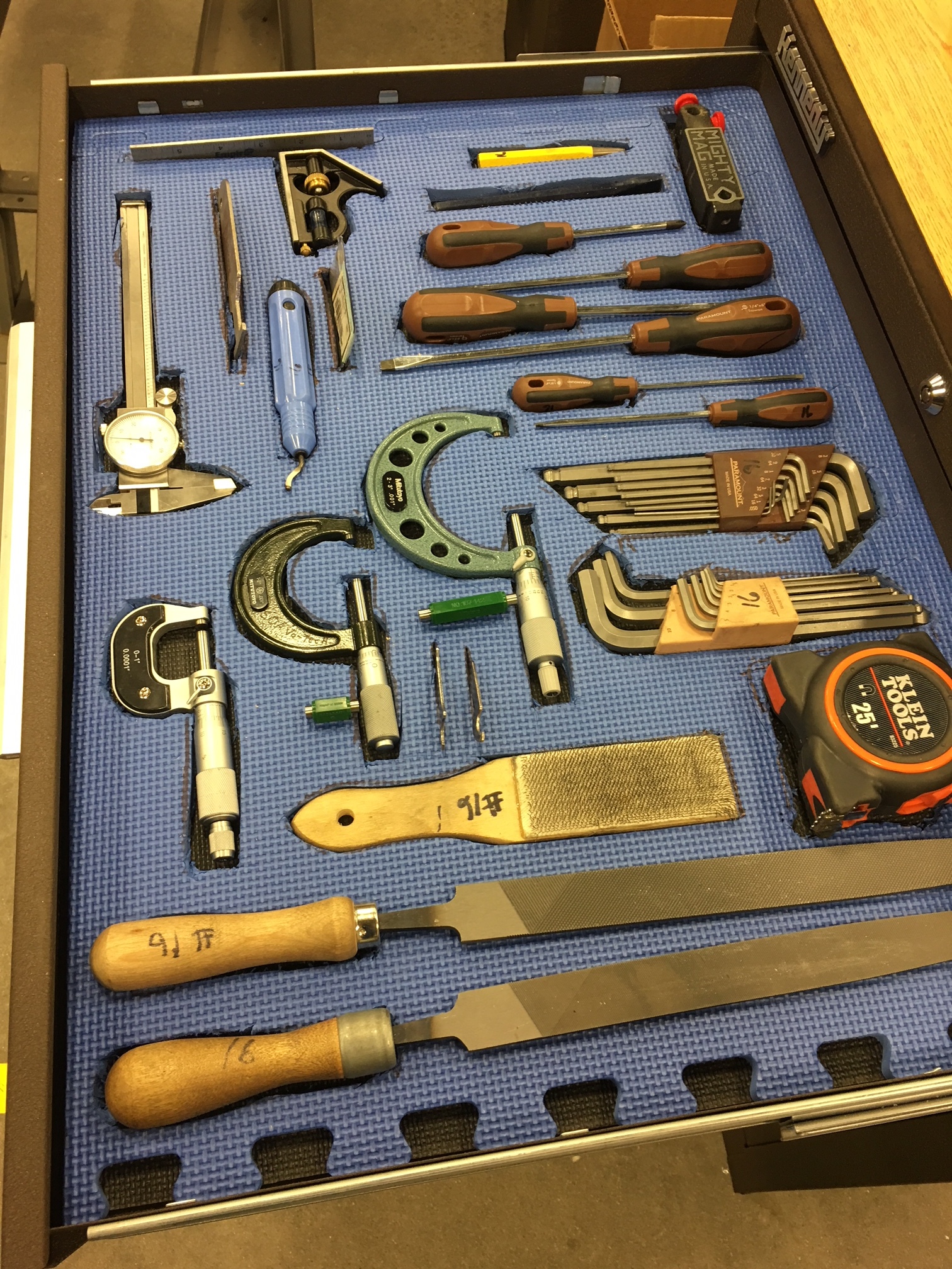

I am always looking for ways to organize my toolboxes (I have sixteen roll around Kennedy toolboxes on the shop floor). They all have the same basic tools, measuring instruments, etc. I have used the Kaizen foam which is great but expensive. Today I got some foam panels in from Amazon and it seems to be well worth the purchase. I bought 12 panels for $48 (that’s only $4 an insert. I cut this out in about 1 hr with one of my students. If anybody has ways to save more money, please add to this topic.
2018-04-02_15h55_06
Information for buying from Amazon

Finished drawer (color blue with a black layer on bottom)

Cutouts and remaining panels

Good job! That is a great idea. I bought a pack of 6 of these for 9.99 the other day, I was going to use them for in the garden, but I will head back and pick up another pack for doing this with - thanks for sharing.

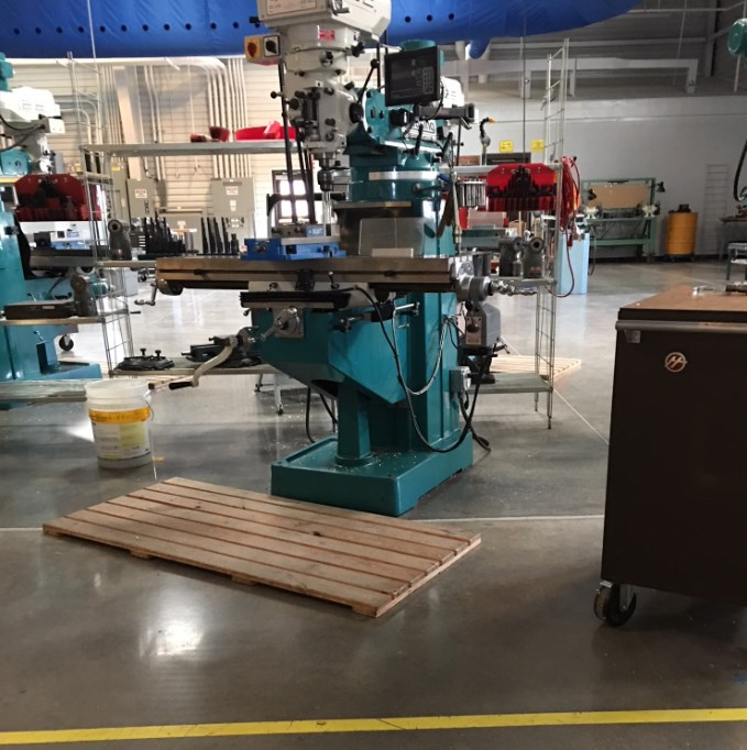

I had my construction trade program make some wood mats for each machine. Very durable, great on the legs, easy to clean.
interesting! I imagine they work well with chips and coolant too, and can be moved easily enough - thanks again for sharing
