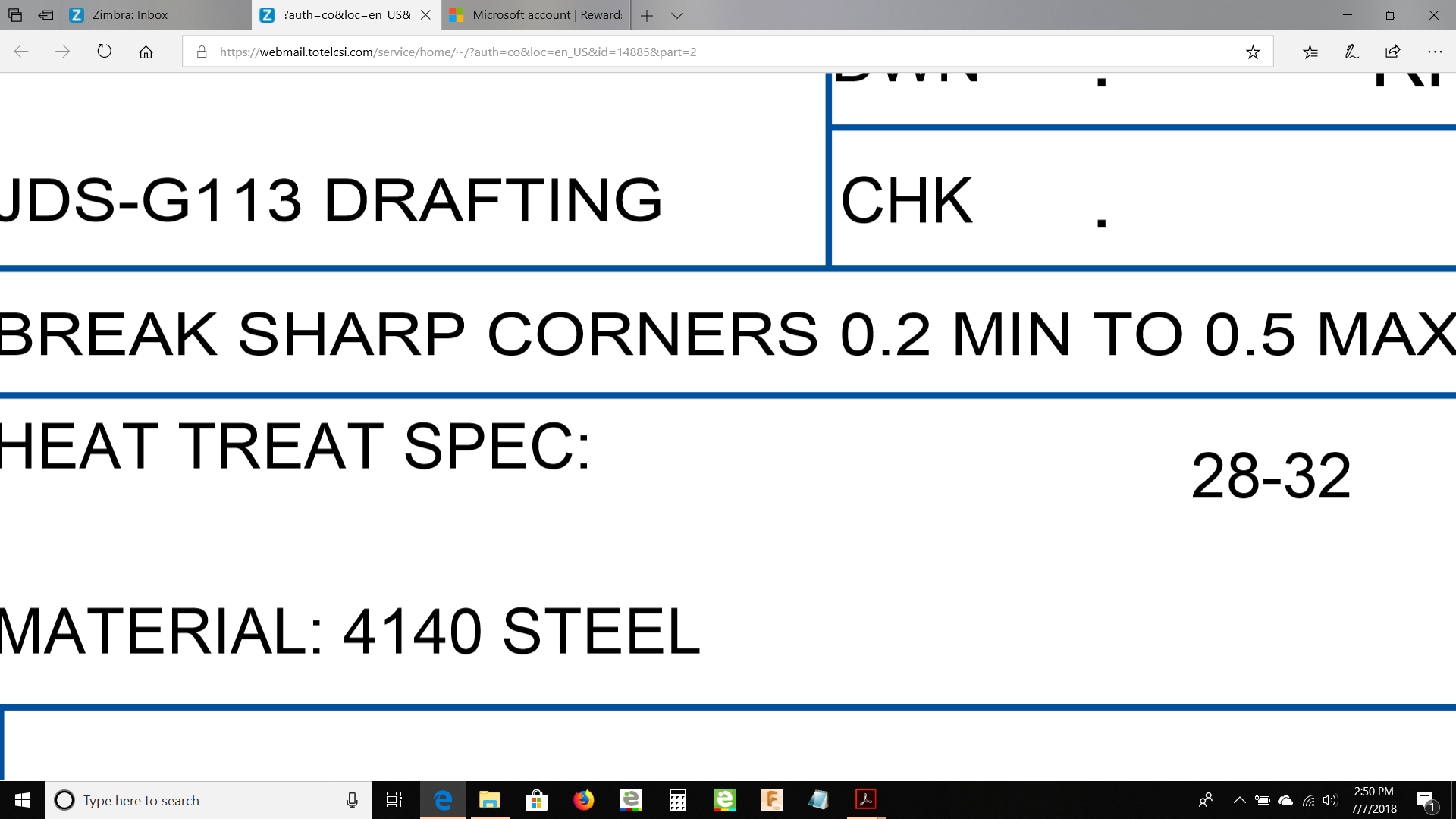

For the mill-based Building Block drawings, there is a general note on each sheet to break all edges to .01 chamfer.
Note
When I see the word ALL used that means every edge on every face in my book.
Top, bottom, left, right, front, back and also on any created features
Is that correct or should it not be taken so literally?
Thanks
Yes, unless edges are noted otherwise. Look at the model.
Thank you for the info
Screenshot%20(105)
This note comes on most prints in the tolerance block.
