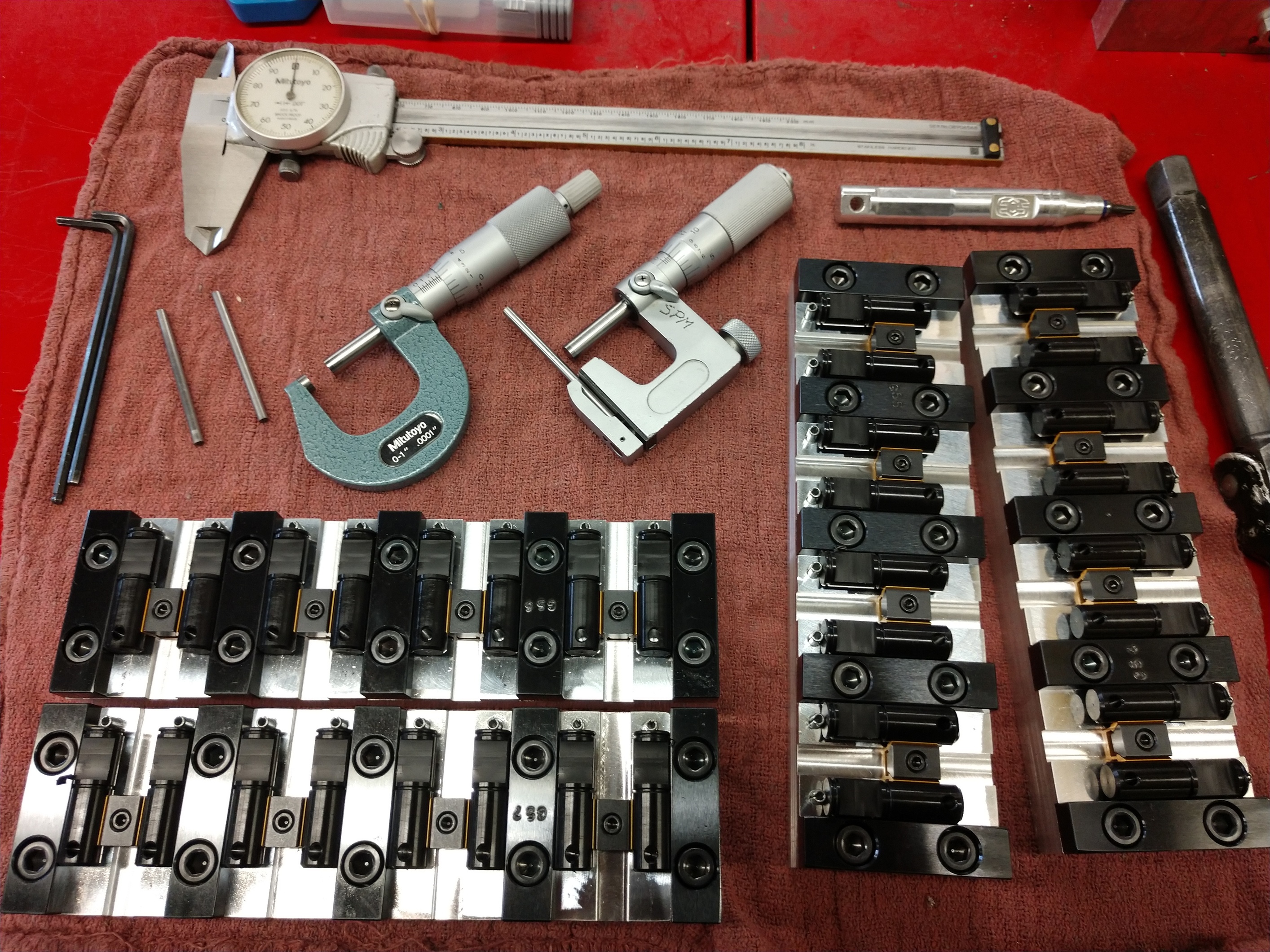

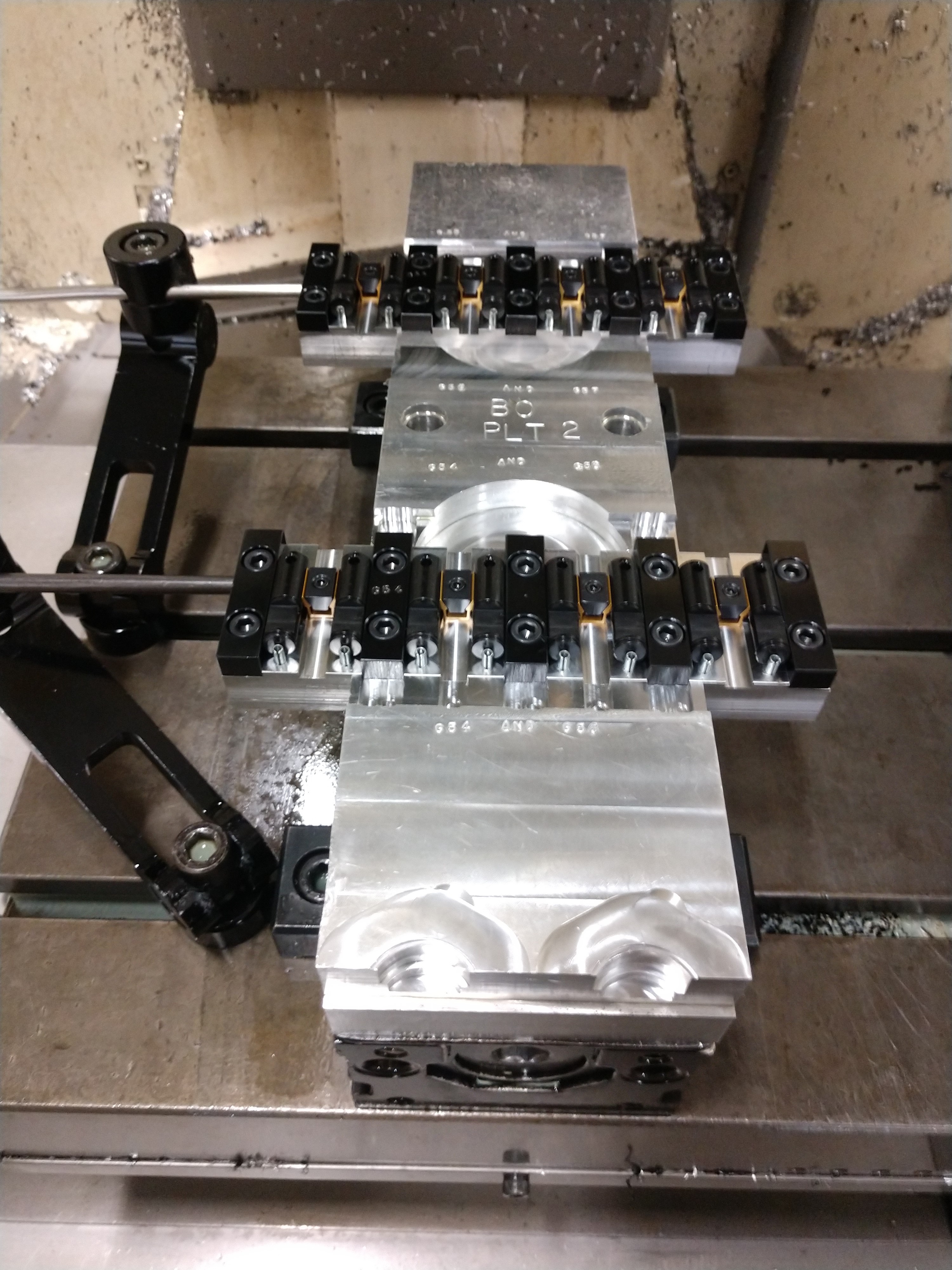

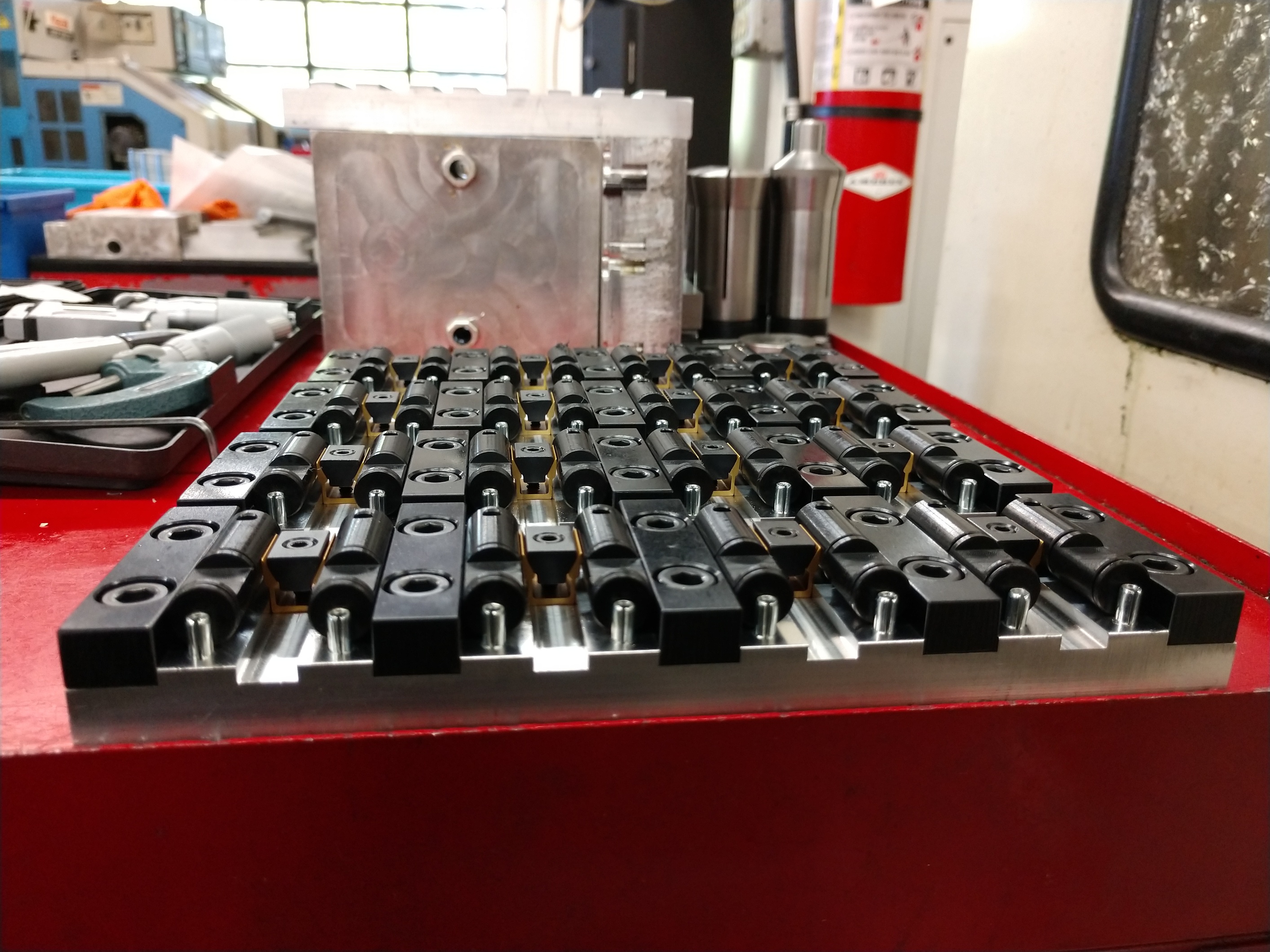

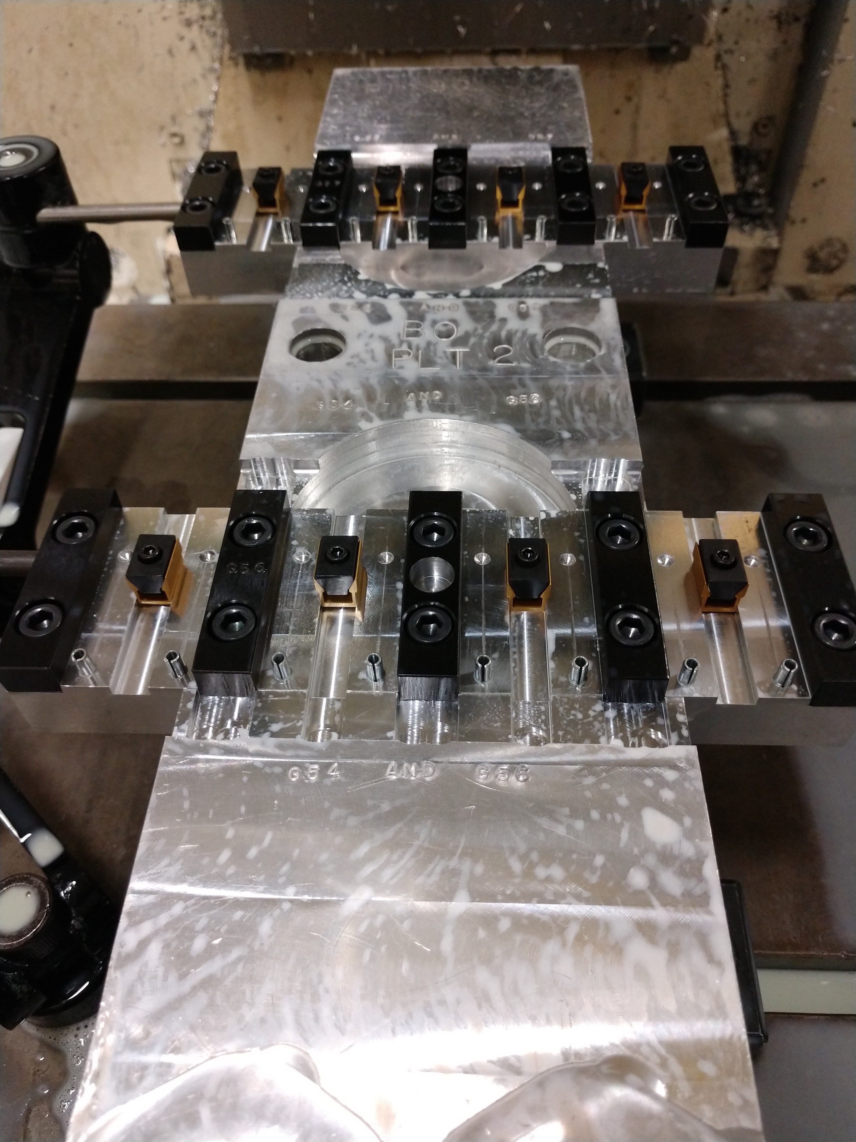

@AndrewGiles Sorry, late to the party on this topic, but just wanted to let you know that making pallets to run in vises as @DavidGauthier suggested, works really well, as you can see in the pics. After I was finished with the initial setup of these, I drilled a hole in the center stops to use a co-axial indicator to quickly dial these in next time they are ran for a quicker setup.

Thanks! I don’t remember how much time savings it was, but it was significant! I believe that it was around 2.5 as many parts per hour compared to how they were doing it before.
