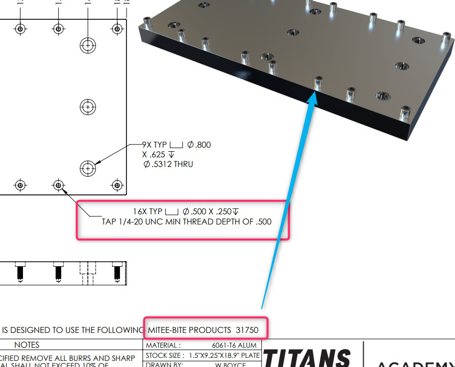

Can someone explain how the fixtures are held to the sub plate? I am looking at the drawings and having a big mental block as to how these things are going to be held together. Are the dowels in the sub plate hollow? Do screws go through the dowel and into the sub plate? Or is there a way to hold everything using the Mitee Bite products? (sorry, I am new to those)
We are planning on building a plate that covers the entire VF1 table and incorporates the fixture series as well as tapped holes to hold our vises down for the Building Block series.
Xpansion Pin https://www.miteebite.com/?s=31750
Thanks! I saw that on their web page a little after posting in the forum. I never used anything like that!

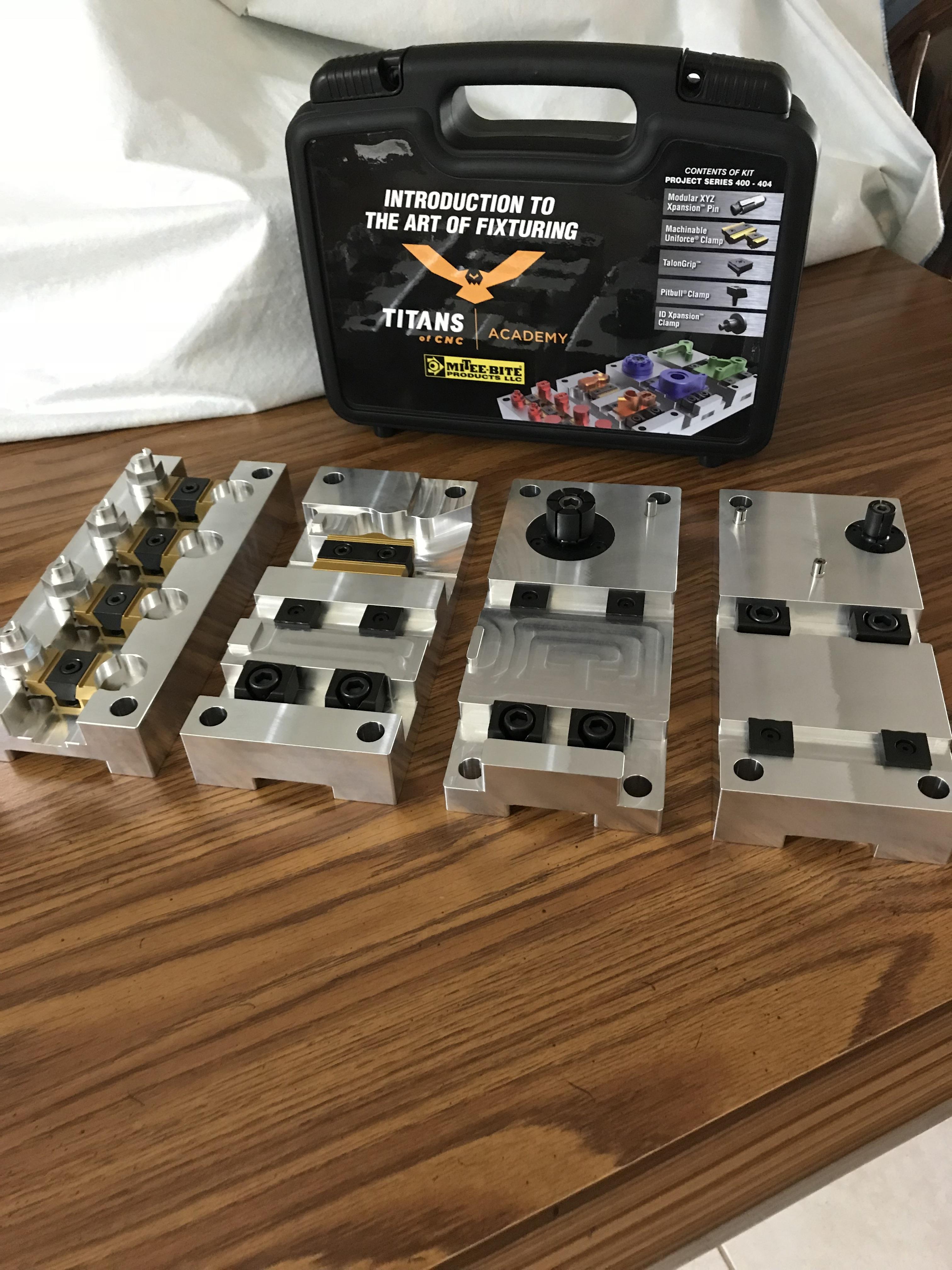

Check out the mitee bite kit for the fixturing series
https://www.miteebite.com/news/titans-of-cnc-academy-kits-now-available/
IMG_6400
Woo Hoo!! Sweet!! Mine should be arriving any day now?
