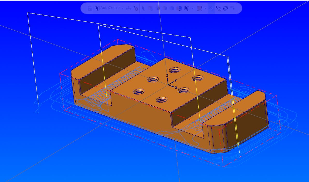

I was on FB and was inquiring what is the equivalent of 2d Adaptive roughing in MasterCam or others.

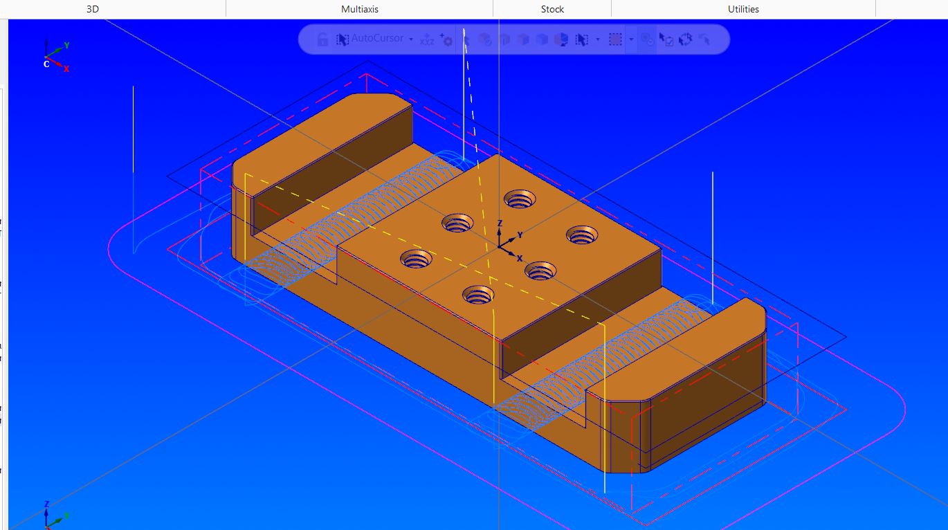

Something simple that doesn’t require as many key strokes - there is not from what I tried. I got suggestions - but just about all required 3x the amount of work - We were finally able to use a 3d Opti rough in a 2d scenario but you had to have all settings correct - - we used 2d dynamic milling but needed at least 2 selections - draw a containment ( for stock - it doesn’t identify stock) and many selections.
peel%20and%202d%20dynamic%20
Optirough3

on the job I don’t get to choose the software - so we all make it work. Its easier to learn another software if you already know one. I was just fascinated by 2d adaptive and thought - how do the other companies do it. I was able to eventually get good process in Mastercam with 2 different methods. If I plan on teaching Mastercam after they learn Fusion I wanted to show how to do it that aligned with what they already knew. Mastercam does have some more power with selections but I also think thats where it becomes harder to learn - Like its a secret how to use it well.

I think I was just beat up on FB Cad/Cam forum from this post - I see at last count 111 visits - so It must be an interesting discussion. I had a MasterCam user who is a fellow instructor from NC and we worked on how to use MasterCam in a similar way - then Al from Bobcad showed how they do it - Fusion was still the easiest by far. I did make a mistake and say that its was 2d adaptive when it was 3d adaptive
