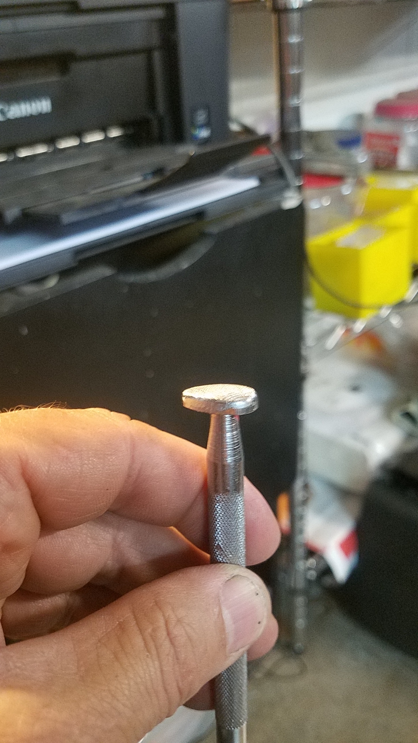

Thank you for allowing me onthe forum . Just got Fusion 360 after spendinh 6 months with BobCad to no avail. Here is the problem. we got Bobcad for a Haas TM-1 in order to make leather stamping tools but Bob Cad is unable to do it. A leather stamp with a tear drop shape and a very slight curvature over the whole thing. maybe a raise of .060. Can someone here tell me where to start or give me a lead as to who could do some programming for us.

David20180828_120622
are you trying to cut the top semi circle shape
Yes essentially we need teh mill to cut the periphery then sculpt the top . We have many different sizes i.e length and width. At present we cut them by hand and eye. So yes. I was trying to use a cube and manipulate it.
Do you have a drawing or a cad file of the part. I use Inventor but can write you a program. I can send you the full program with setup toolpaths and walk you through how I done it. Just out of curiosity where are you located at.
No sir. I am trying to lern to do teh designing in cad, now fusion 360 . We had BobCad but they have proven to be less than reputable in that they cant even design the tool themselves in their program I can send pictures . I did design it in meshcam trial but then I could not design a.

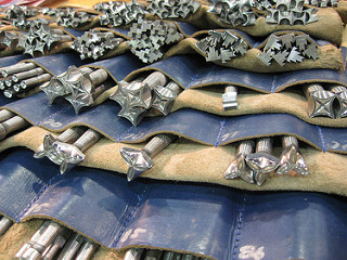

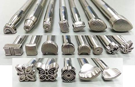

Here are some pictures of tool styles we make2911578444_ce429a804d_n . These are from another maker. Most are geometrics but many have compound curves on top. that have to be sculpted. The simple answer would be for us to do all but the actual sculpting of the curvature by hand.
Is this a better image of the teardrop tool you are wanting? top tool on right is a tear drop.
leather%20stamps%2011
These can defiantly be programmed with no issues. If you can shoot me an email with all the information on the part dimensions. Also let me know what machine you are using and the specs on it too please.
