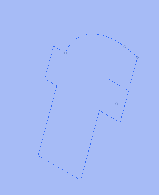

@Billy-Boyce I have downloaded the 2 files needed for the 200M and I am experiencing a problem with the TitansOfCNC file. I downloaded them as DXF files and used them. I encountered a problem when you go to extrude cut the surface. The f in of is not closed and acts like its the entire surface. I redownloaded them several times and I am having the same problem. Here is a pic. Is the file broken?FProblem
Thanks, Brian
This would be an option; download the model and then save as a dxf file. Obviously the “f” is good on the model, you should be able to get a good dxf from it… If not, then create a line and a arc to complete the dxf.
My tired brain suggested that late last night but then put it on the back burner and went to sleep. I tried it this morning and it worked. Thanks
