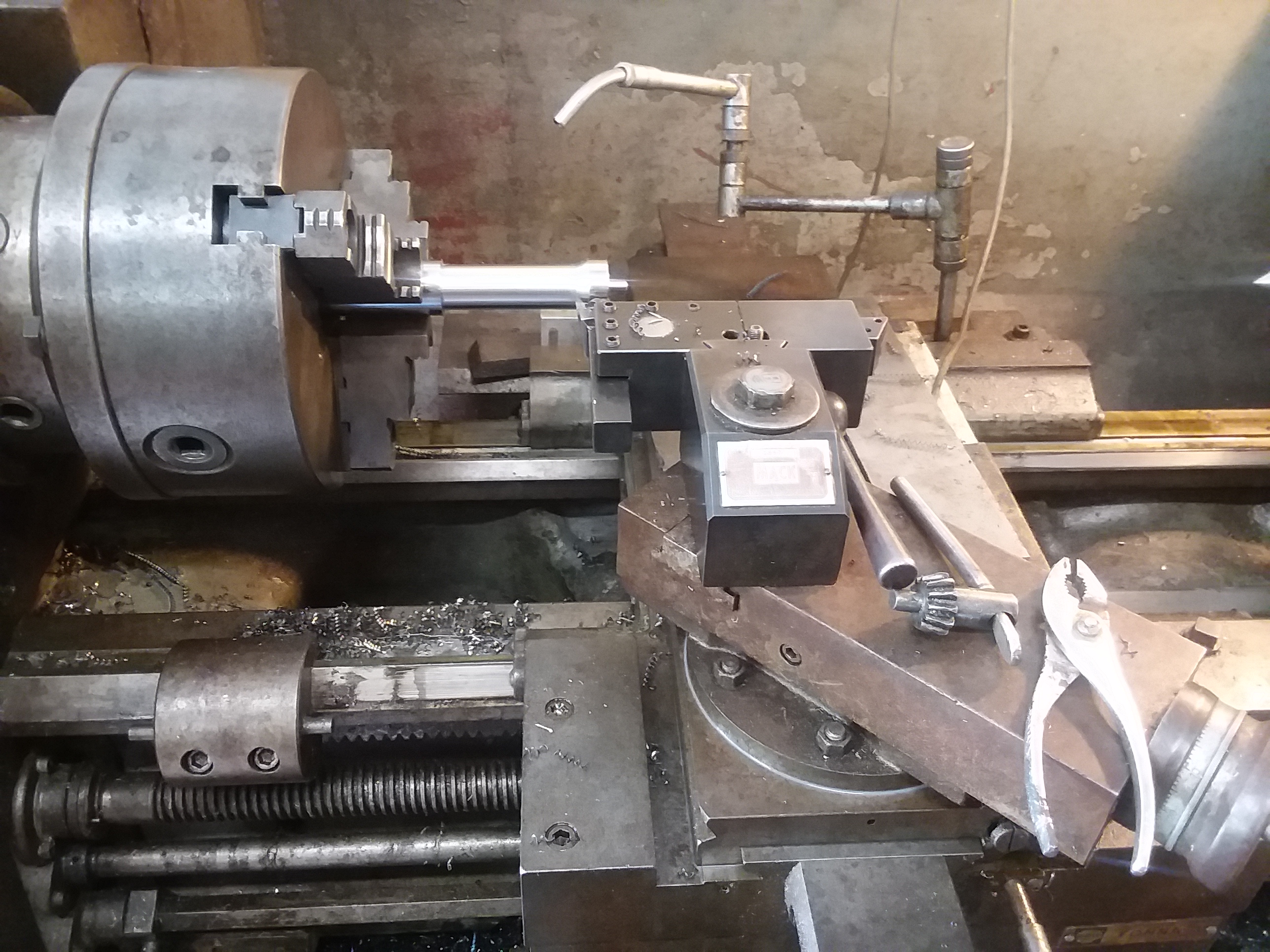

Gotta love a paid off dinosaur that keeps making chips!
Hey I resemble that remark in more than one matter! LOL but I wouldn’t consider myself an old dinosaur20180807_124335
