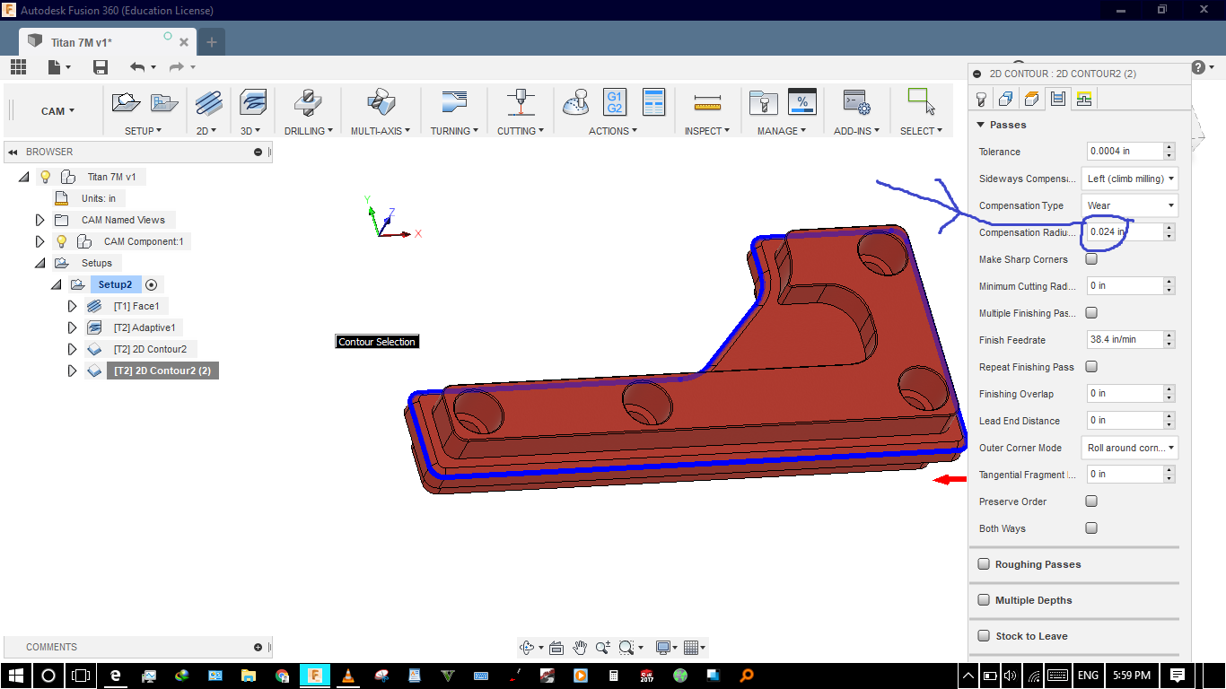

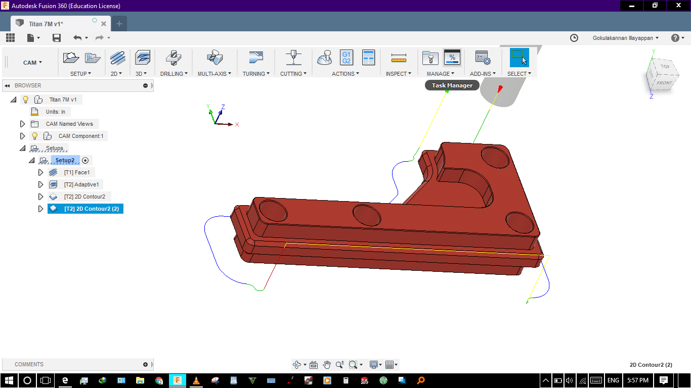

I’m practicing Titan 7m cam and I could not understand this issue. While finishing the outside with 1/2" end mill, fusion ignores some contour and the toolpath was incomplete.
forum%207m
but when I altered compensation radius from 0.025 to 0.024, I got the desired toolpath.
forum%207m%20b
I’m wondering why fusion ignored the toolpath previously.
Thanks.

Update: I found the issue. I failed to uncheck stock contour in Geometry tab.
It ignored the toolpath because comp. radius (.025) was outside the stock contour. Now with stock contours unchecked, tool is free to all sides without machining boundaries.
