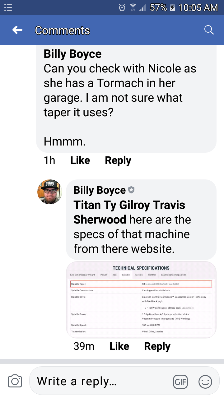

Looks like from what I see you have a R8 spindle you might want to verify that as a finding Ann Arbor with a 1-inch diameter Shank I’ll have to look into that a little more for you it’s probably not very common you may have to resort to eBay I’m by one from there. How old is some more looking and now I’m at work but I got some feedback that may help. TTFN
It is an R8 Spindle. Thanks for all the help @CoryLewis @Rumpelstiltskin

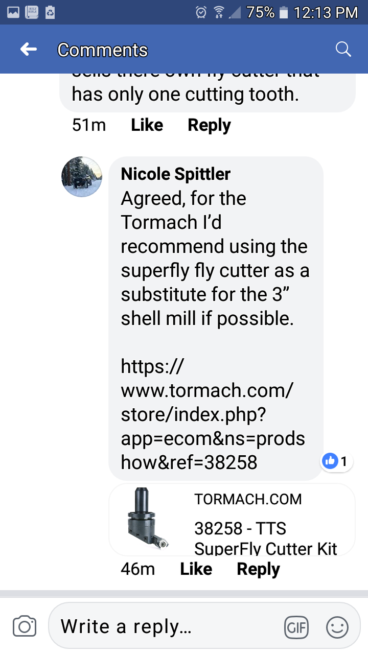

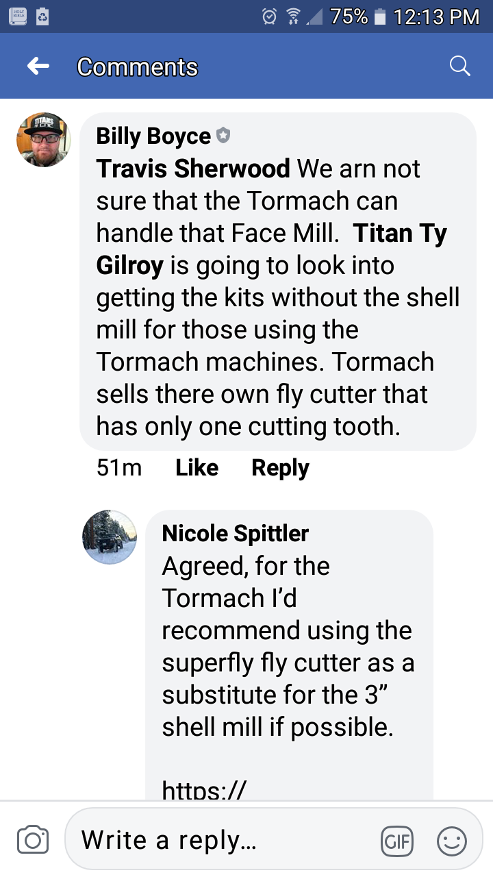

@GaryPotter it looks like there’s a little more information for you. That particular machine most likely cannot handle that size of a face mask that’s the chatter I’m getting from the post I made on the Facebook group. Here’s a couple of screenshots of how the post is going. You might reach out to Titan to see what he can do to help you. He’s a very approachable individual and he’s happy to help us out.
Hear is an Arbor on eBay. You can us the 3" face mill on your machine. BUT BE CAREFUL YOUR MILL HAS LOW HORSEPOWER SO YOU CAN NOT TAKE HEAVY CUTS

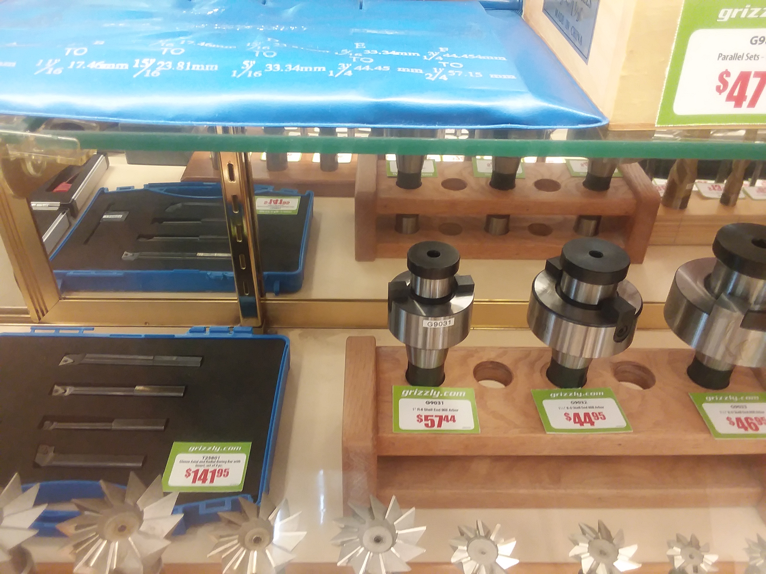

At Grizzly industrial today they have an adaptor R8-1"
