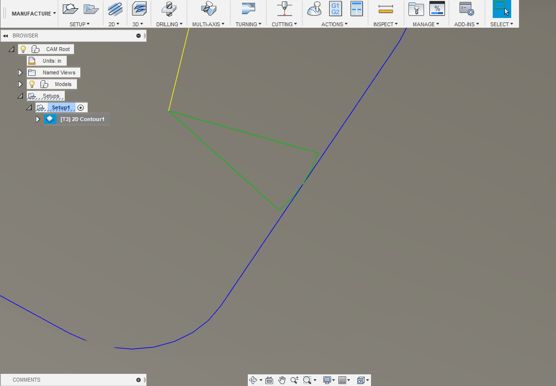

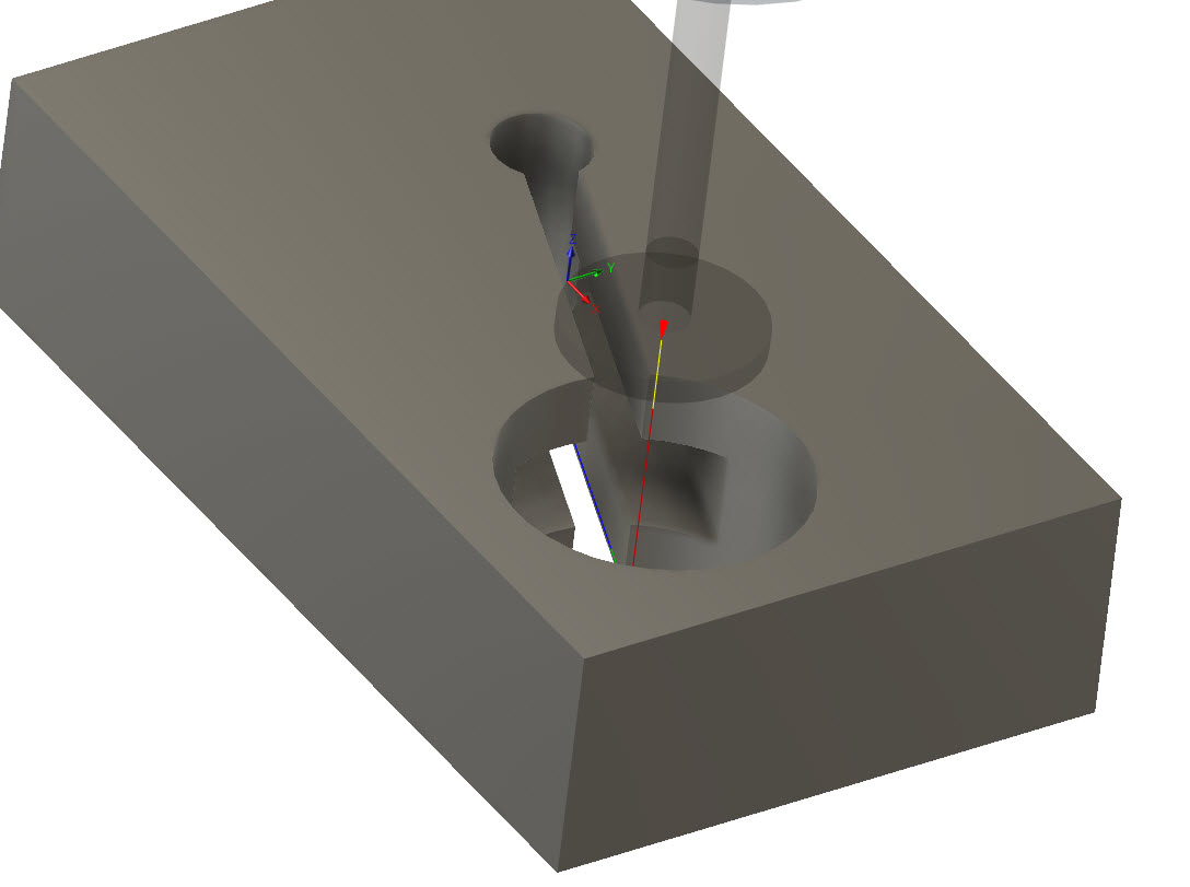

Undercutting in Fusion- Need to retract lead out back to lead in
I need this cutter to make the cut and then reverse back to the lead in position to retract out of the part.
In theory, if I use a negative linear lead out distance it would work but fusion doesn’t allow negative linear lead out distance. this is a 2D contour tool-path. Any suggestions would be appreciated. Thanksunder

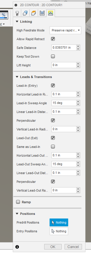

I had this issue a while back and i had to play with the lead in & lead out as separate. I had to fine tune my Lead Out a bit. Have you trying using the Keep Tool Down- Checked and picking an Entry point like Center of that hole.

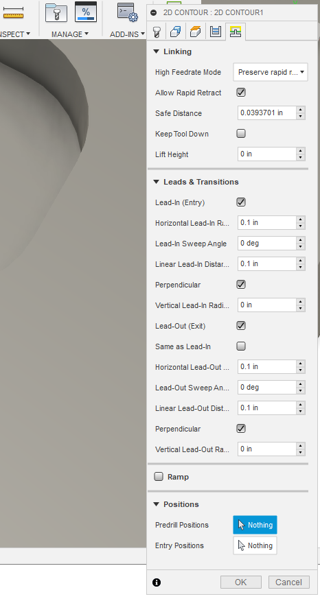

Not exactly sure what you are trying to accomplish… I did this and my tool started and ended in same path on the lead in and lead out.

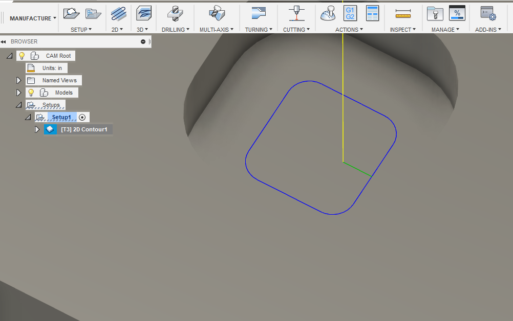

Here is the toolpath
I would want a slight radii lead in, so this should work also. the tool returns where it originally plunged.

That was my 1st explanation just better with pictures haha. I know sometimes you have to watch it in simulation to verify the Lead Out is in fact coming back to that point.
